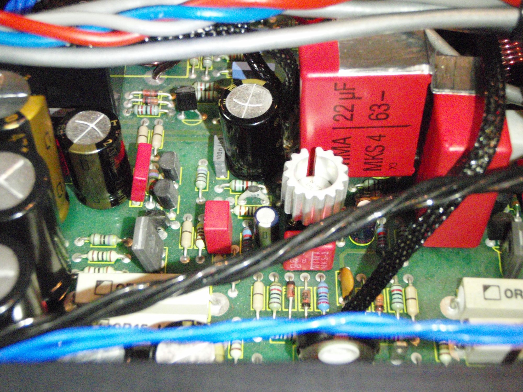

oh...now I see the point, just wanted to confirm that these 22uf Jamicon axials (pic of mine before the mods) about which I asked you some time ago (had some doubts as my tester didn't show any voltage on them at all) were replaced with 22uf film caps in your Restek.
so i'll try to get these WIMAs you recommend. Meanwhile, do you really think that 4 of them could somehow improve the overall sound of our amps? Any testing made? 🙄

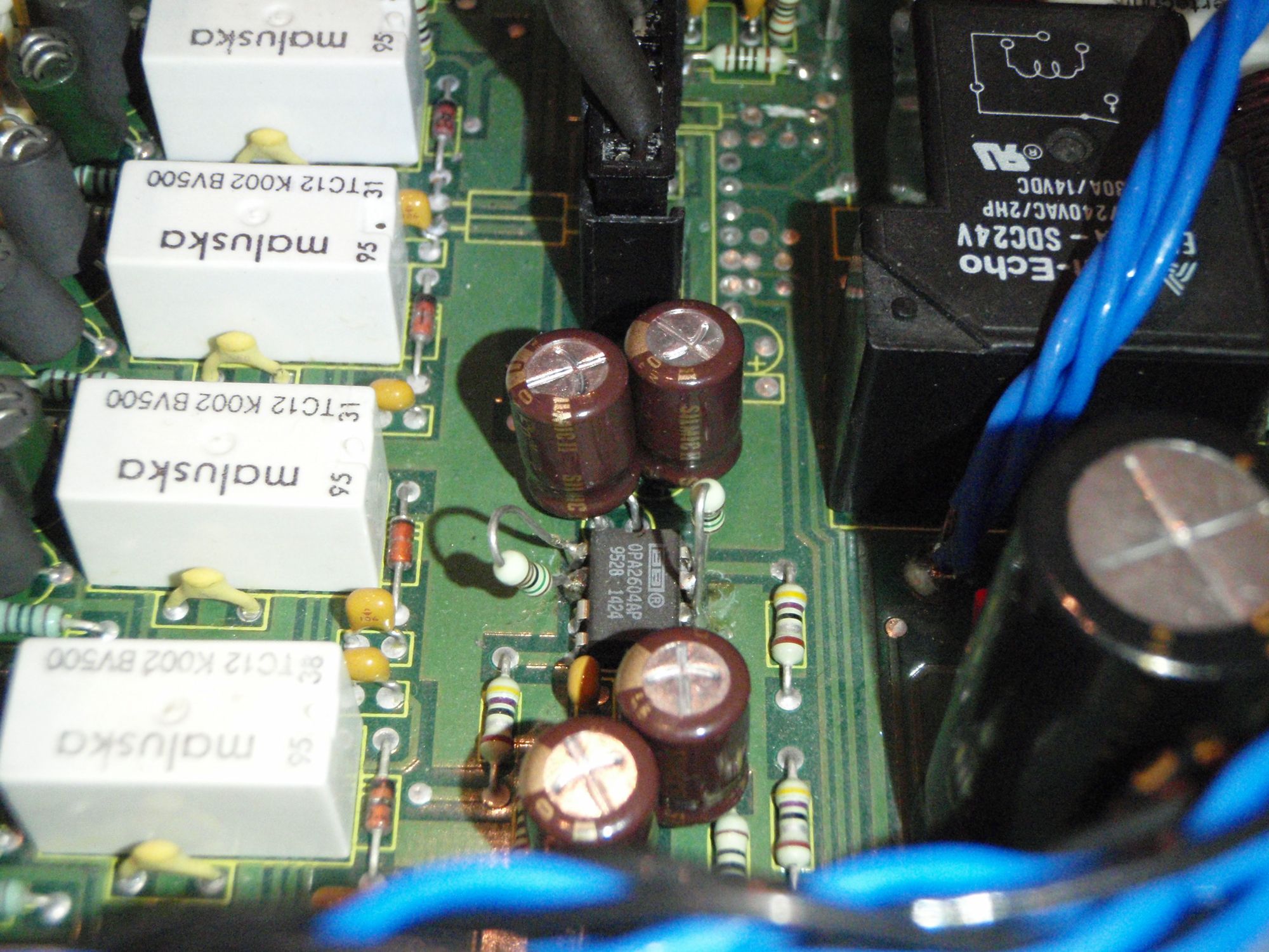

I have finally received the caps and going to change every single cap in the amp 🙂
I was wondering is there any point changing 1uf cap (two of them) near LME49710HA to 2x0.47uf Wima MKP or MKS?

Are you talking about the elco in the diagram CEL54 1uF/100v or C7 1uF in the feedback circuit? I'd try a polystryrene cap for C7 and poss a better elco the other one!
yeep, I was talking about CEL54 1uF/100v. Already replaced it with Panasonic FC, but now have some doubts 🙂

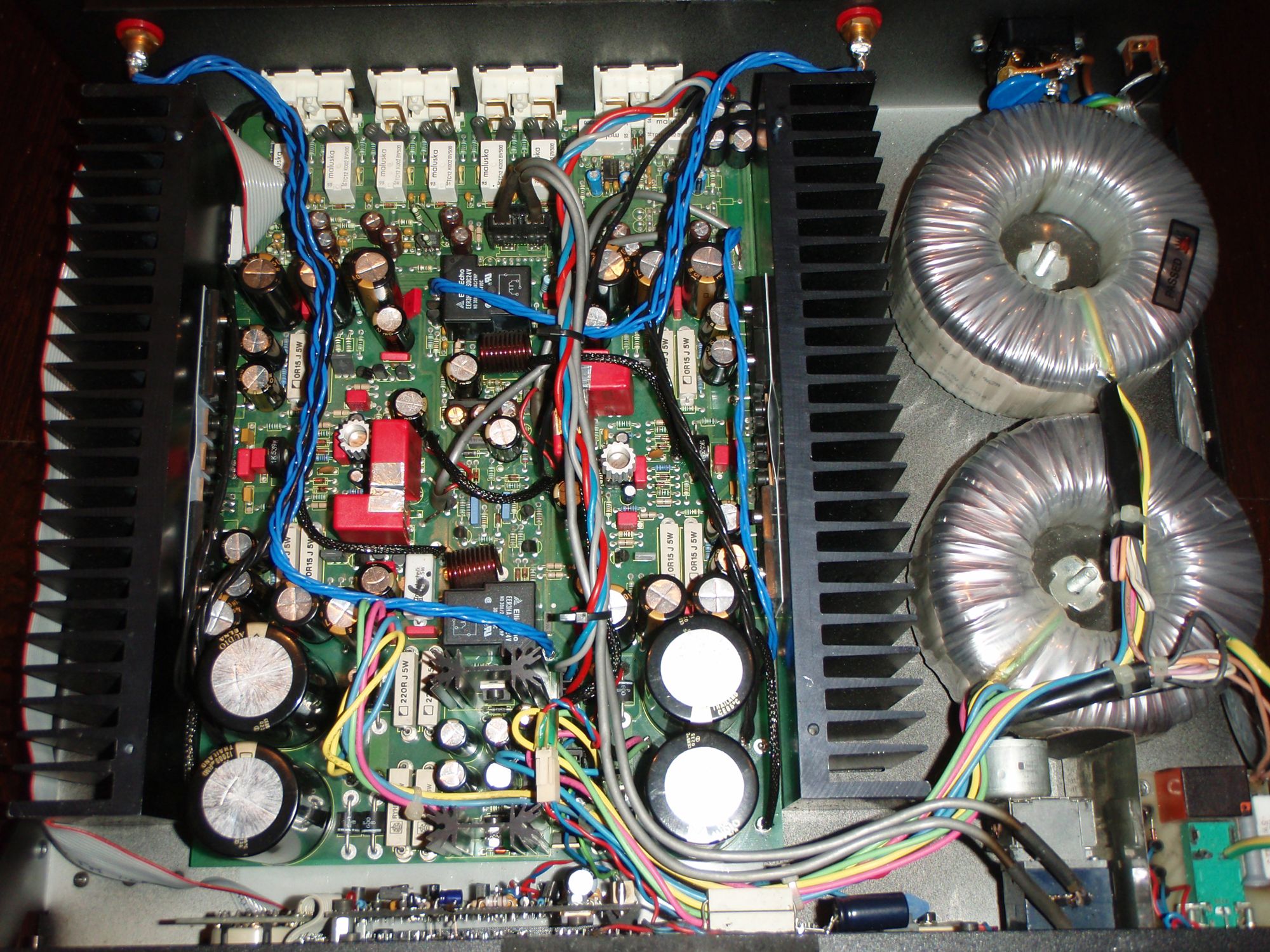

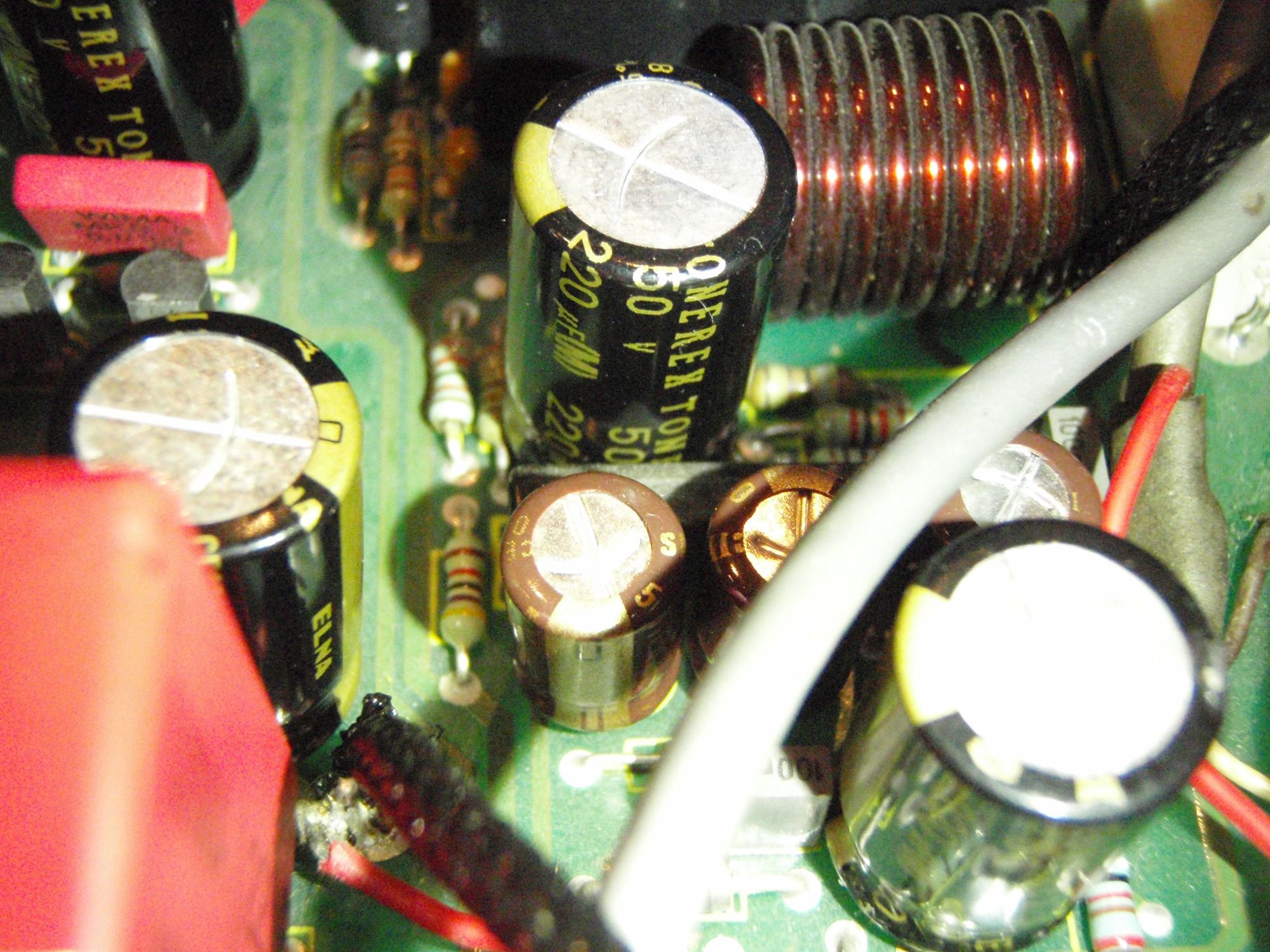

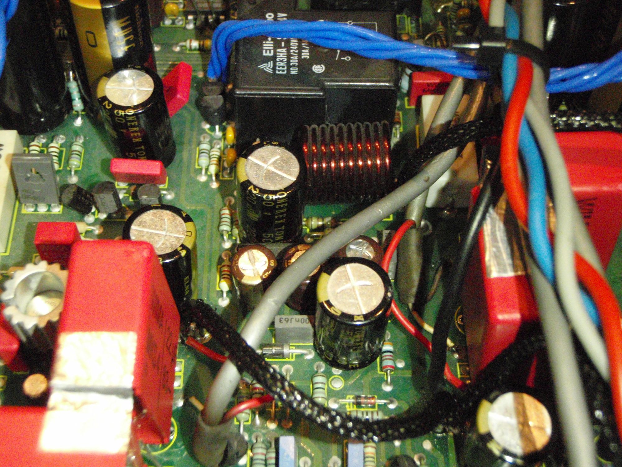

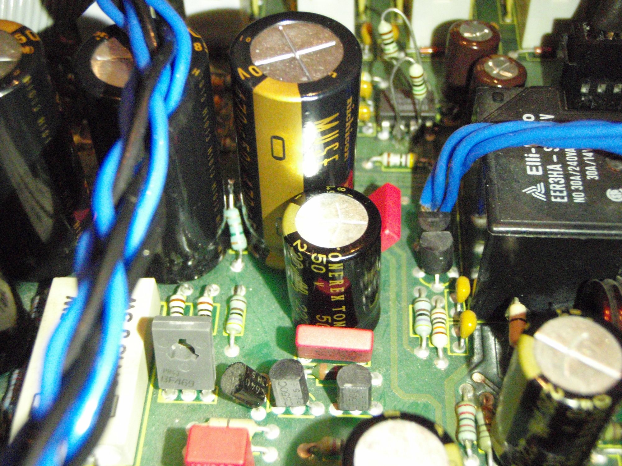

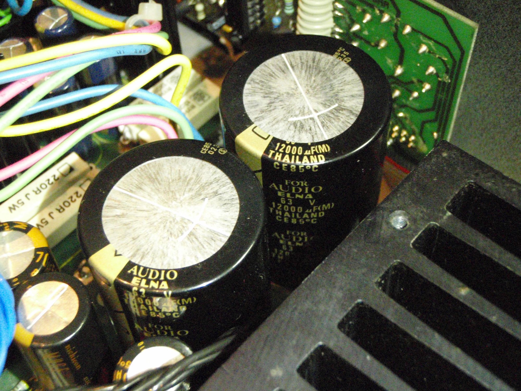

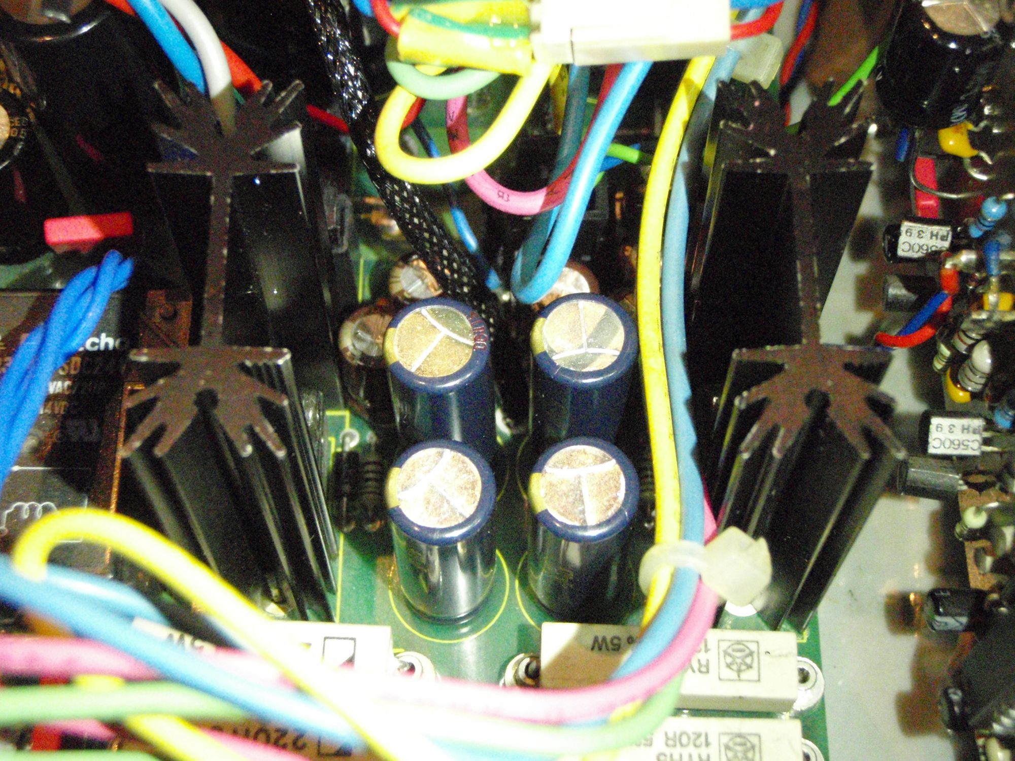

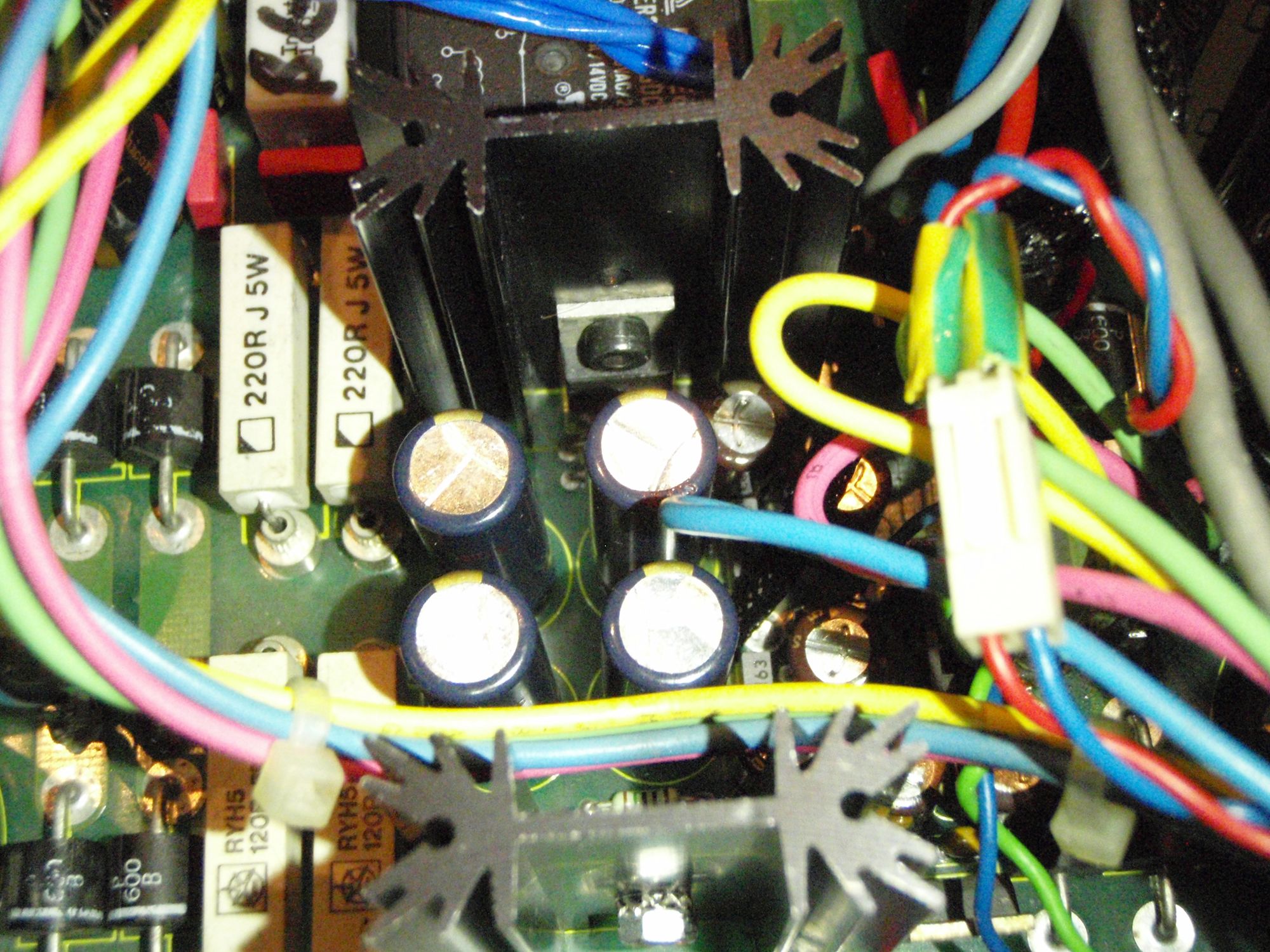

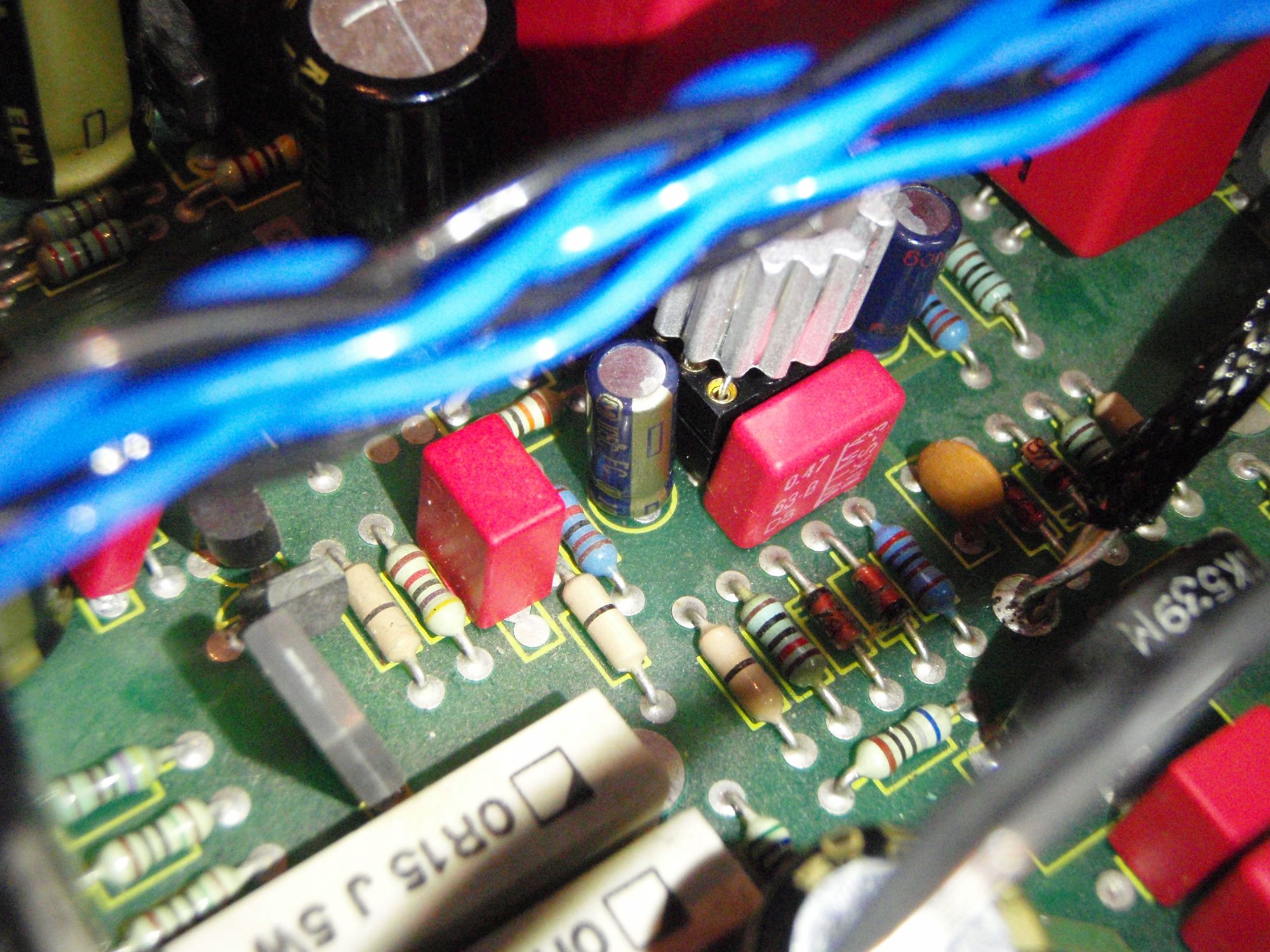

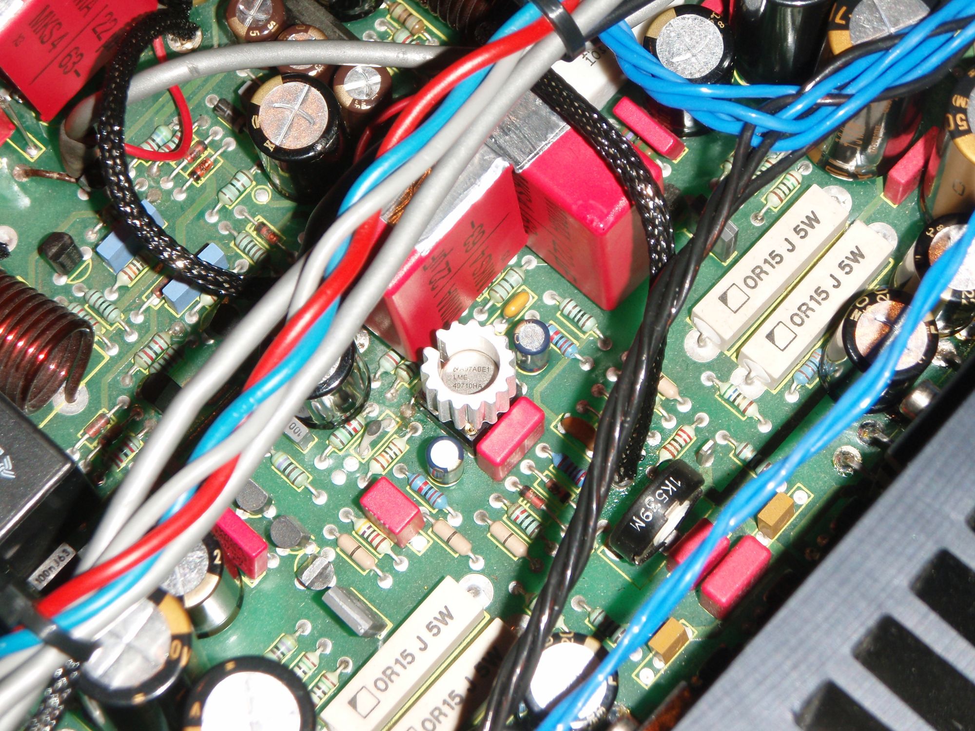

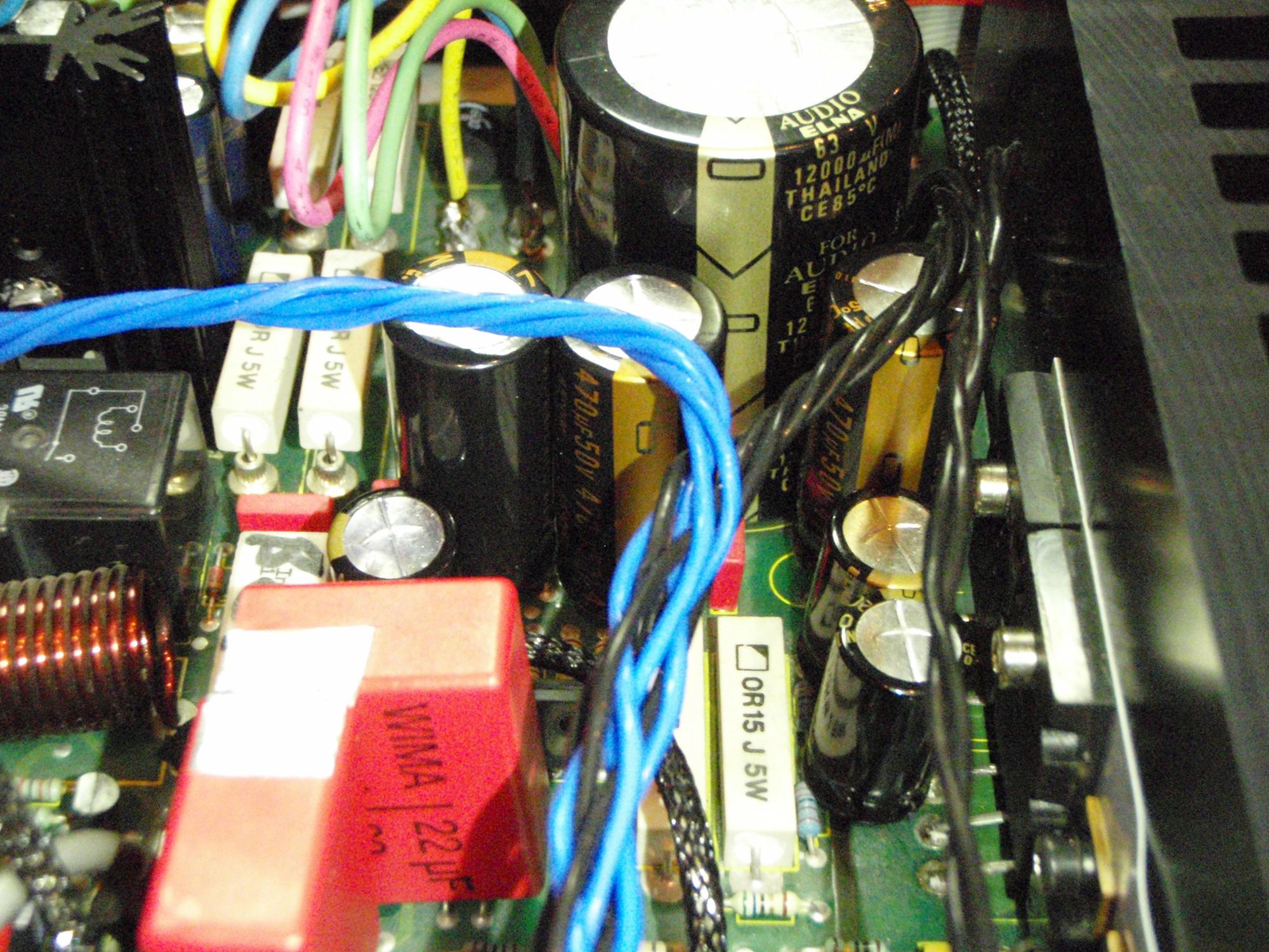

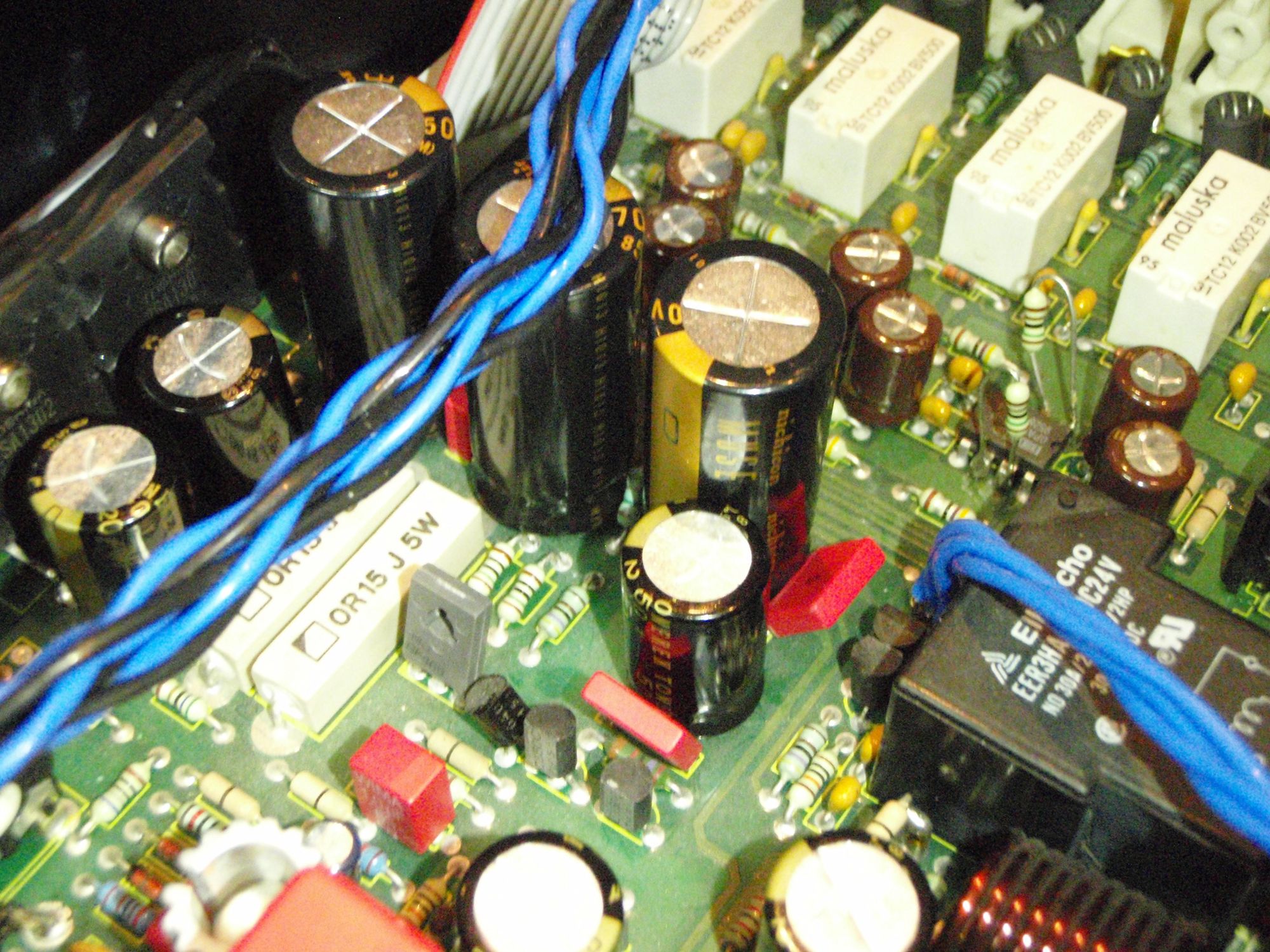

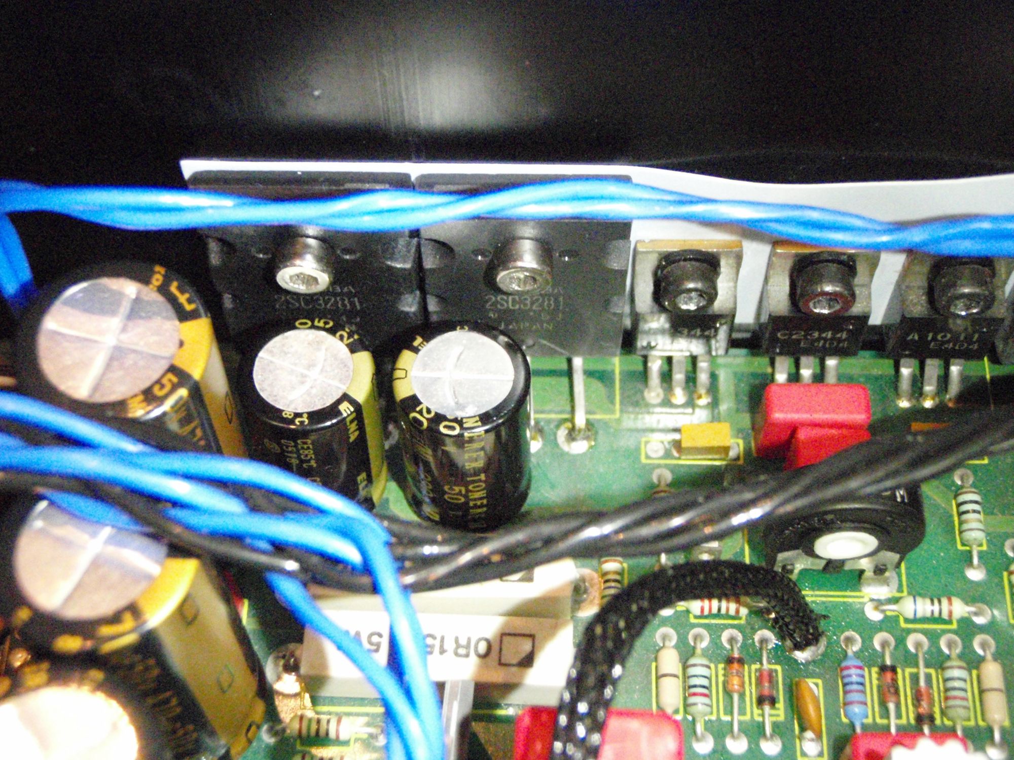

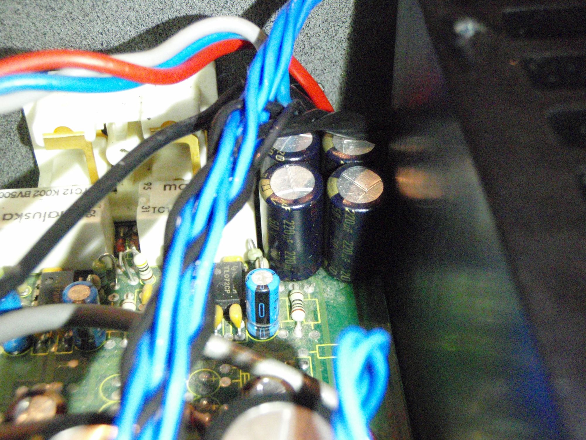

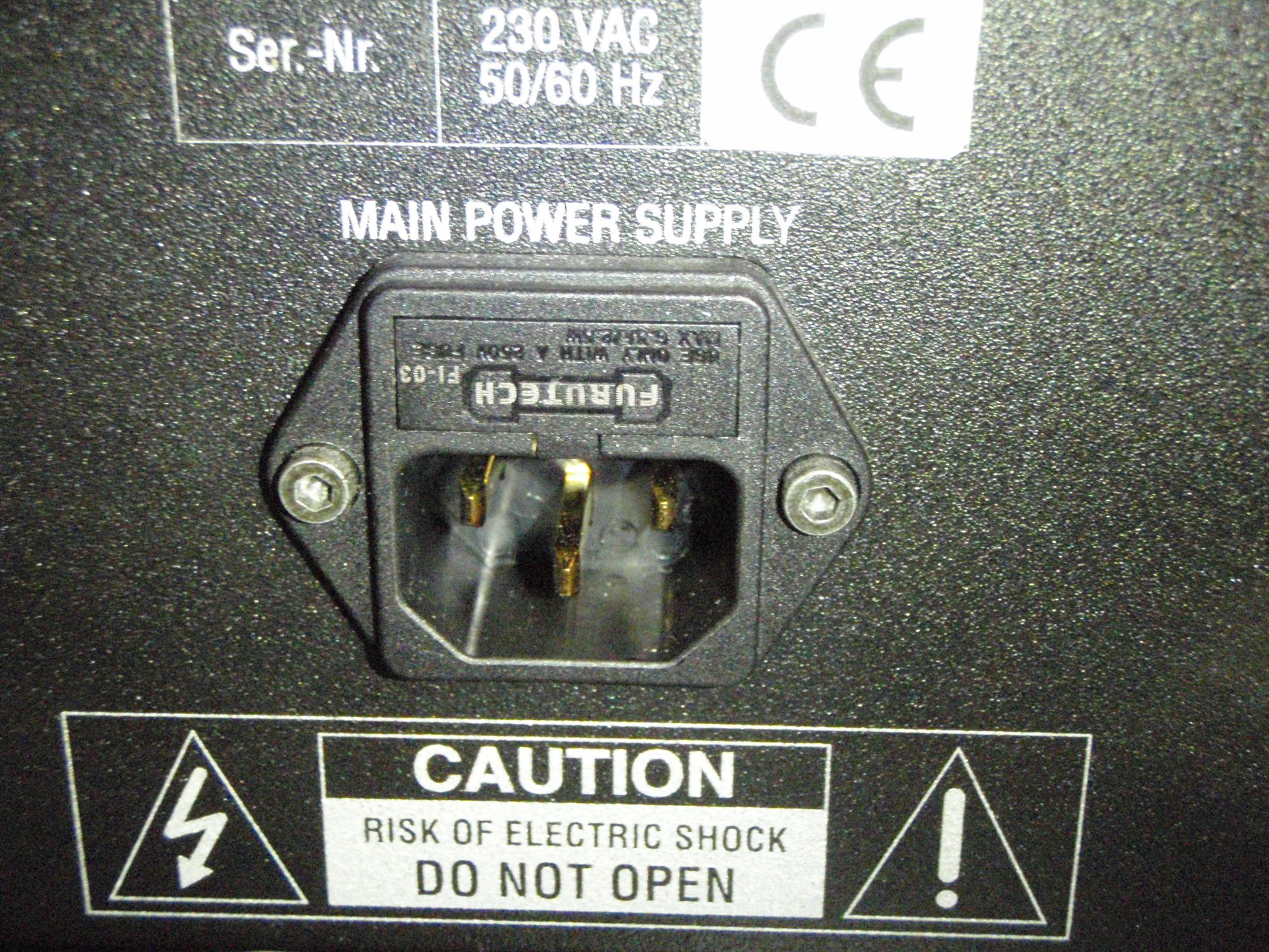

finally finished amp's upgrade 🙂
here is a brief description:
- 4x Elna for Audio 12 000uf in psu
- Panasonic FCs 470 & 220uf in psu
- Nichicon Muse 12x 470uf in output cascade
- opams changed to LME49710HA (thanks Ian, they r great!)
- Elna Tonerex 220uf in power amp section
- Wima MKS 22uf caps between pre and power sections
amp became very brutal and punchy with huge reserve of energy and dynamics, exactly what I wanted for heavy metal music

Nice pics! Glad its all come together. As you now hear, its massively well worth it!!!
I notice you are still using the BB2604 in the preamp stage across the back. Have you considered using anything else? I originally used 3 LME49720HA's but ended up opting for a pair of Bursons and removed one of the buffer stages. I guess thats one for a rainy day!!!

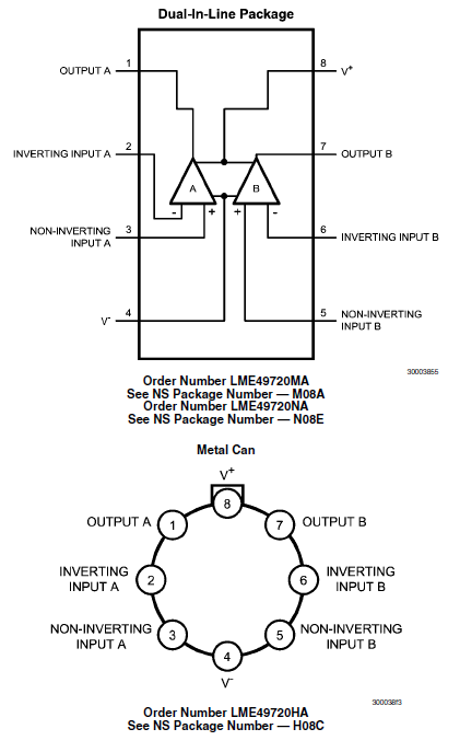

just have received 3 LME49720HA, haven't tried them in the amp's pre stage yet, but did some tests with my heavily moded Philips Cd350 by replacing LM4562NA with metal 20HAs (signal goes directly to RCA via Mundorf 4.7yf mkp cap). Opams have dedicated power supply using LM317 and 337 and toroidal transformer.
the difference was so huge that I didn't believe that I'm listening to 25 year old CD player, in a few words - great dynamics and stage resolution. Then placed back LM4562NA and it was a bit even boring to listen.
the only drawback of 20HAs is that I can easily hear some kind of noise/ hum from the tweeter when player is on and volume on my Restek is about 9 o'clock (quite loud but I got used to listen music at this volume). If you touch the metal can of opamp noise become more silent. So my question is could I use dual 20HAs opams in the CD player's output stage at all? Could this be a direct replacement or do I need to install some other parts?

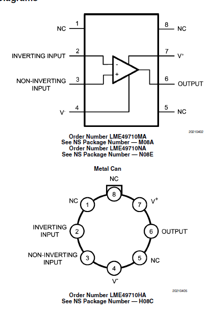

As far as I know LME49710HA is a single opamp, does it mean that using two of them will give the same effect as from one 20HA? If yes, I simply should solder them pin to pin?

Hi, got the email, very poor! I should have replied by now!!!
I will respond to the email, but for now, go for it! 10HA for singles and 20HA for duals. I have used them in CD player output stages, amps in fact everywhere I can! My only preference above these is for fully discrete Burson or similar.
If you are picking up noise on the HA's, you could check the can for volts and try connecting it to gnd?? The screening may become more effective???

Regarding 2x 10HA as a dual 20HA, read that it's even better to use (less bias and distortion, though could be wrong), so maybe using 6x 10HA in the preamp section would be give even better performance? If yes, as I've understood connection should be according to the 20HA's scheme?!😕
