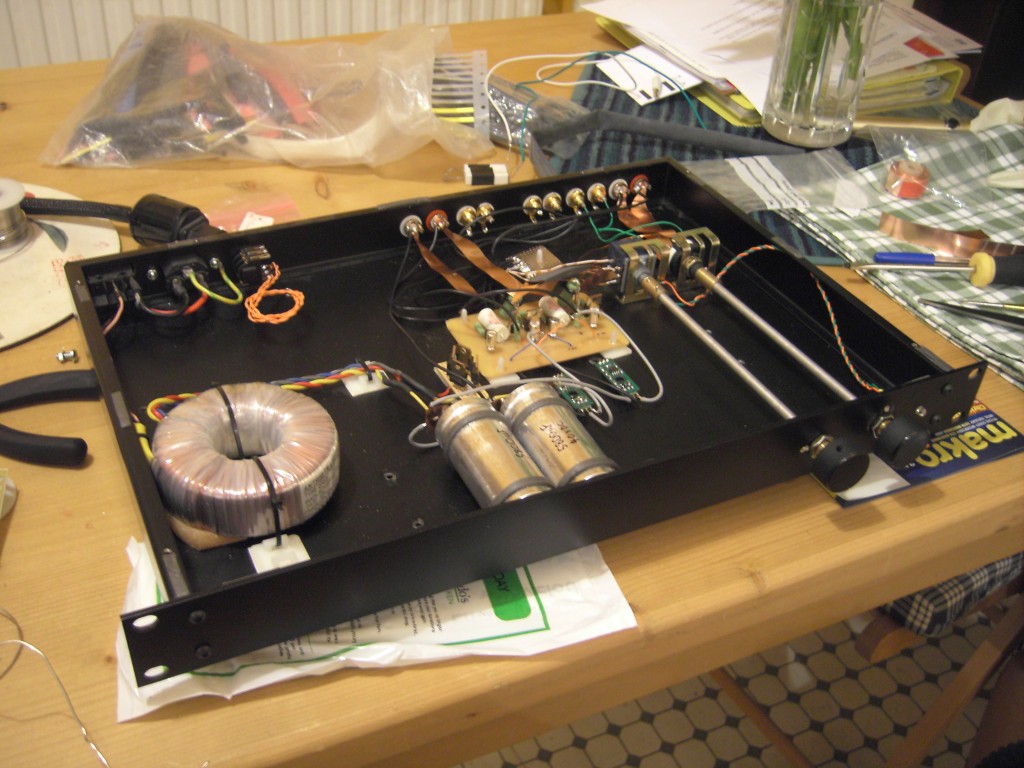

I'm using cheap OBs but in my sig there's a link to much better ones I'm still putting together. The preamp is just a simple buffer designed by Pedja Rogic, using S-Power regulators, Kiwame resistors, the Alps Blue pot, CMC silver/copper sockets and Mundorf foil wiring. PSU decoupling is Ruby ZA. Naked caps and 80VA toroid for the fun of it.

have the same Restek as you do and pretty happy with it, although it has one trivial problem - i could distinguish and hear some music even when the volume control put to silence.
Do you have the same issue and could it be somehow fix, how do you think?

I have exactly the same problem. Also, at very low volume, there will be a balance problem. This is all due to the Blue Alps volume control pot.
At some point, I will look into changing it but for the moment, I use the remote all the time so options are limited.

I am surprised that you believe that with the Alps pot set to min volume. I use a 10k Alps blue velvet (RK27) on my X-Ultra Mini pre-amp, and do absolutely not have this problem. Are we talking about the same pot here? If yes, then this might be a signal switching or layout issue, rather than the pot. Intersted to hear your comments.

You're unlucky with that pot, as the Alps Blue is sold on its excellent channel balance. Mine is superb at low volume.

To be honest, I've not looked any further into it. It could well be the external gain but I'd assumed the pot would be the weakest link. I could swap the balance over on the pot to see if I have more gain in one channel than the other and the problem swaps to the other channel. As I'm definatley not aware of this issue at listening volume, i'd still guess at the pot. Also, on the basis that the pot should effectivly drive the input to gnd at 0 volume regardless I still suspect the pot.
So in summary..........I suspect the pot 😀 (too many suspects the pot in there!!)
Edit - its a few years old now and crackles a little so it needs replacing anyway. I'd like to play with a lightspeed att. Driven off the original pot but thats just a passing thought at the mo........
