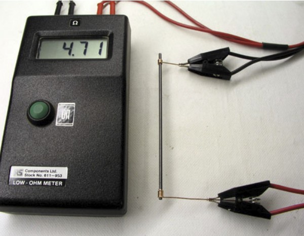

In diy's spirit non inductive ,we need a beta tester , for orientation ask to Marce x is "AC loop"

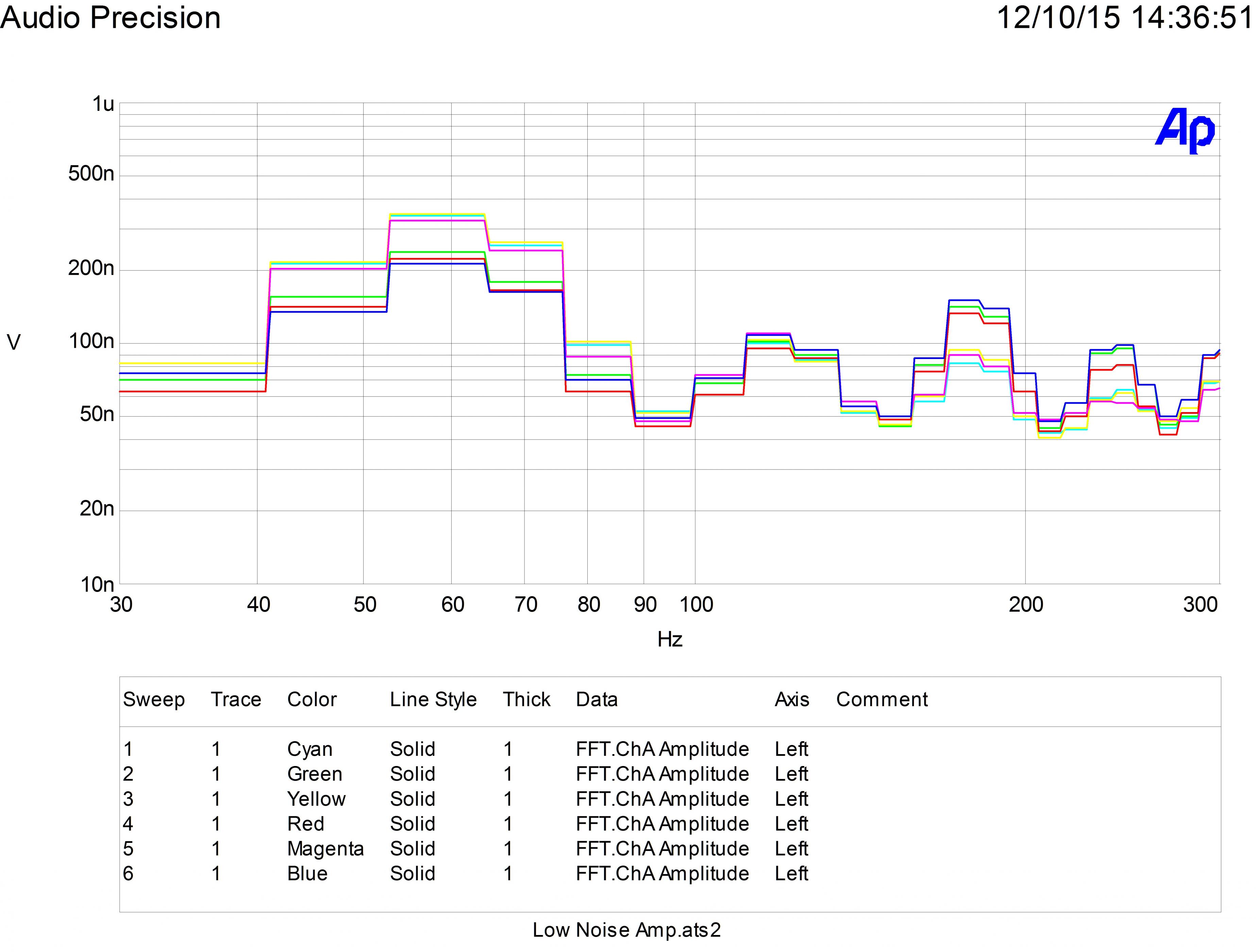

Attached are six FFT runs of a 12 volt gel cell across a 1,000 ohm 1/4 watt carbon composition resistor. A switch was used to rapidly switch the direction of current flow. It was switched between each run. Not much change in the excess noise, but the effect is repeatable. Do let me know what you get. (I wouldn't try a metal film with such a simple set up. It is certain to have much less excess noise.)
I think we can rule out micro-diodes as the effect also seems to be influenced by frequency. I consider this interesting but not a real conclusion.
ES

Scott,
ES
What effect, what is this a picture of? I see poorly resolved mains harmonics even though you are using a battery. So maybe the two wires make a different pickup loop/antenna. Confounders?
You also need to know every detail of the FFT BW, averaging, etc. to compute the expected standard deviation in the bins.

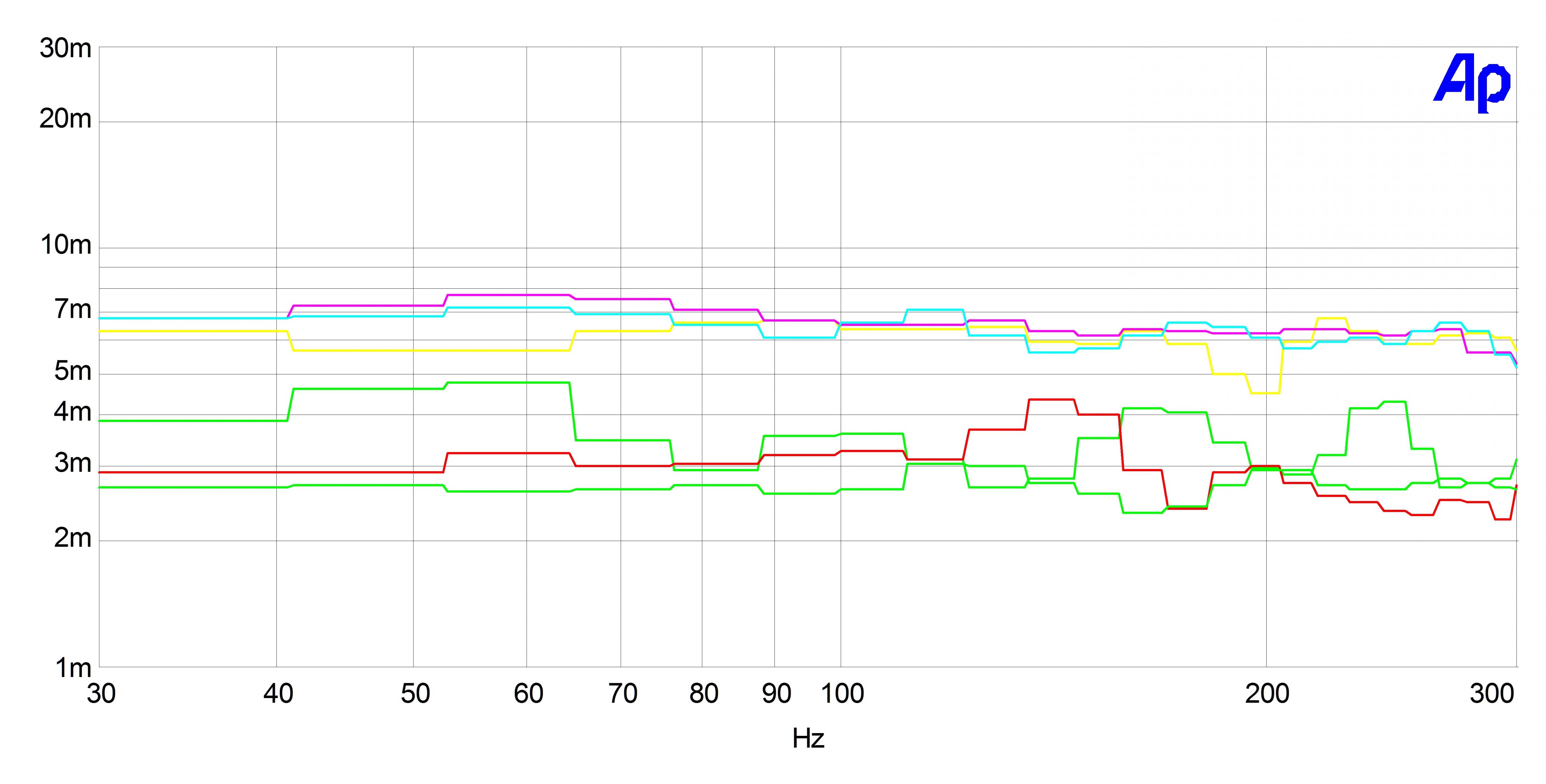

Attached is a second version using a low noise preamp so no mains leakage.
All we are looking at is the noise across a resistor when DC is applied. Polarity is changed between each FFT run.
Confounders? Switch, battery, lead length, temperature variations, random noise! I'll run it again in a few days. But if someone else has a battery, resistor, low noise preamp andd FFT they can try it themselves.
4K FFT 64 averages Blackman Harris window. 6 dB repeatably is interesting. No other claims, but it does lend some support to resistor directivity claims at DC. Nothing else.
DC applied through what another resistor and the battery. Directionality aside there is no, known to me, data that shows lumpy noise spectra from any resistor. I have been reading noise literature for 40yr.
