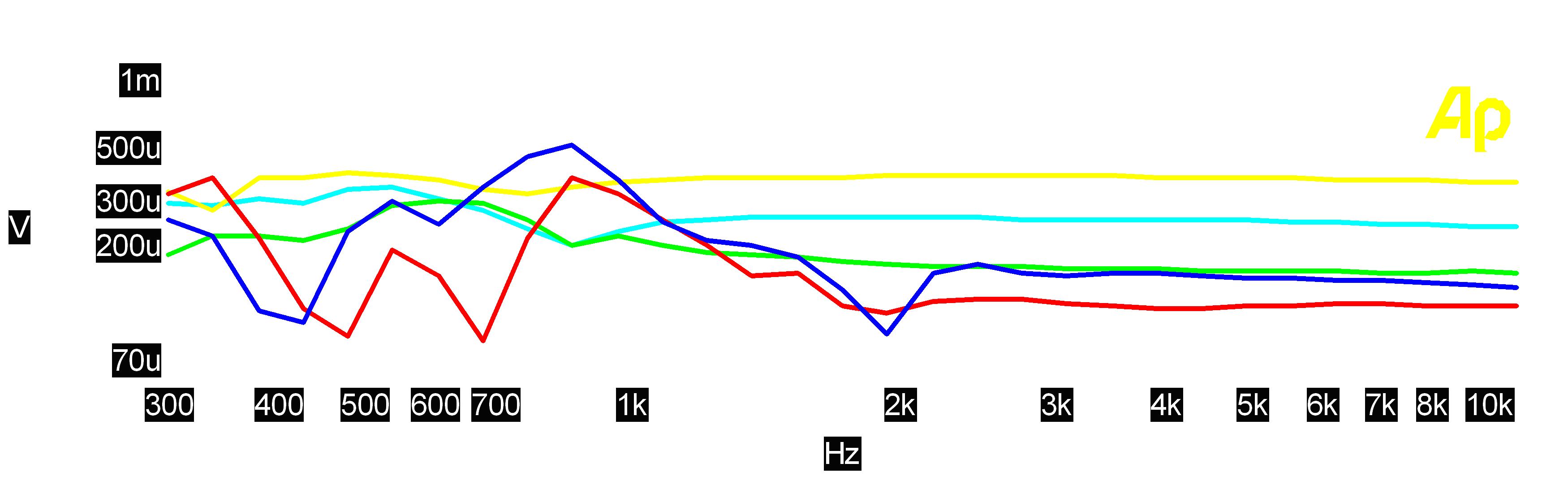

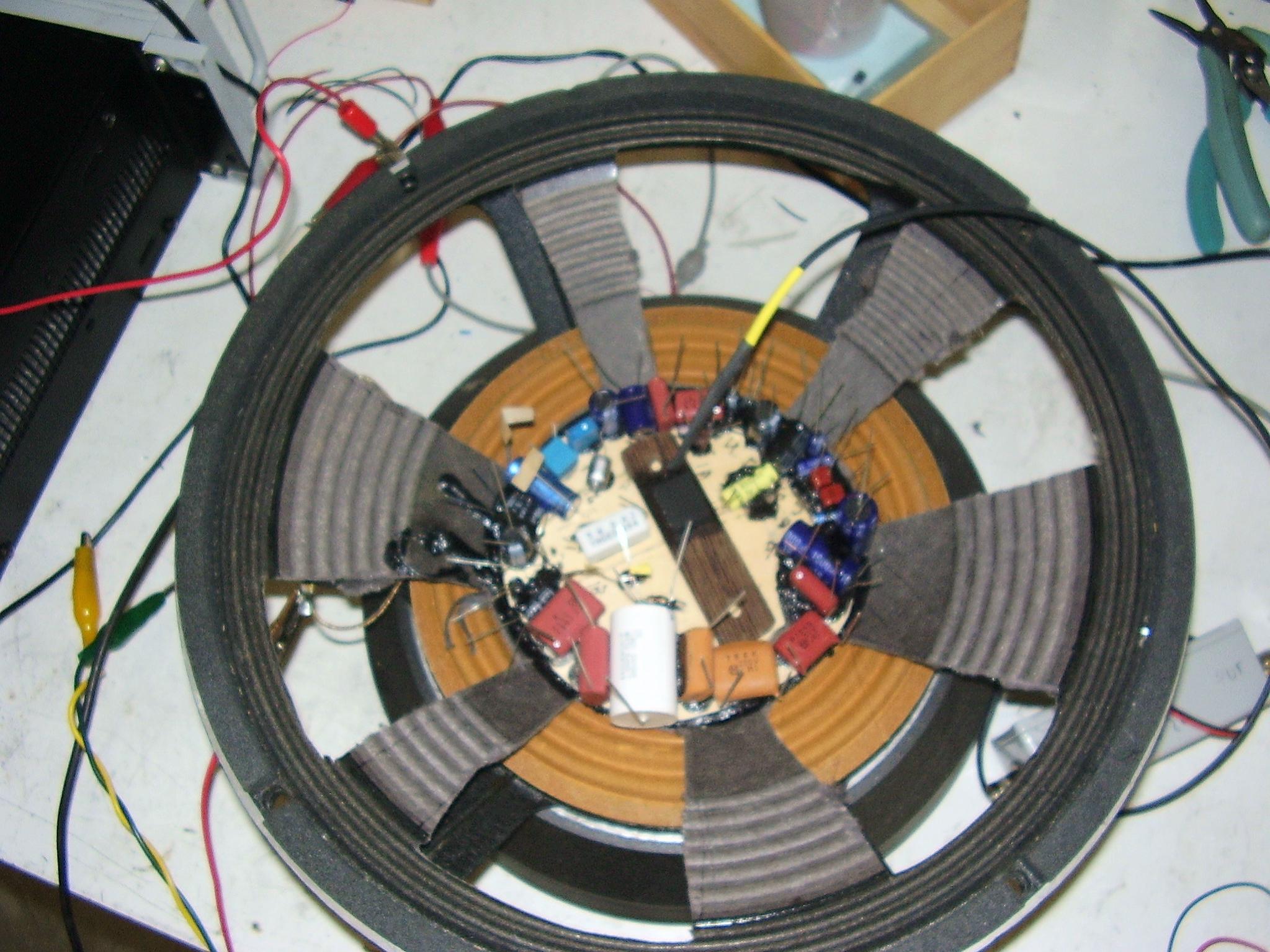

It is microphonic at audio frequencies. Worse if there is DC across it. You don't need to hit it with a hammer. A shaker table will show it well. As there is a baseline of at least .05G (G as in Gravity) vibration everywhere you can easily see how much of an issue any part will be in a given circuit. Not surprisingly the larger and bulkier capacitors usually have less of an issue.
Attached are some results from ceramic capacitors and a picture of the test device. Note where the resonances occur, prime audio frequencies.
Excitation was as I recall a 9V battery with a 10K series resistor. Note this is different than the piezoelectric effect.

Can't see any SMD caps on the test device. Can you point them out?
Not from then, but have noted the issue since then. Do you think it is the leads that matter? Did also test resistors and shorted leads.

Just trying to understand if you were extrapolating or if you had experience with SMD MLCC microphony. I was confused as we were discussing MLCC and suddenly a pic of leaded caps was shown. Of course I accept that microphony exits in any 2 parallel plates with a potential across them. But designing around that and chosing the right components is just good design with no magic.
Made by Dave Davies? Carefully made piece of gear, how did you normalize out the local acceleration of the caps vs the accelerometer? Claiming uniform piston motion of this would be a bit much. Also the dangling leads are not as the capacitor is used.

Lots of equipment subjected to military level vibration tests use MLCCs, there is no effect on the circuit performance during vibration testing, though if you flick them with a finger when they are on a board you can get a spike, but it not a real world test (the finger flick). Of course your PCBs are not going to be fastened to a sub woofer...
And yes the leads do have an effect, SMD devices are held hard to the board so differential vibrations are limited.
