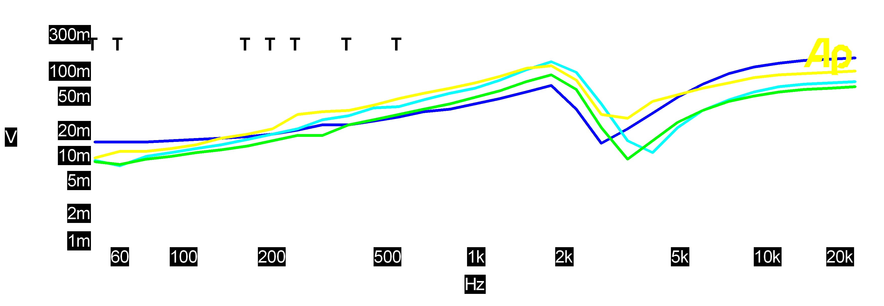

It is microphonic at audio frequencies. Worse if there is DC across it. You don't need to hit it with a hammer. A shaker table will show it well. As there is a baseline of at least .05G (G as in Gravity) vibration everywhere you can easily see how much of an issue any part will be in a given circuit. Not surprisingly the larger and bulkier capacitors usually have less of an issue.

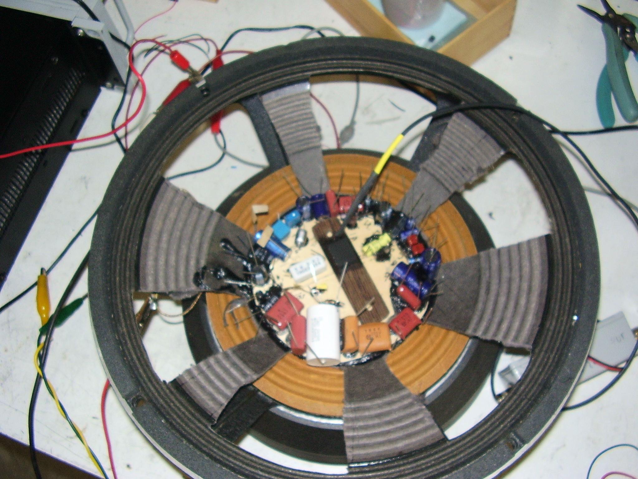

Attached are some results from ceramic capacitors and a picture of the test device. Note where the resonances occur, prime audio frequencies.
Excitation was as I recall a 9V battery with a 10K series resistor. Note this is different than the piezoelectric effect.
Notice that this pitiful/shameful 😱 (pick one) contraption
improperly elevated to "shake table" status 🙄 places "measured" parts straight in the electromagnetic flux of the voice coil, less than 1 inch away.
How can anybody measure any voltage across "tested" parts separate from the electromagnetically induced one (which must be orders of magnitude higher) and consider them meaningful of *anything* is beyond me. 😕

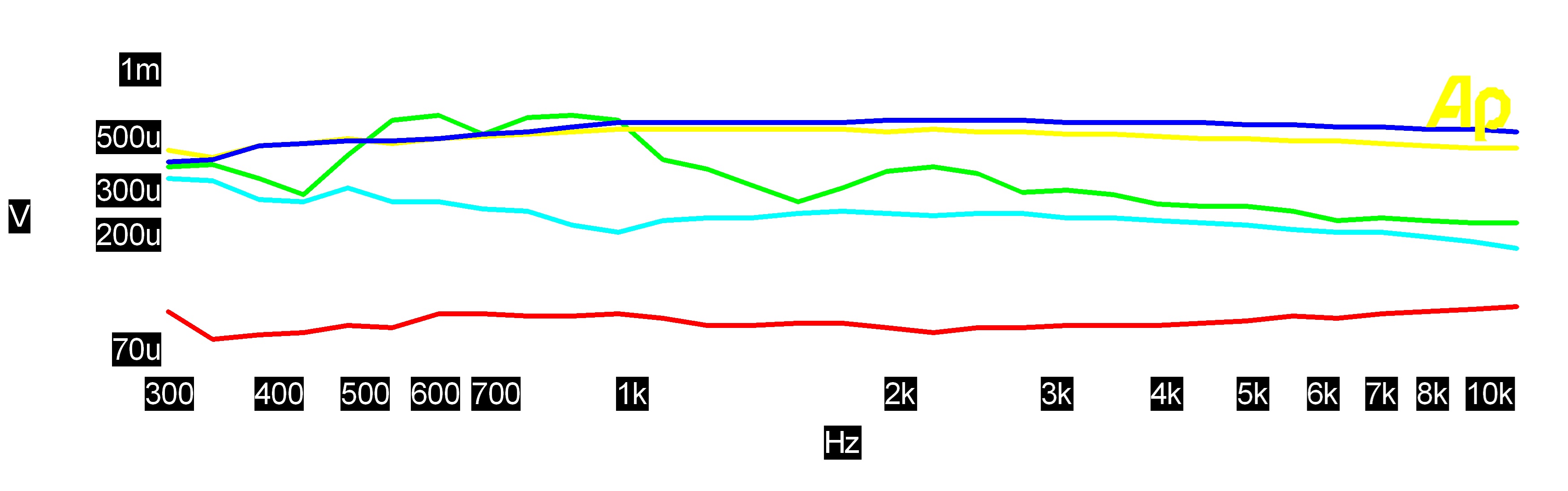

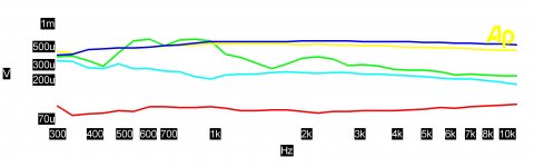

Here are plots of other capacitors and the shorted lead baseline.
The green - light blue is a mylar cap in two mounting directions, the other an electrolytic in both positions. The bottom is the baseline.
But as this is beyond you, just ignore it.

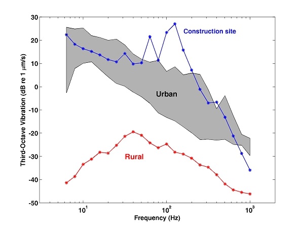

I'm shocked that having an anechoic basement you would tolerate so much seismic noise. This is from the Acoustical Society of America the number at 100Hz roughly translates to 6.4e-6 G for a rural area. Those guys at LIGO better give up they need to do e-23 G before they can detect anything more than an extinction event reliably.

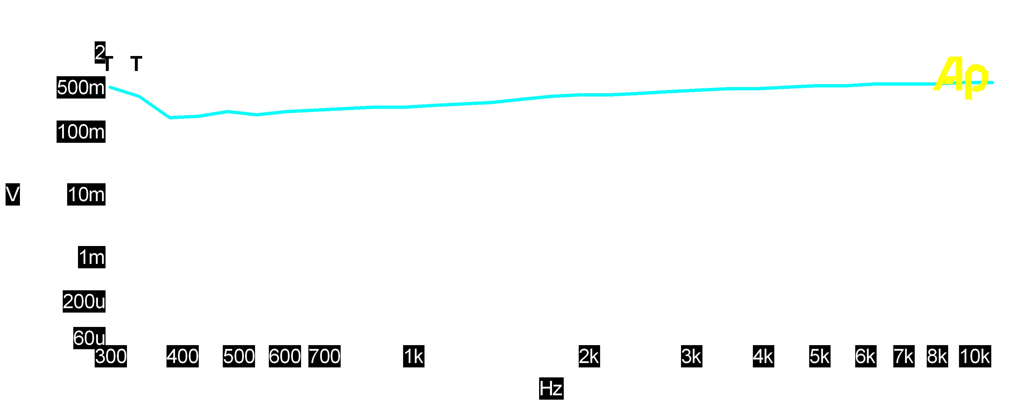

The tests were done in my shop. The .05G I get from my friends who do such work for among others the semiconductor Fabs! My shop is in the city and when trucks go by I get well above .05G (Your table is 1/3 octave bandwidth mine is 20-20K. So 10e-6 will go up to 10e-3, we are not too far apart!)
But attached is the baseline calibration of my shaker. it is 1V/G
My conclusion was do not put your phono preamp on top of your loudspeakers.
Again measurements not listening tests. The closest listening claims have been to glue the capacitors to the circuit card makes things sound better. Not really a tight claim to these results.

We have no trouble measuring 150uG/rt-Hz noise spec on accelerometers in the lab with little caution. You need to take care not to mix up total integrated and spot noise numbers.
150 uG I believe is .15mG/rt Hz so at a BW of 10,000 Hz that would be 15mG or .015 G.
So as we are coming to agreement, I will bet when you measure for noise floor you orient the devices under test for minimum external forces. Probably don't even tightly couple them to the counter.
