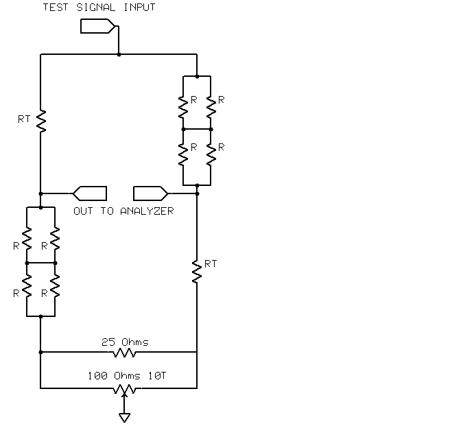

FFS, all we want is a diagram or at least a half decent explanation of the TEST SETUP. Otherwise all we see is just a couple of FFTs you could have cribbed from anywhere. A year's research? Don't make me laugh. It's a couple of distortion measurements on a couple of resistors (supposedly). 30 mins work, tops.

Merlin, this was with 15mA roughly, or 15V across 1k, which Ed did (in his defense) state in the article. Not a particularly apt comparison, which is why he carefully didn't disclose that here. Par for the course. Oh, and LA Vol 1, since he didn't bother to cite.
Ed, since I posted the voltage divider equation (and you haven't bothered to do that basic step), I don't see why you're whining.

Since voltage coefficient of resistance is specified for most resistors, you can just plug that in as the "delta" in the equations I gave and determine for yourself how much distortion will be caused by the resistor's nonlinearity.

Now what voltage do you think is present across the 390K resistor in the actual system use? My guess would be around .1 VAC. So if we look at the resistor plot and weight it for that voltage and the maximum energy frequency (around 125-150 hertz) we really should be seeing the levels of distortion shown in the plot!
BTY the resistors under test were run at 1/4 of their wattage rating. Standard practice is not to exceed 1/2 of the room temperature wattage rating.

Why is there any surprise that higher resistance values have higher distortion? I just got some nice unused old stock 10 Mohm resistors, not surprising they have 30 times the distortion of the one I showed. Is that valid data from a few old samples? No, particularly since anyone using them is looking for distortion. (The third harmonic does not rise the same as the other orders.)
Now will you look up a Norton model and get the heads up on why a single resistor really can contribute that much distortion?

You appear to be suggesting that a non-linear resistor acts by some mechanism other than resistance variation - perhaps a voltage source (generating the distortion) in series with the resitor value? If so, you still have a potential divider so the order-of-magnitude calculation from Jan still stands.simon7000 said:Not quite, if the resistor distorts the voltage across it, that is the voltage into the amplifier.
