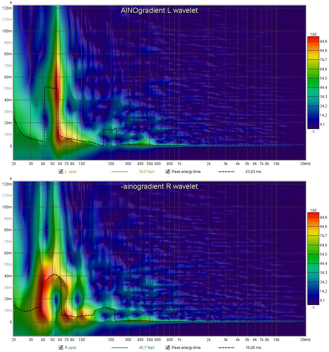

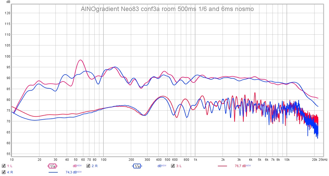

My living room setup fills the criteria quite well - speakers along the long wall in a quite large and asymmetric room. Distance between speakers is 3m, room width 8m. Below sweeps from L/R and you can see different mode maximums. I've had this setup for 8 years now, and listening to classical music has never earlier (with .1 sub and "normal" 2-way BR-speakers at same locations) been so satisfying!
