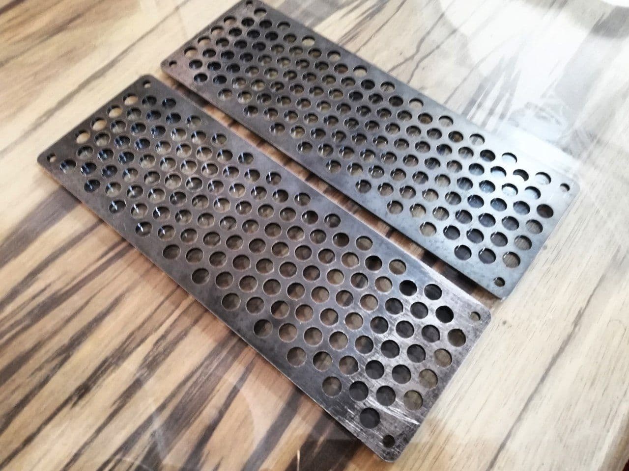

with respect to the flow-resistor's construction)
That perforated plate is not much resistive. It looks nicer and keeps plastic foam within the baffles.

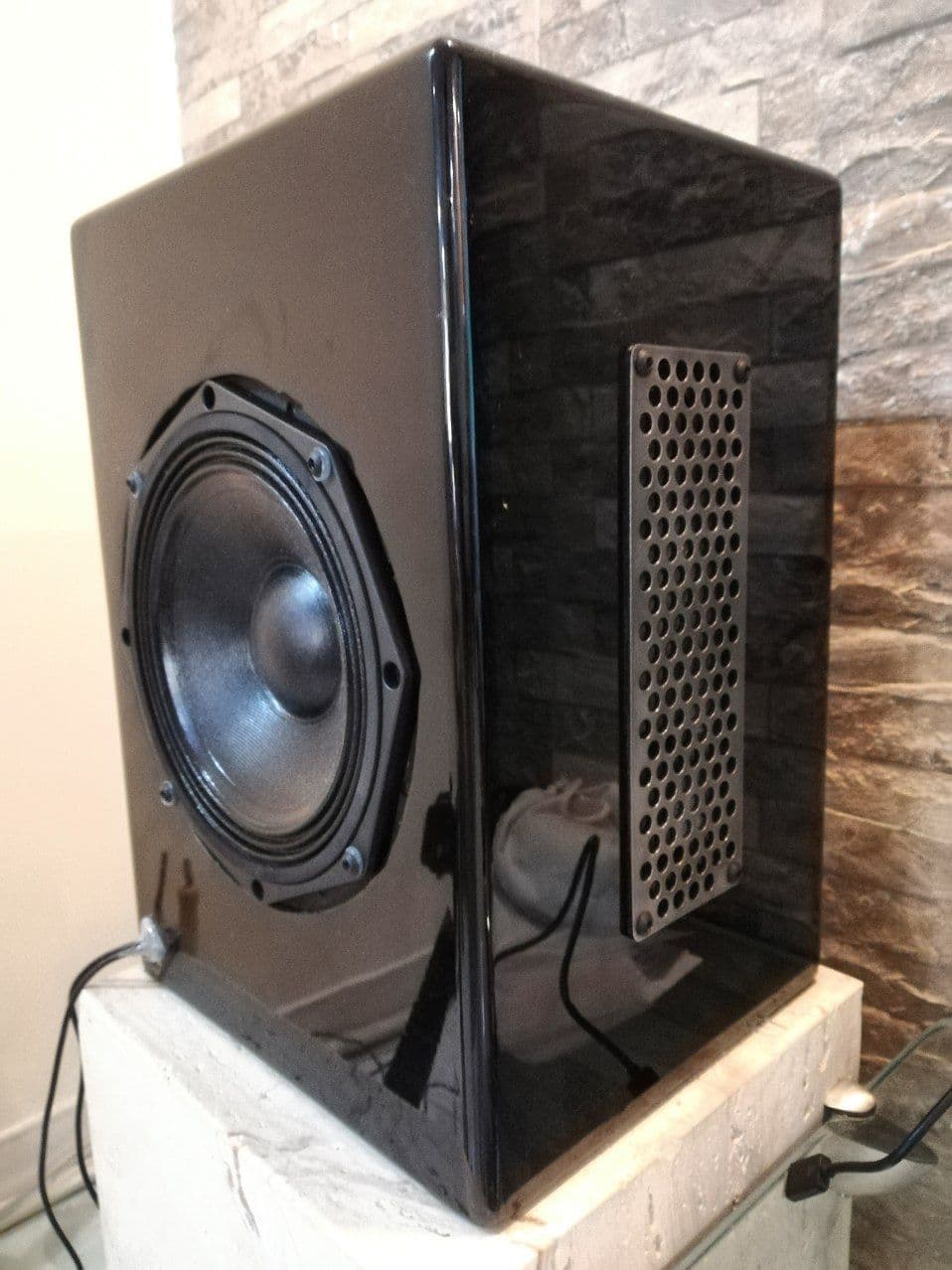

I don't wanna interrupt your discussion but to just let you know what I'm up to. I'm getting promising results though it a very difficult job to get it right. I cut two steel mesh using a laser router for the resistive ports to keep resistive material in place. this mesh apparently has an effect on the port response so I'll keep it as is to keep this Variable at bay for now.
-yes, it's not the perforated plate that's adding much resistance (assuming there is enough open surface area), but rather the material between the plates. Still, the perforated plate or "mesh" is often critical to achieve good resistance with typical (lossy non-structural) in-fill material (that's actually doing the resistance).
There are of course other methods to achieve the same result.
Again, the best I've experienced is with a *pleated/corrugated in-fill material (that is itself structural) along with the perforated-plate or mesh on both sides of that material. Similar to many replacement return air filters in overall design.
*of course you have to "play"/adjust the density of the material to get the results you want.
It's your thread, everyone else is interrupting your thread!
The mesh should be fine though typically you want it more "open", but I don't think it should be a problem as long as there is enough surface area open. The entire process is experimental, with a lot of trial to get it correct for your needs.
HOPEFULLY though you've got one on the inside as well: as in a "sandwich" construction (with the in-fill between the plates).
To me though, it still looks like you've got to much volume and the rear of the enclosure is still too far away from the rear of the driver. When looking at the Gradient's midrange: note that it is even "in front of" the magnet.
