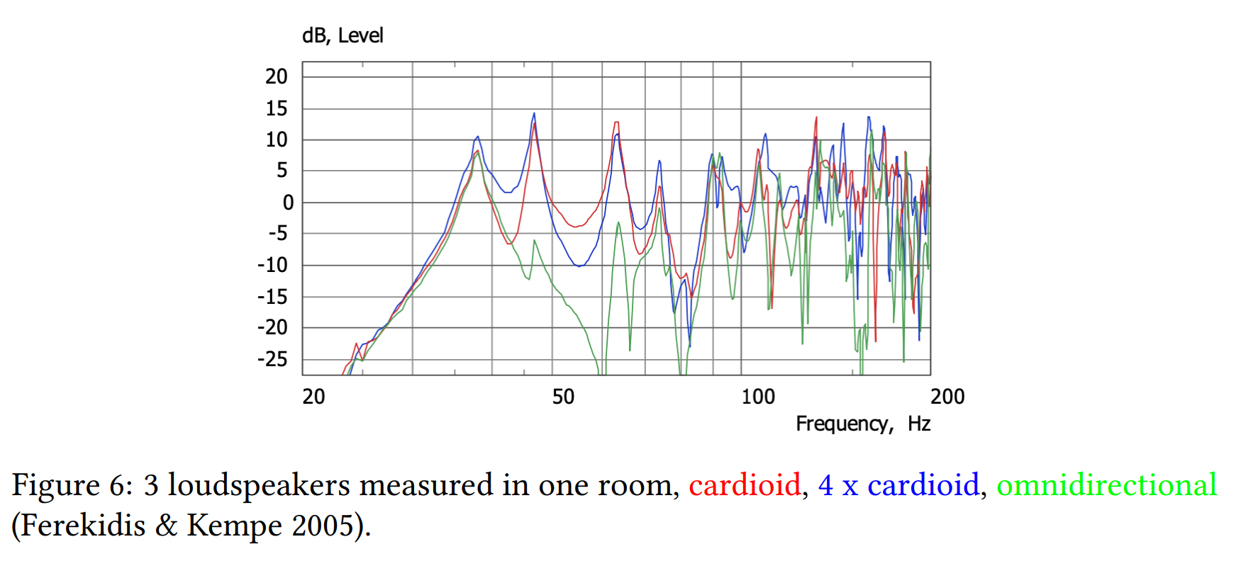

What is the nature of the low frequency system: is it multi-sub; one sub; a nearfield cardioid; only two main cardioid channels?

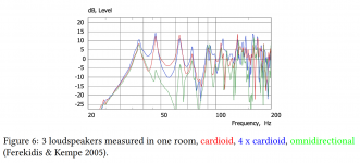

I included an image in the Kantamma LMF cardioid paper from Ferekidis, L. & Kempe, U. (2005). One cardioid vs one monopole vs four cardioid sources. It looks like one cardioid is superior to one monopole. If the low frequency system is restricted to only the two main channels (effectively one cardioid sub) then it looks like cardioid is better. But is a single low frequency cardioid better than a multi-sub monopole system, and is a multi-sub cardioid better than a multi-sub monopole?
Ferekidis, L. & Kempe, U. (2005), Controlling the Mode Excitation of Rooms by Using Multiple Low Frequency Cardioids in Multichannel Systems. Proc. Audio Eng. Soc. 118.
What is the nature of the low frequency system:...?
Probably #1 no and #2 yes.
But finally all depends on case; possibilities, preference, knowledge, time, gear and motivation. For example I don't prefer separate sub channel and don't tolerate rear right (due to ear damage) and rear is typically difficult...impossible in our living room so motivation to try anything more complex than stereo cardioid is very close to zero knowing that stereo cardioid works very well in all possible locations. Stereo monopole works okay in two possible locations with certain distance to front wall so I can and have survived without cardioids.
Smoothing/minimizing modes and getting smooth bass response at spot via EQ or multisub are overrated IMO, regarding music listening in stereo.
I have only limited experience with it (max 3 subs distributed), and that was in my small HT room. Abandoning a single subwoofer and now using two subs as 4-way speakers is an economical way to mix some modes and enhance imaging.

If you can't have -- or don't want -- multi-sub then a single cardioid (alternatively, two main channels w/ cardioid bass) makes sense.
In general, it seems like cardioid's big small room payoff is in the 200-500Hz range Geddes and Silas identified earlier. I'm glad Olli Kantamaa wrote his masters thesis on the subject. Personally, I derived more value with 500-1,000Hz cardioid than 200-500Hz. I could turn off the 200-500Hz and notice a difference but not a general preference. Turning cardioid on improved clarity but turning it off improved "warmth". If used as a center channel then I think cardioid 200-500Hz supplies a clear preference, which reinforces the idea of case-by-case evaluation.
