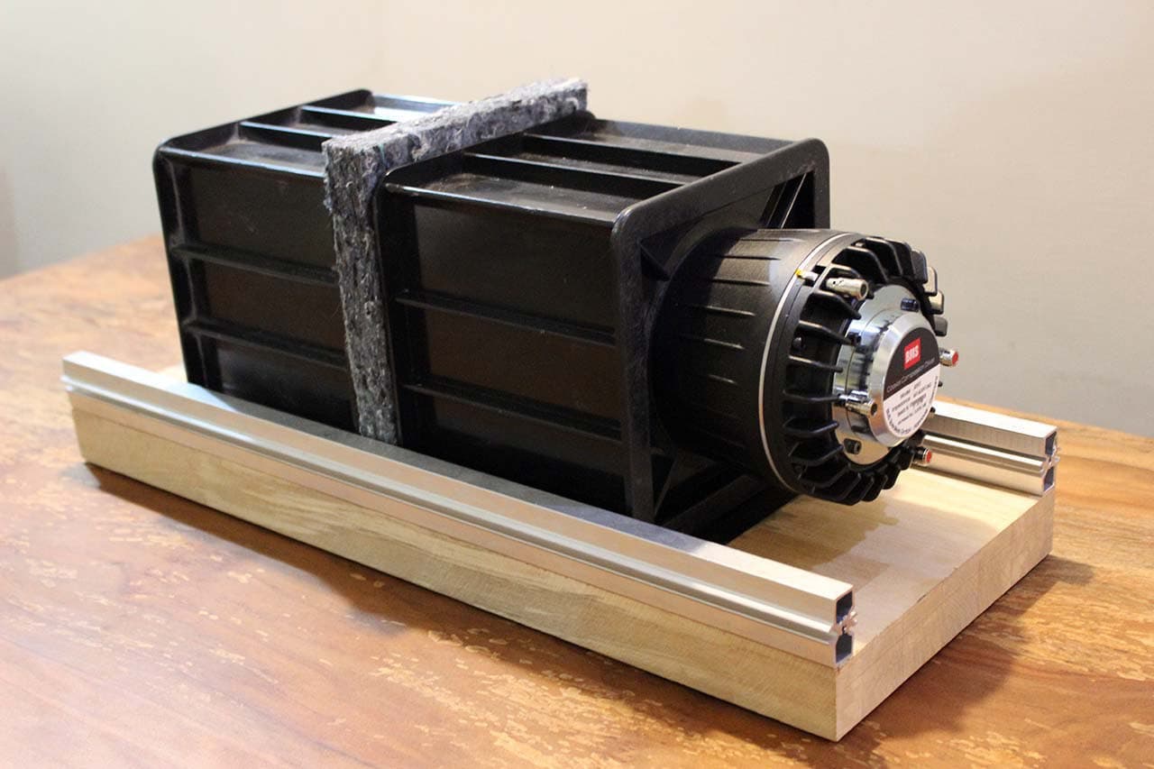

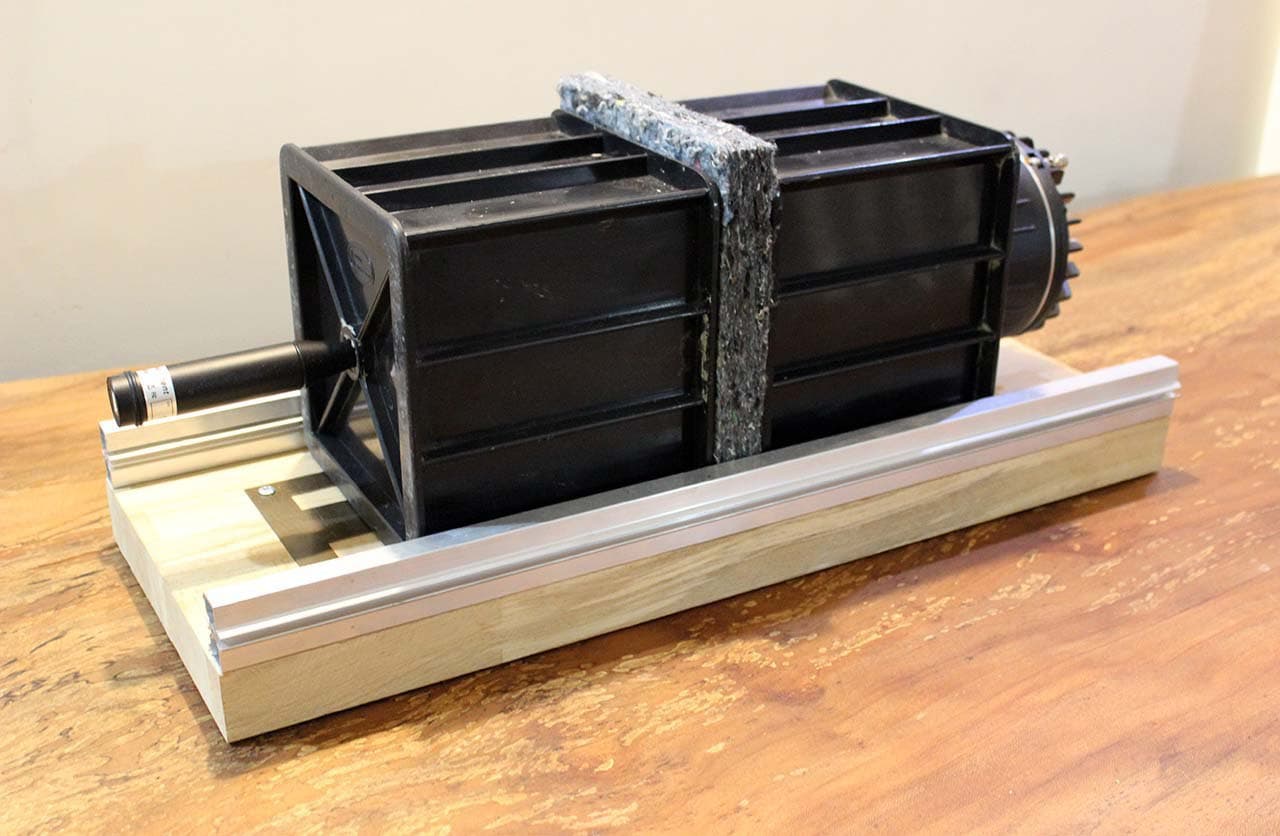

I used 95kg/m3 felt in different volumes with no luck at all. it seems a very hard job to be done.
without the ability to measure both sides' responses individually, it would be impossible to be done. I need a big baffle to mound the speaker with the resistive box on it so I can measure responses on both sides of the baffle and then try to match them.

According to this calculator, a fibrous material with a density of 40kg/m3 will reduce the speed of sound to 58meters per second. (it's a little bit odd to me). I have to verify it by actual measurement so I will know how much delay will occur for a given thickness of that certain material.
I hope this transmission loss measurement chamber will help me to measure the effect of different materials on the speed of sound tough the frequency range is not that low with BMS 4592ND. I'm gonna use Holmimpulse and see what happens in the time domain. I may build a new plane wave tube with low frequency driver if needed.

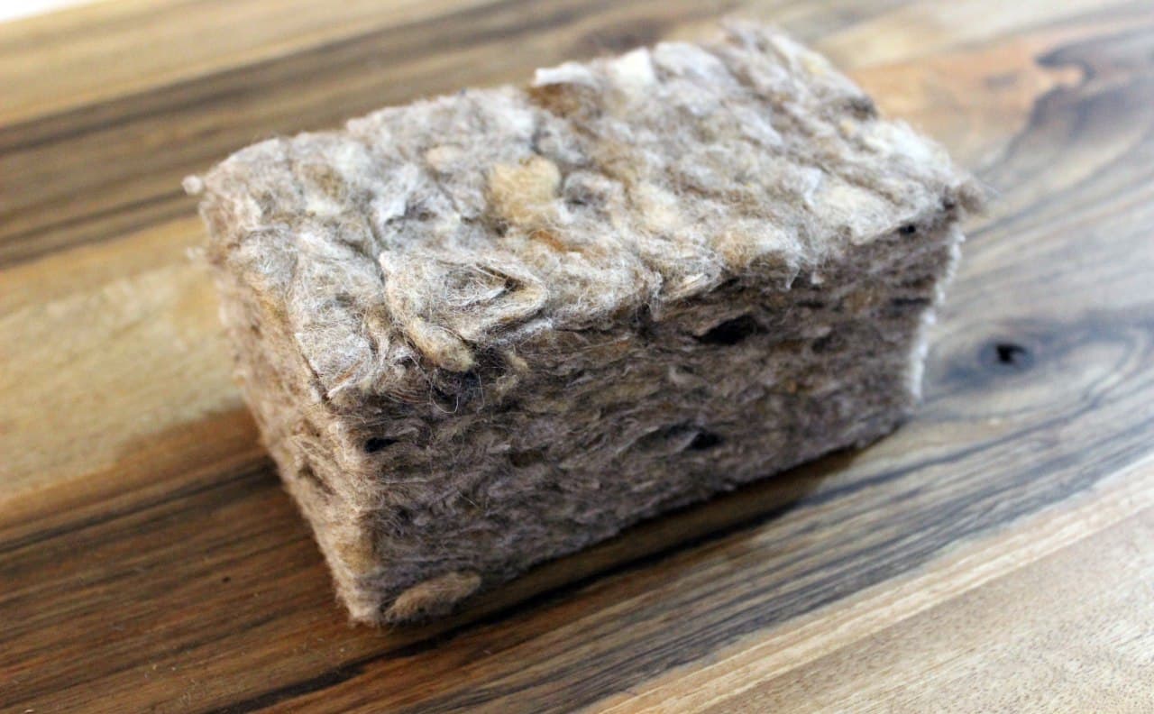

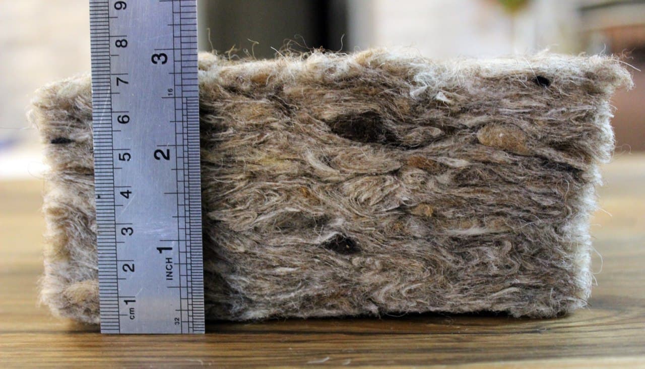

the company I work for (Loudspeaker and acoustic panels manufacturer) produces some nice natural sheep wool insulation felt. it's totally odorless and natural contrary to fiberglass which is made of slag/waste of steel refinery furnace which contains unwanted elements, something active elements. it's the best thing we have ever used for speakers' internal dampening.
I may try this natural wool felt as well but I think it lacks the consistency/uniformity:
