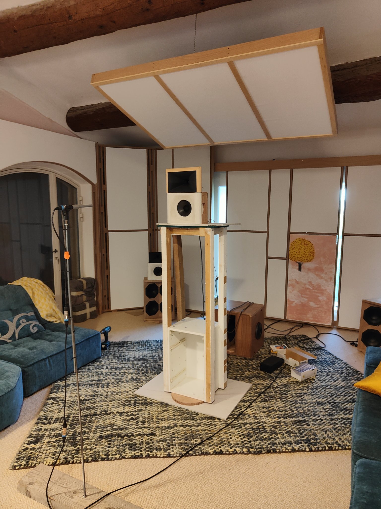

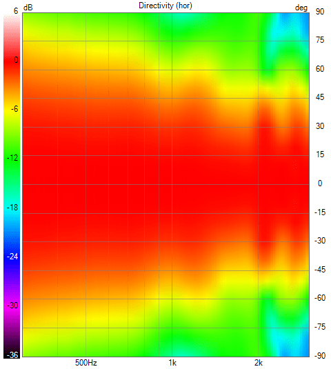

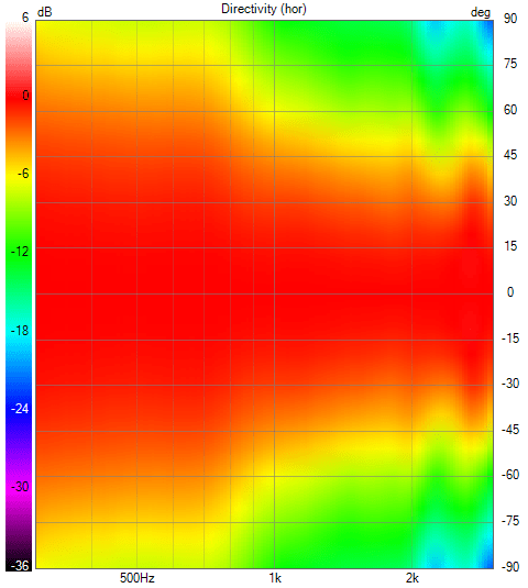

Hello,
here are the first results from my trial with PHL 1140 in a box with a waveguide and some cardoid ports.
The box is small with melamine sponges inside and some felt behind the driver.
I made a polar with the holes blocked and one with the melamine behind the ports.
We can see a carioid effect but also that some medium around 1khz is obiously escaping from the carioid box !

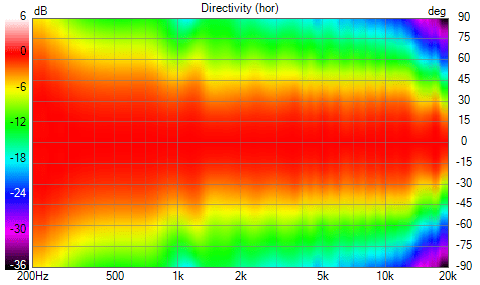

Then I have the final polar with my AudioHorn X-shape X25 horn which is a 90 degtree CD horn. Measurements are of course approximate but this gives a pretty good idea.

Results are not bad at all!
Bsc is right where it should circa 750hz, yes you have that 1khz bump in cardio, but it seems to be present in the x25 polar plot too.
How steep are your filters? Maybe there is a cumulative effect? I think the bump in cardio could be related to the port distance too, at least i have observed that in some of my experiments ( and it's equal to half wavelength of port/membrane distance).

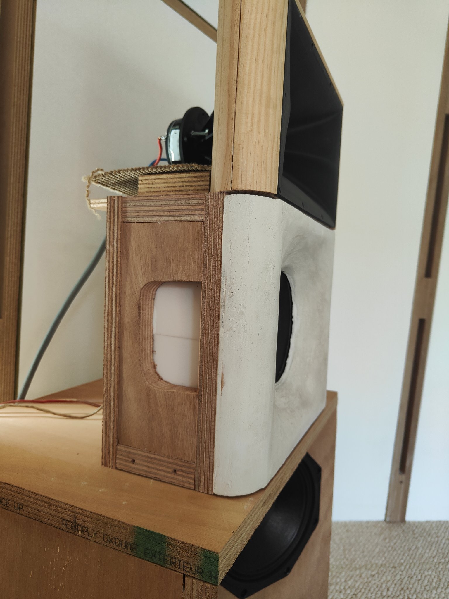

I use LR48 filters.
But I think the phl cardio polar was done without filter and with rew doing 300-3000hz sweeps.
As I said I think my ports could be better if longer and thinner ...
I started reading a manta topic and I think they explain why they choose this kind of shape, to avoid medium leaking out of the box and still have an effect in the lows

Sd of ports are which ratio of membrane area ( sd)?
In the x25 round graph there is the same 1khz aberration as with the cardio box. I wonder if it could'nt be linked to your measurement set up as it seems there is a plate on which is mounted the loudspeaker, could be a reflection no?
