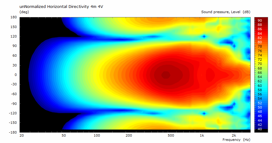

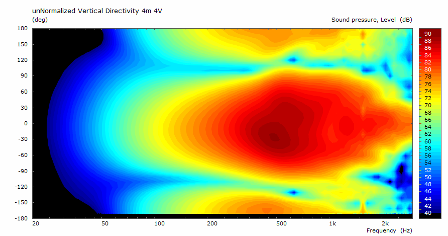

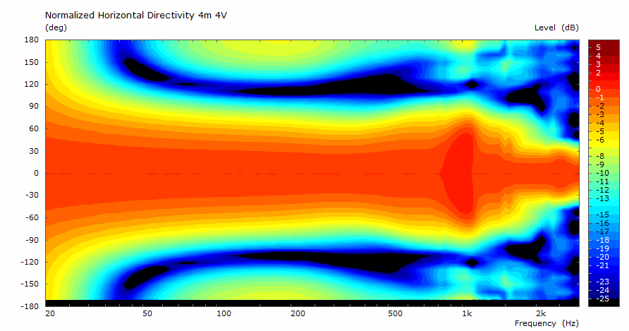

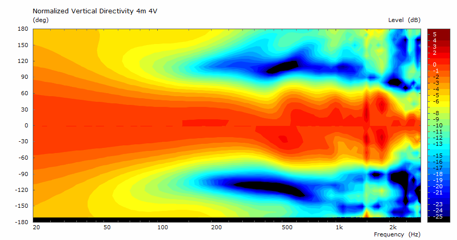

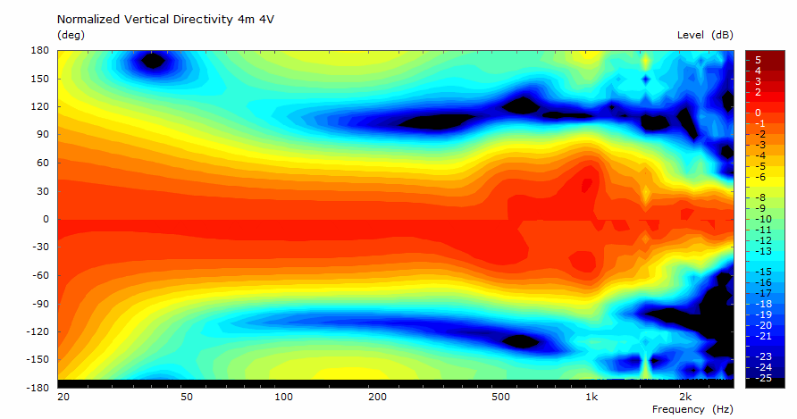

The first picture is a great achievement and It seems to be the key to getting a uniform cardioid plot. I have a question. where is the best place for an acoustic flow resistor in Akabak ? Interior subdomain or Exterior? I tried both but the results were different.for the 5208:View attachment 1264914View attachment 1264915View attachment 1264916View attachment 1264917

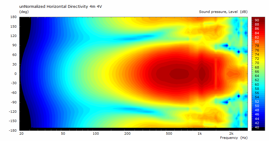

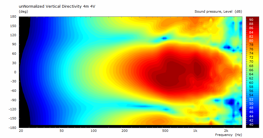

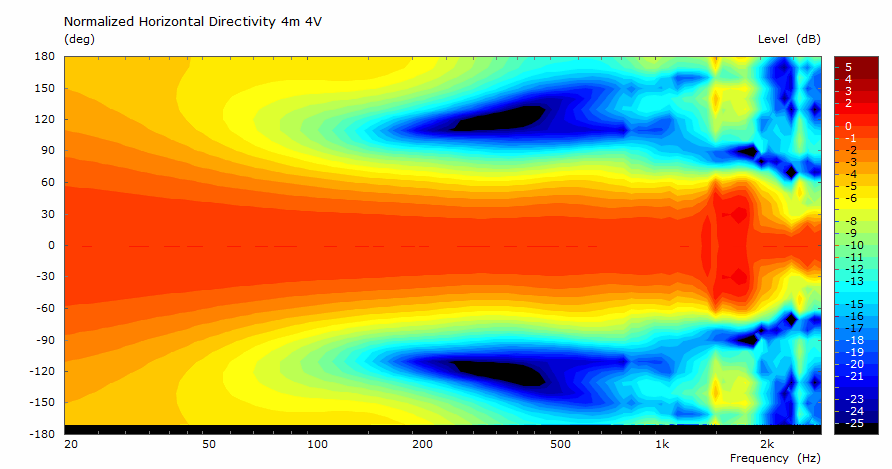

for the PTT8:
View attachment 1264918View attachment 1264919View attachment 1264920View attachment 1264921
I think the PTT8 is pretty good as it stands. I hope to be able to improve the PTT8 with more work.
I wish I knew the answer to your question, I'm working in abec as I haven't made a serious effort to port my script to akabak. I also wish I knew what size/shape/material flow resistor would result in that picture.
I have the flow resistor in the interior subdomain. I think it might be best to make it its own sub-domain, with interfaces on both sides; one to the interior and one to the exterior.
You need absorption on interior surfaces modelling loose fill and then you need a flow resistor between interior and exterior. How best to model that flow resistor is TBD for me. A slot with absorbent surfaces is the best I can do today in ABEC.
Thank you. It helped me a lot and I think this is the correct way.I have the flow resistor in the interior subdomain. I think it might be best to make it its own sub-domain, with interfaces on both sides; one to the interior and one to the exterior.

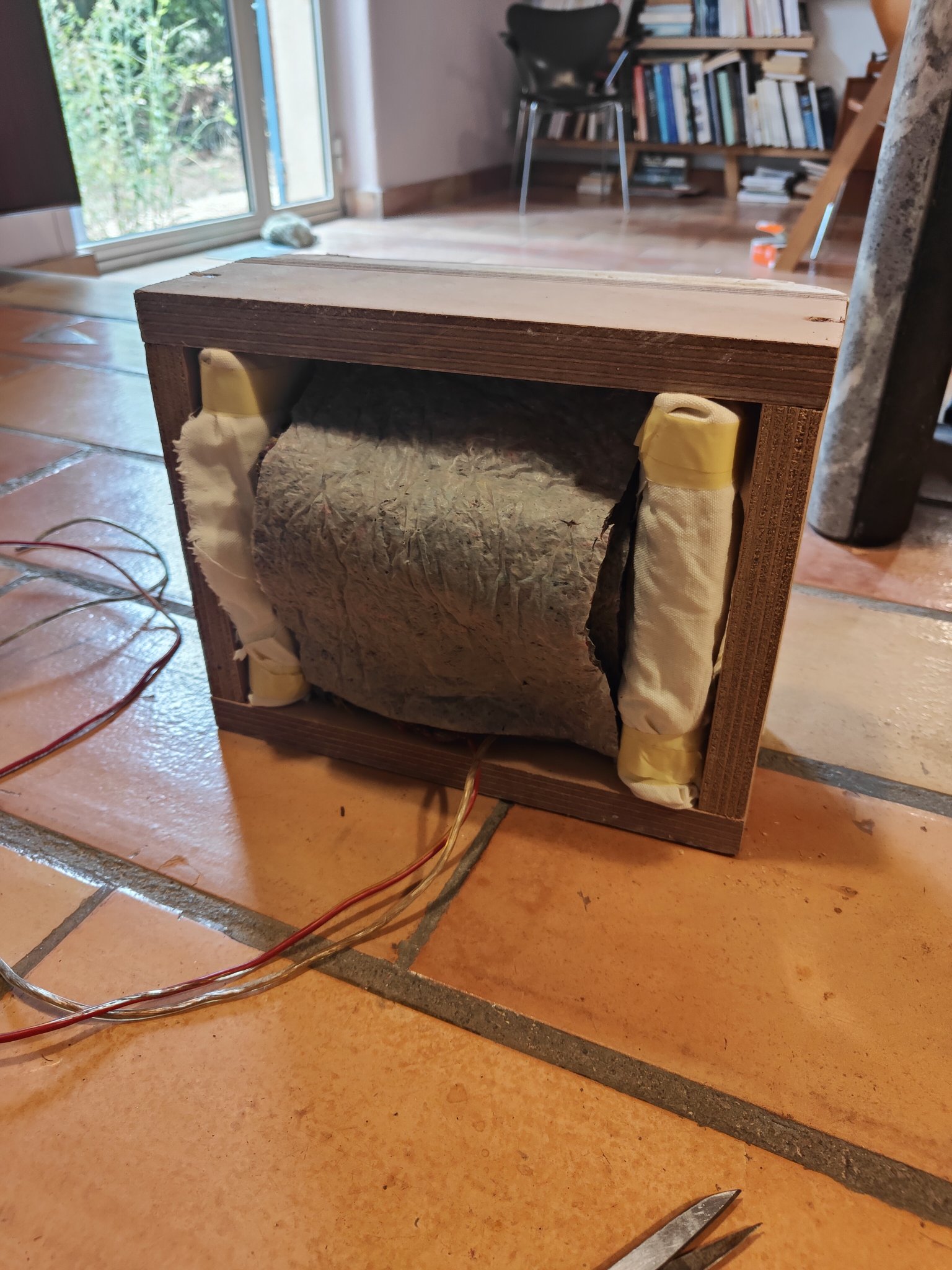

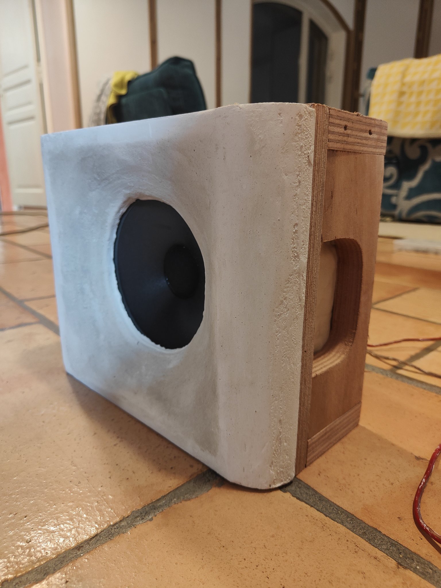

Hello,
I have started some test with a phl 6" and two ports on the side walls. I tried with high density rockwool from sound panels and I think it is too dense, I can't feal anything whel I listen to the the ports...
I have ordered some magic sponges which should be made out of Melamine....
Back is closed with a baffle, inside it is 20 by 25 by 8 CMS.
for a quick test, make a measurement from behind with and without your port +absorber in place
port sealed for no absorber measurement
I think you will do better the closer you place the port to the front. i.e. start right behind the baffle; pattern will hold higher with ports closer to front, and
you won't need as much absorption.
