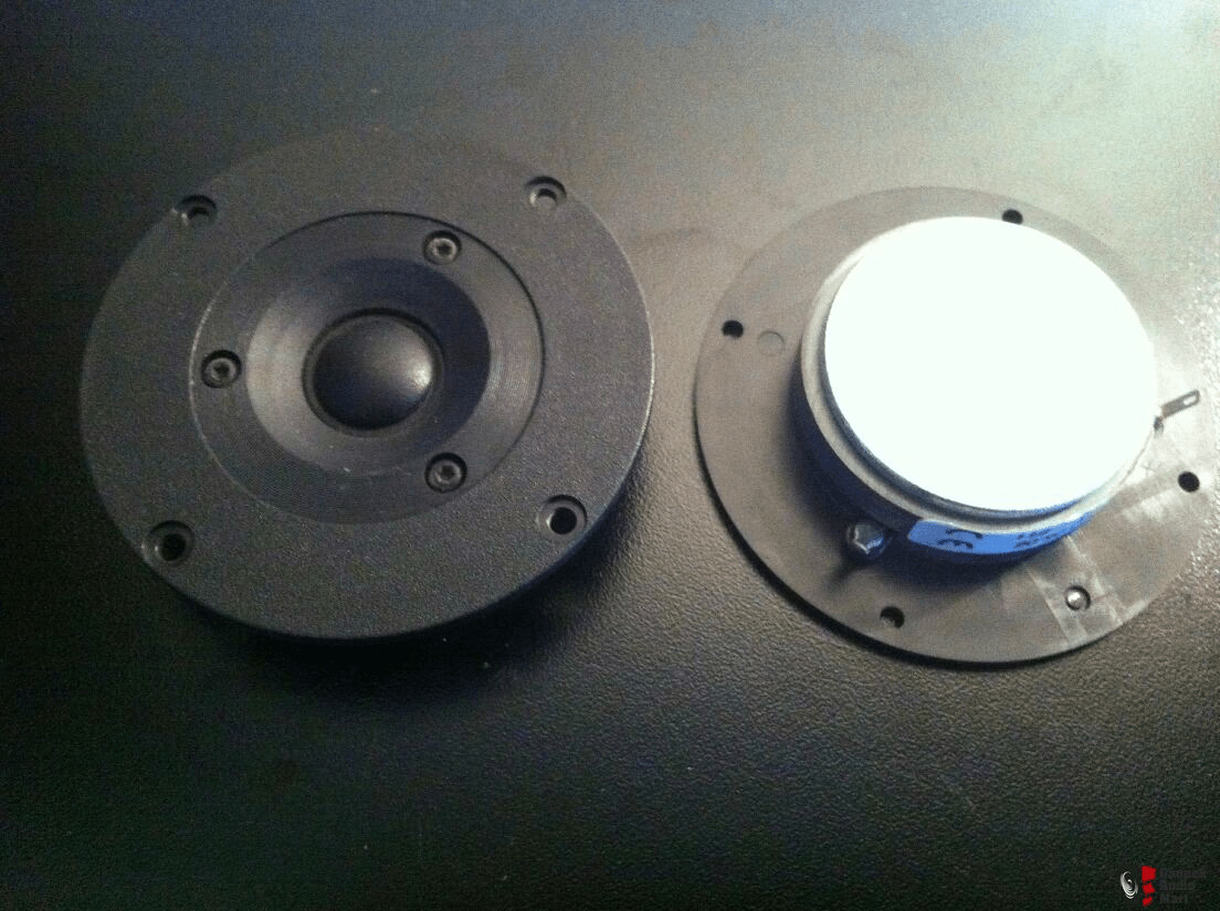

Could the dome and coil be moved from D27TG to the D20DT? If lucky you can maybe find some 19mm repair kits on AliExpress for a couple of pounds. Maybe even some with the same gloss as the original. I have some Technics tweeters, that are of. First ill see if there's dry oil in them. Next I'll logo for replacement diaphragms.

What gap would you allow when buying a voice coil/membrane?
I didn't properly test the tweeters only finding out later that they are both dead.
May I ask exactly what tests you have carried out on the tweeters to determine they are "dead"?
Did you get a DC resistance reading of around 4 ohm, or did they read open circuit?
If they read around 4 ohm, the voice coils may simply be gummed up by dried out ferrofluid, something that can be rectified: https://speakerrepairshop.nl/en/instructions/replace-ferrofluid-in-tweeter/c-36
Regarding the possibility of having to replace a voice coil, the exact requirements will be revealed if you dismantle a tweeter.

Placed ear over the tweeters when using the speakers.
I then performed a 1.5v battery test across the terminals for both tweeters.
No sound or movement.
Tested the battery across a working tweeter to eliminate battery issue.

I'm willing to slice 3mm off the north and south side of a pair of D27TG35-06's to fit.
Your suggestion to service the existing tweeters is worthwhile pursuing.
I'll study your repair shop link.
The examples I have differ in that they have a very thin circular covering over the wave guide and presumably covering the inner screws.View attachment 1295592
EDIT: That replacement my not fit as it has a larger face plate diameter so measure carefully.
This thin inner wave guide cover also has a "TDL Electronics" sticker on the lower edge.
It appears to be glued down and can only be lifted by damaging it.
I think this thin cover and decal differentiate the TDL tweeters from the free market versions.
When I press down on it I can see the 3 circular screw hole depressions.
I could just rip it off as I have nothing to lose?

Before you do that please answer to my earlier question. Do the tweeters give a DC resistance reading of around 4 ohm, or do they read open circuit?
Maybe put it in the oven to loosen glue? I dont dare to suggest temperature though.
At least a domestic oven can't exceed the Curie temperature of the ceramic magnet (450 ℃) at which it will lose its magnetic properties!

The judicious use of a heat gun/hair dryer may be preferable to sticking your tweets in the oven.
My suggestion was to check if the ferrofluid (if fitted) had dried up.
This is irrelevant if the voice coils are open circuit.
That would be the most straightforward solution. No need to locate replacement voice coils for the originals or to replace ferrofluid.
It would be nice if its possible to move the faceplate? to the new tweeter to make it look more original. Would be lucky if it fits, but not uncommon.
About oven I was thinking 50° celsius should be safe, and do the rest with a heatgun maybe?
