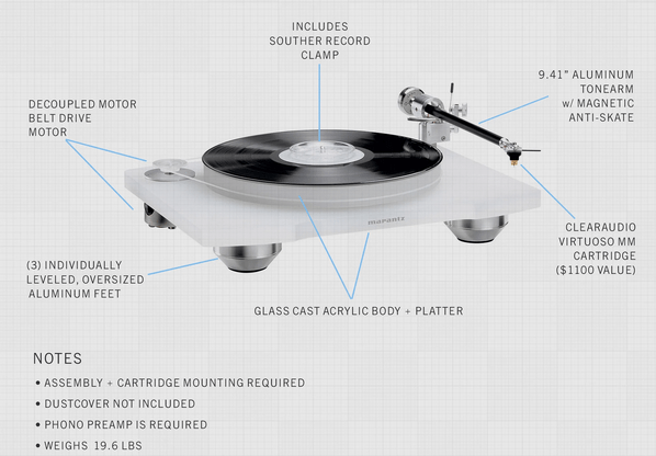

The turntable in question
As you can see from the above post this is not a cheap TT and well worth getting it working properly. I'd be incredibly surprised if the motor differs between the 50 and 60 Hz versions so the most cost effective solution is to obtain the correct pulley from either Marantz or, more likely Clearaudio.
The minor question of 120 V and 220 V is also to be borne in mind.
It is unlikely that the same motor will work on different voltages with the same winding, unless a switch or wire link of some sort is provided for using the entire coil at 220 and half coil at 120 (or the other way round).

If we assume the correct pulley can be sourced ( I know what assume can be broken down to 🙂 ) then obtaining
a step down transformer is trivial, Amazon sell a selection for around £25.
Given the price of the unit it's reasonable to assume the motor is of decent quality and should not need to be replaced.

Some motors will work, some may not, Marantz was a finicky make.
Let us hope for the best, the motor will draw at most 50 mA AC, so the transformer should be inexpensive, the proper one should be a magnetic type, not the electronic type.

All the above ideas involve replacing the motor (and building a replacement controller) for what is a pretty high quality TT.
I'm sure the OP appreciates your ideas but I cannot see how any of these improves on simply replacing the 60 HZ pulley with
the correct 50Hz one and adding a small 240 -> 120V transformer
