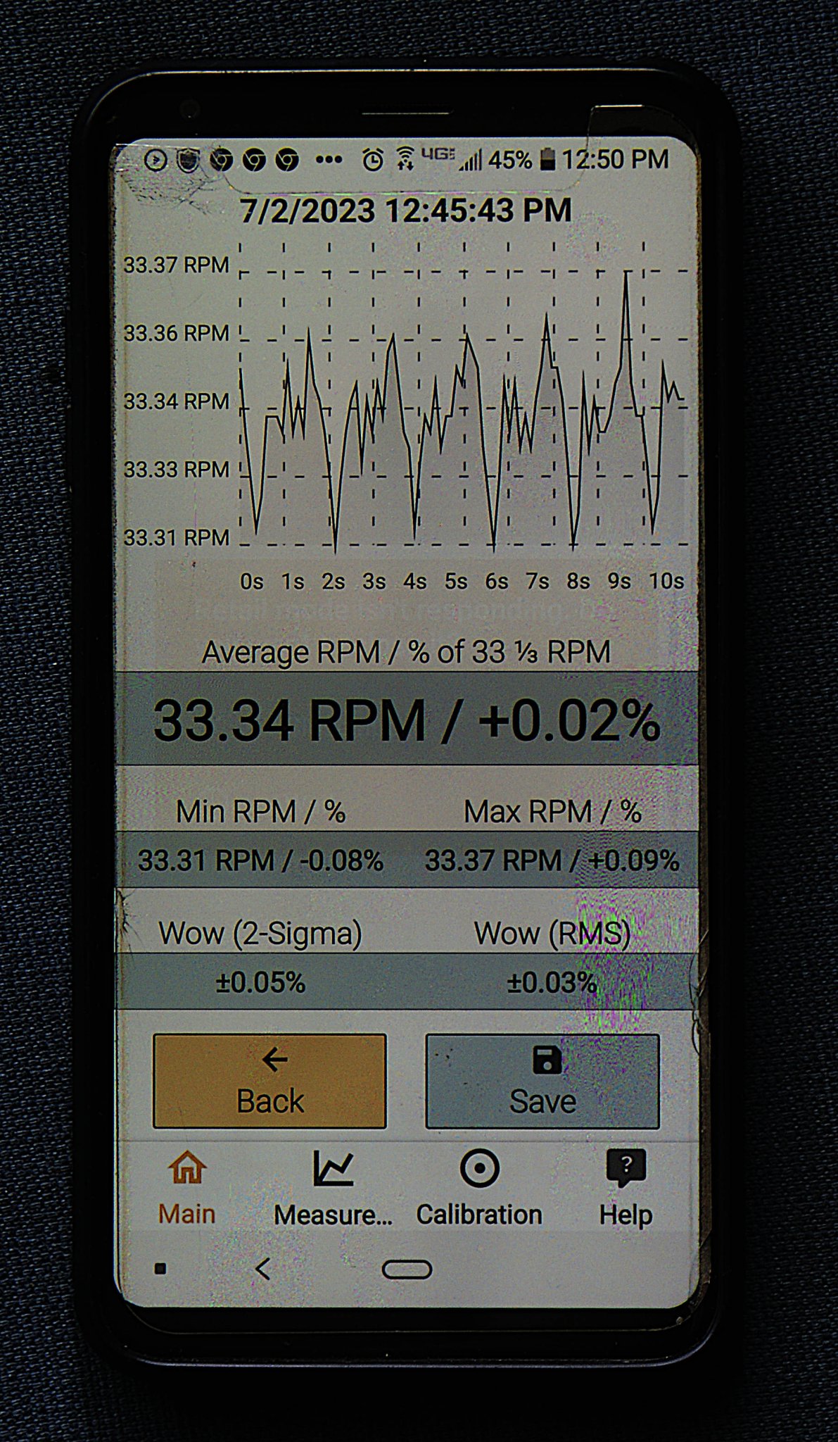

Agreed, that's a very decent result. Speed drift normally shows up over longer periods of time, eg an album side, and is caused by change in resistance of the windings. Some higher quality motors include a feedback circuit using a frequency generator, this, in conjunction with extra circuitry stabilises the speed.
