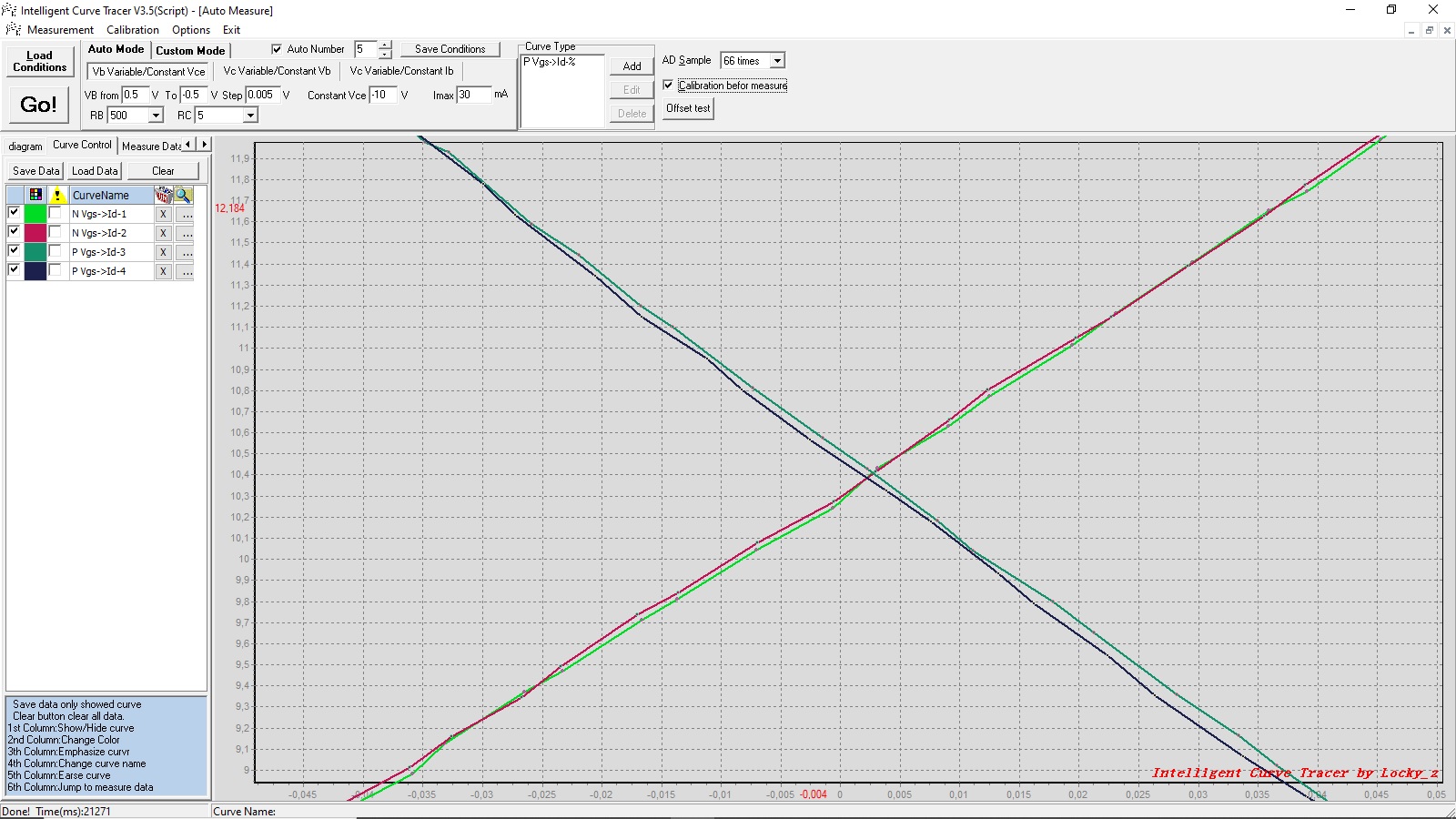

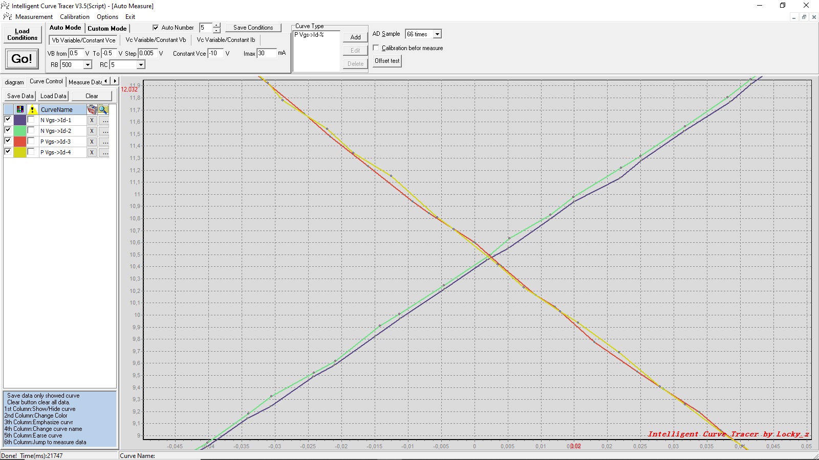

I have bought from him several times, he has done incredible good work at matching every time:

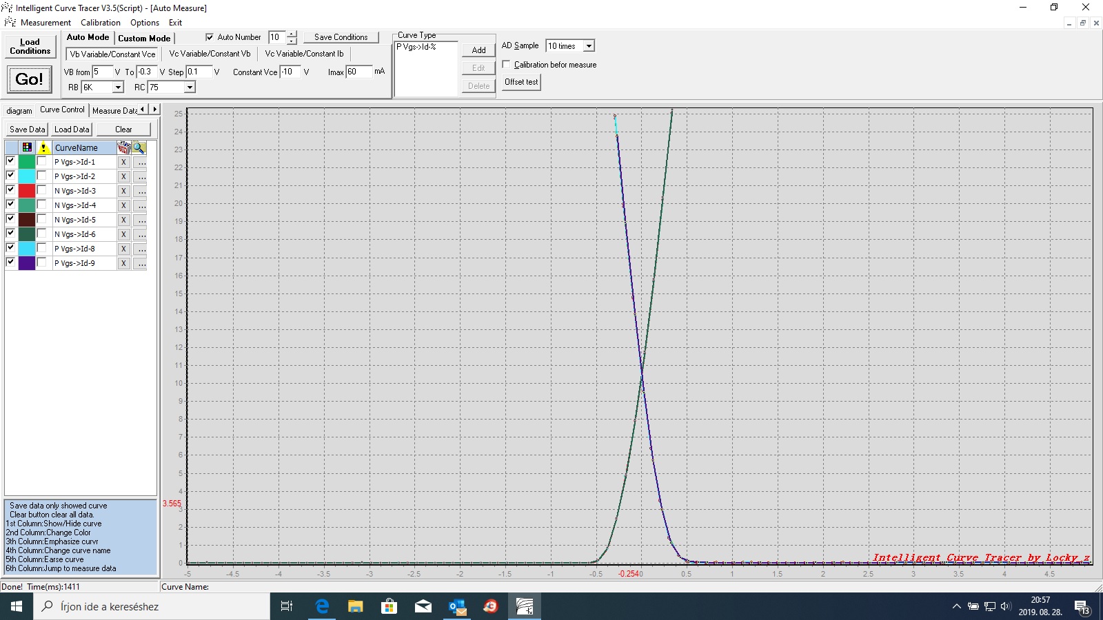

(On the picture attached you can see four pairs of really original Toshiba 2SK170/2SJ74.)

Looks good, but to understand just how good you might want to show the region of interest (-0.5 - 0.5 (V) Vgs and 9-12 (mA) Id, in this case) with higher graphical resolution.There is no need to worry if Alweit has some parts in his inventory jet.
Alweit has always been a great source of matched FETs and I'm not questioning the quality (highly recommended!!!).
I'm just pointing out that a 1-2% Idss difference would be invisible in the chosen graphical representation - and I know somebody would ask for less difference before calling it "incredibly good"😉
You are the champ😎
What is the standard error across independent measurements?
0.3% Idss and 3% Yfs, at controlled temperature, of course.
