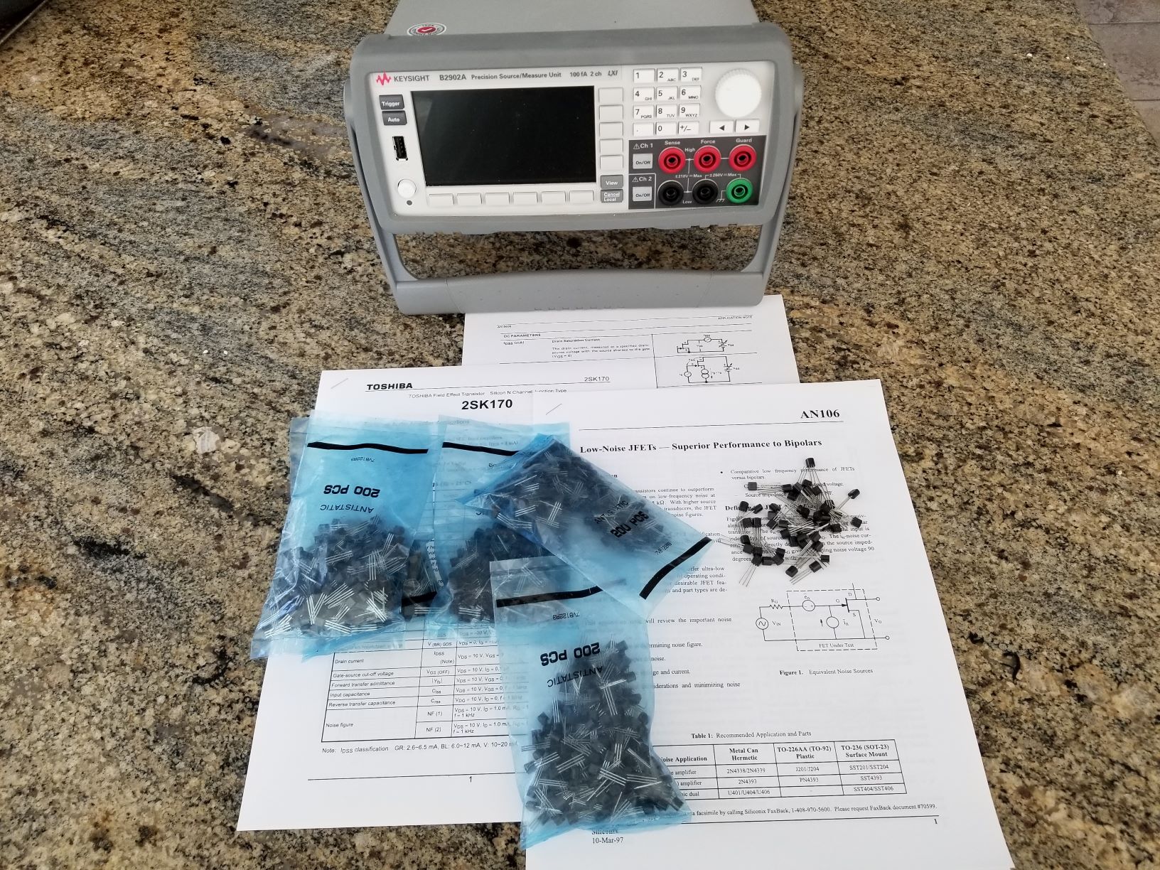

Sparky The Cat and I are moving to a new lab. So far the new benches are in place and a couple of the instruments have moved as well.
Now I am going through a Bankers Box of JFETS and including them in the new spread sheet of inventory that we are going to take with us. We have a bunch of sealed static bags of 200 each K-170’s and J-74’s plus others JFETS purchased most of 20 years ago.
We are looking at the K-170 datasheet for factory specifications. The plan is to test enough of these to confirm that they are indeed real. We want to use test procedures that will match the Factory methods and results. ON the bench is a Keysight Source Measurement Unit that will measure down to tiny slices of amps and volts B2912A. Plus a APx analyzer that will measure down to tiny bits of noise.
We Have a Fairchild application note here with Fairchild factory test circuits to test various JFET parameters, AN-6608 https://www.onsemi.com/pub/Collateral/AN-6608.pdf.pdf . We also have a Vishay document that goes into great detail about JFET noise factors. https://www.vishay.com/docs/70599/70599.pdf .
We see that the K-170 datasheet calls out the IDSS current measurement at 10 volts not the 9 volts that you see other people use. Is this important or not?
Here on DIYaudio we have seen many noise plots, not too many measurements. Are we talking a dBV number between 20 and 20KHz? Is the measurement weighted, A or C weighted or just a Noise Factor with no units?

Finally have the Keysight SMU hardware speaking with the Keysight software. Should be able to trace some curves of such JFET pairs.

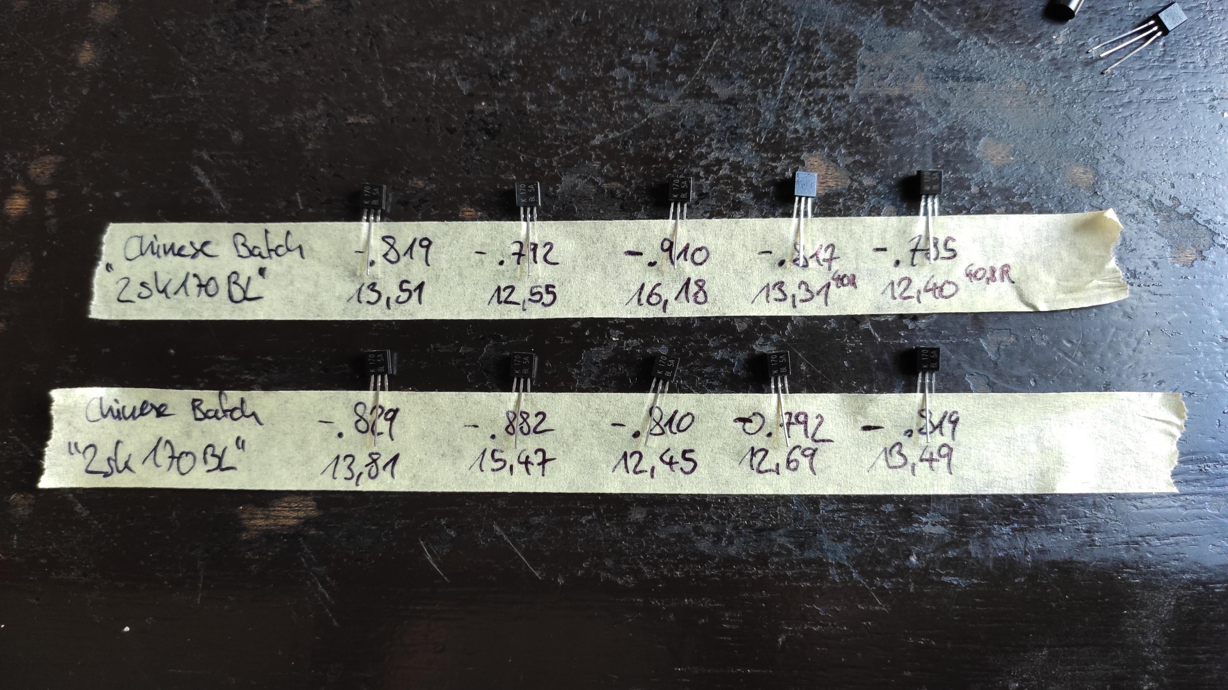

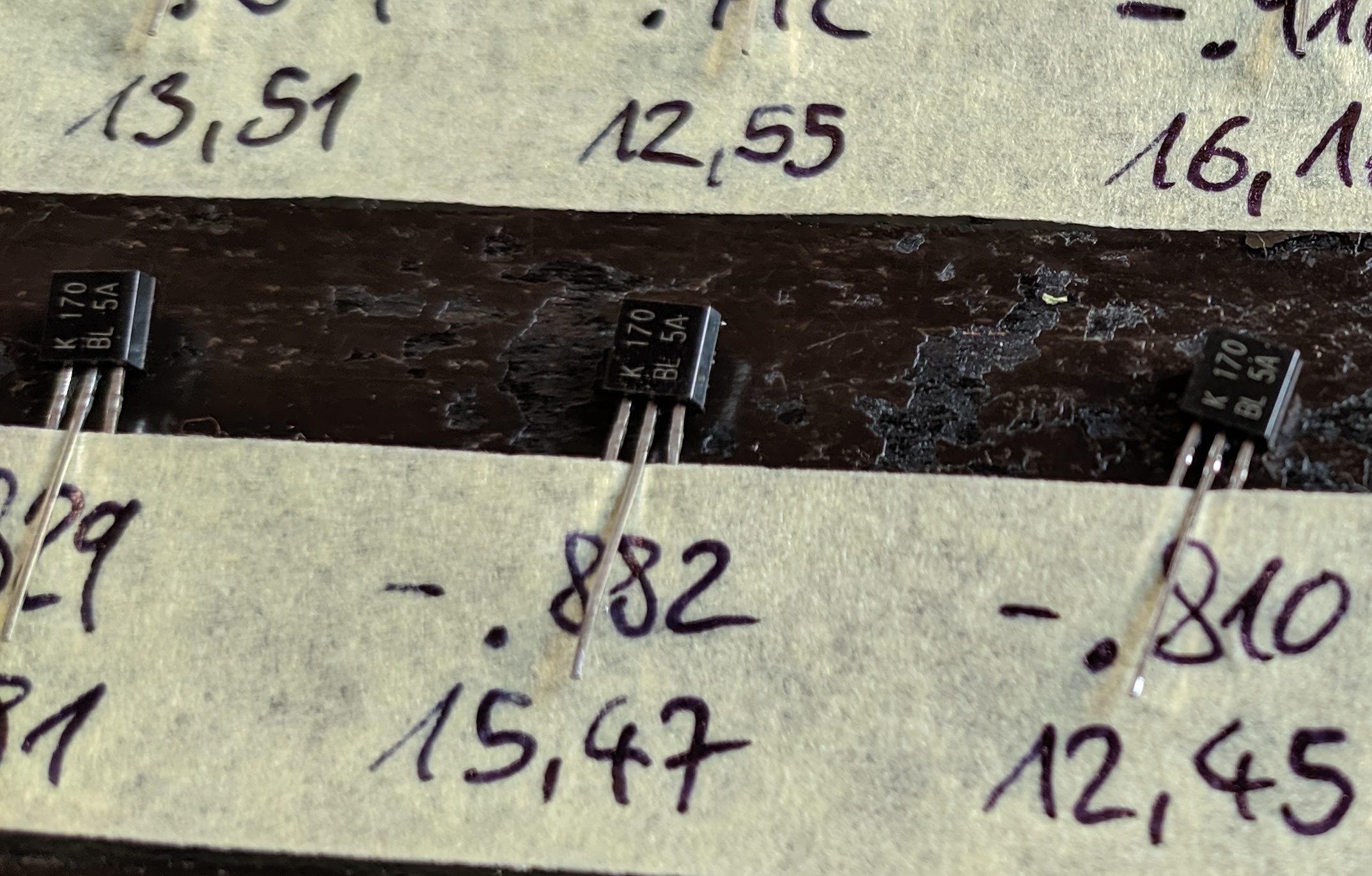

Hi all,
as i am fiddling with jfet riaas since a few years i need 2sk170 from time to time. I used to source really good matched quads from german Himmel-shop on ebay, but they are sold out.
Lastly i found different sellers on ebay who sells cheap 2sk170 marked as "BL 5A". I bought some from a german seller and some from a UK based shop to test them. Both batches measure fine. Example: Idss 8,95mA, Vp -0.680V, Rds 54 ohm.
I also plugged them in my circuits and they work fine as replacement for confirmed genuine 2sk170s. I only did not measure noise performance, but cant hear no difference from my proven genuine ones when plugged in circuit.
Now a new small test batch arrived from a chinese seller who pretended to be located in germany. Those "2sk170" show the same marking as my working ones but they measure way out of the BL range, see attached pictures. What is that? mislabeled 2sk170Vs? What do you think? Do you have bought 2sk170s with the same "BL 5A" mark through ebay lastly?
