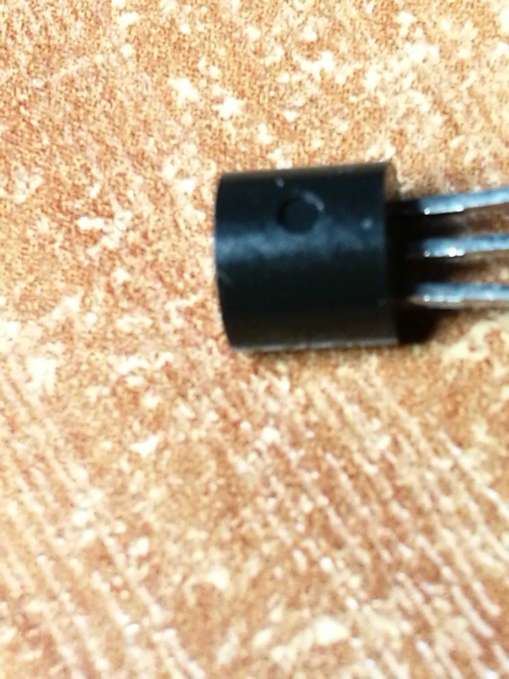

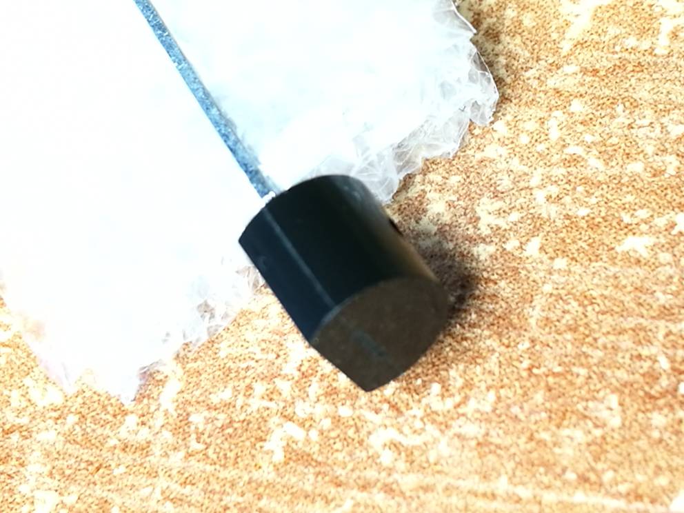

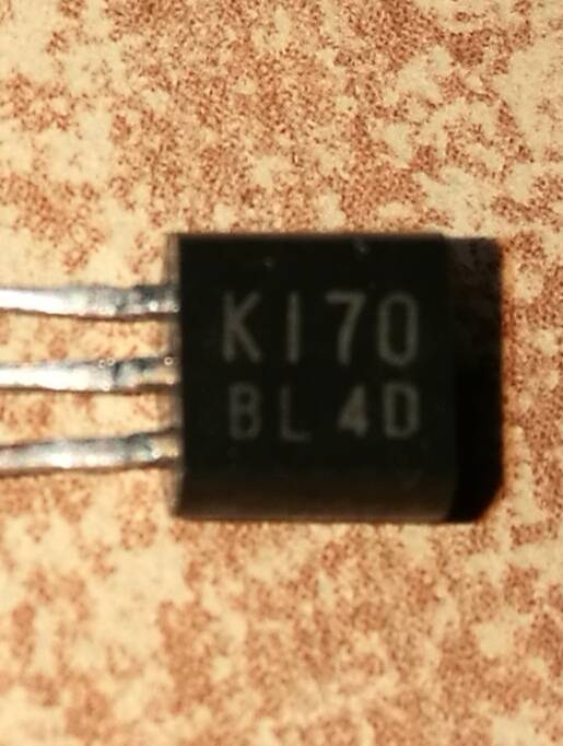

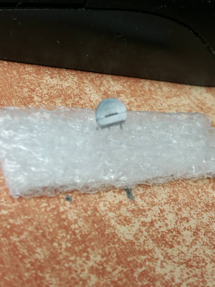

Got a feeling these K170BL are genuine, those leads are corroded thru long storage, unlike my J74 samples, whose leads are shiny ! Supplier says they got those J74 from Shenzhen China.
Here's some close up shots, will build a simple jig for pinch test next week.

I am afaid they are not. Digit 7 should be curvy.

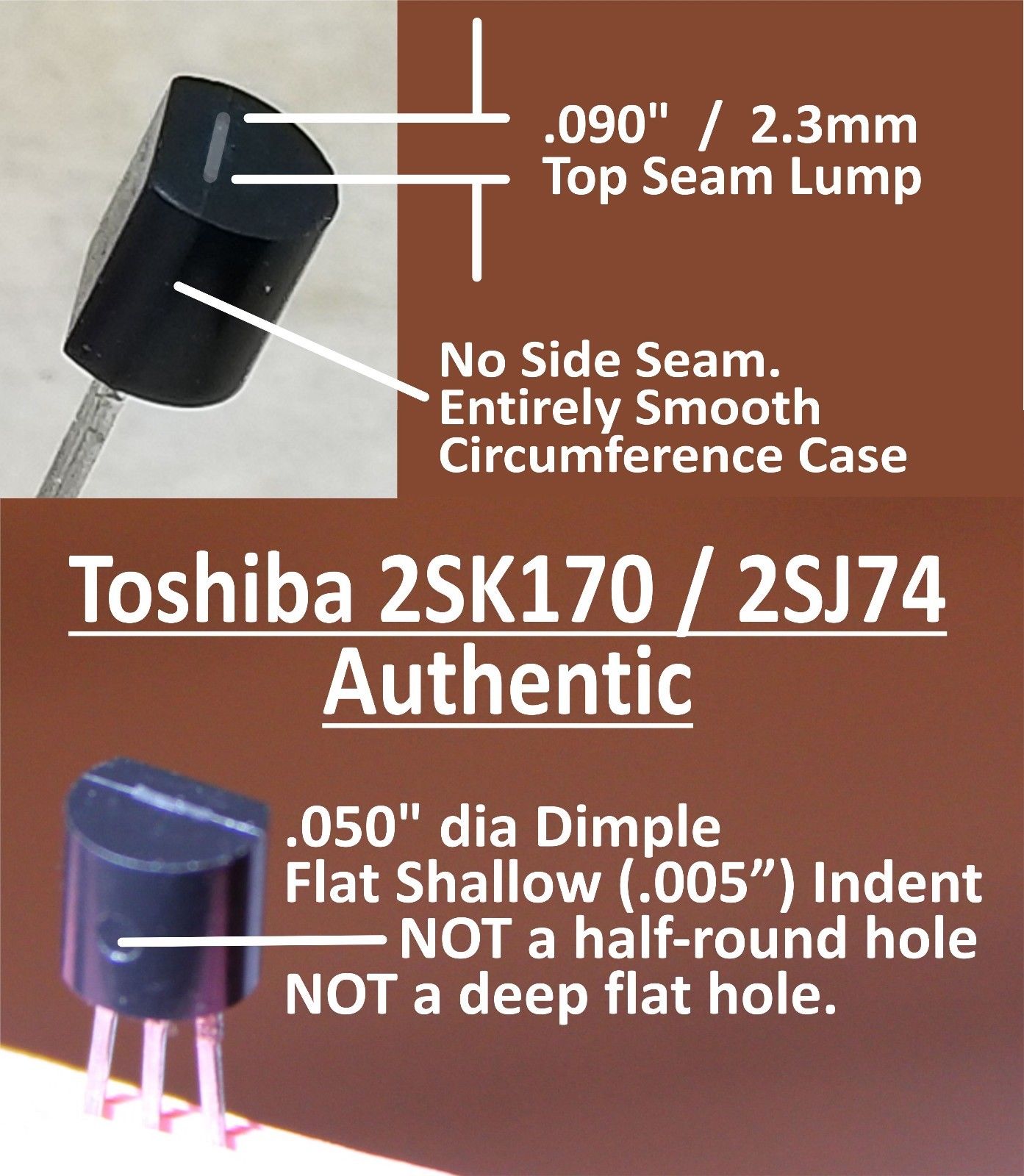

And see what what genuin seller punkydawgs add to his lots:
https://www.diyaudio.com/forums/attachment.php?attachmentid=743639&stc=1&d=1552827894
I'll add my opinion:
@meanie, what set off alarms for me is the '0' looks too round on your devices. They may be jfets that you can use but they won't necessarily be as low noise as genuine Toshiba. Check the seams (I think only the top seam is applicable) and the indentation on the back but electrical tests will be the real indicator. If these are only for your own use then the only opinion that matters is your own but if you plan to resell these I would not try and represent these as genuine if these were mine.

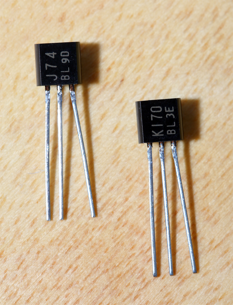

@darr, based on your pictures, your jfets look real to me or at least they look like the ones I bought 12 years ago
Yes Darr, what I see in your pictures looks like Toshiba JFETs all right.
I was also irritated when I read the sides should be seamless. In fact it is just very thin and only barely visible. With the fingertips you can probably not feel it. At least I can’t [emoji106]
