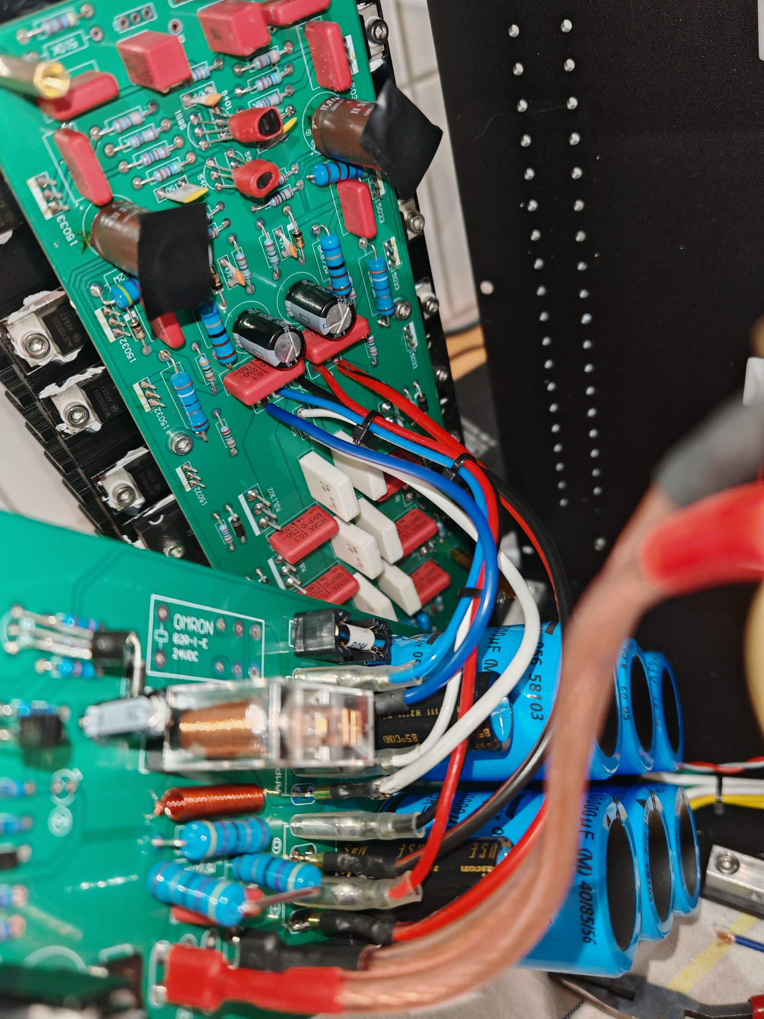

So.... Finally I got some time and energy to go to the first stage of tweaking. I did one channel first, and the next day the second one. First step means just some changes in the power supply and two capacitors on the main board.

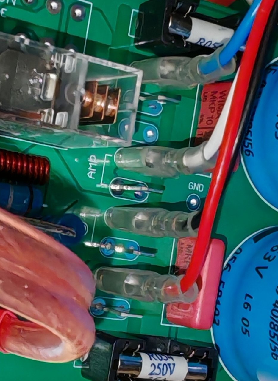

Having a closer look at the power supply board I realized that there is additional space for extra blade terminals:

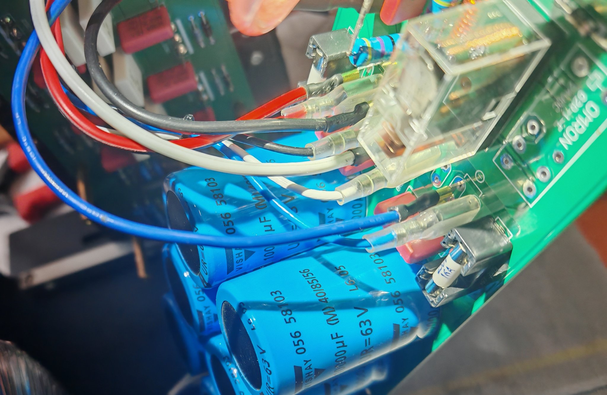

So it is rather easy to add additional wiring to the existing one and so doubling up on wire size from the power supply to the amplifier and also to the speaker outputs. Conveniently there are also solder pads on the amplifier board.

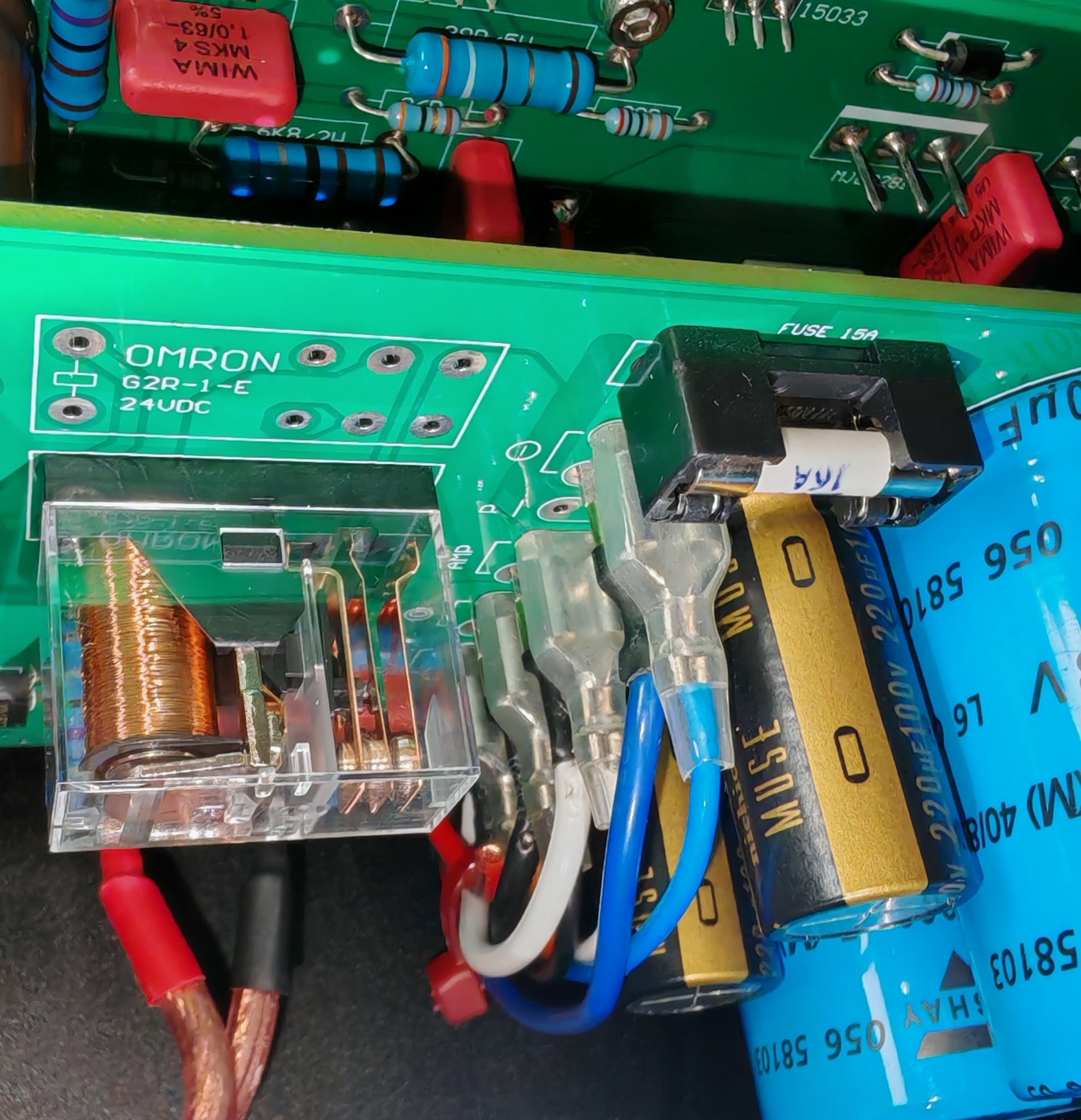

I also added 2 220uf 100V Nichicon KZ to the power supply as Niekos did before.
Then I replaced two 330uf caps with Elna Silmics, they are right at the input transistors, so they should have quite some impact on the sound.
As they are pretty long I put tape on top to avoid some short circuit with the power supply board, but it turned out to be unnecessary later on.

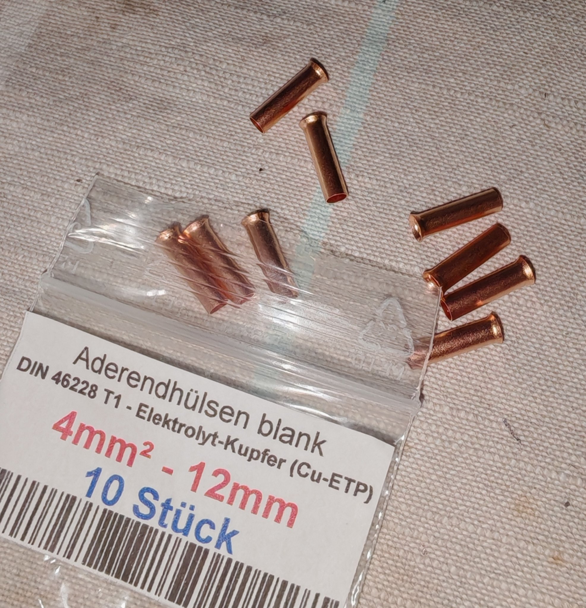

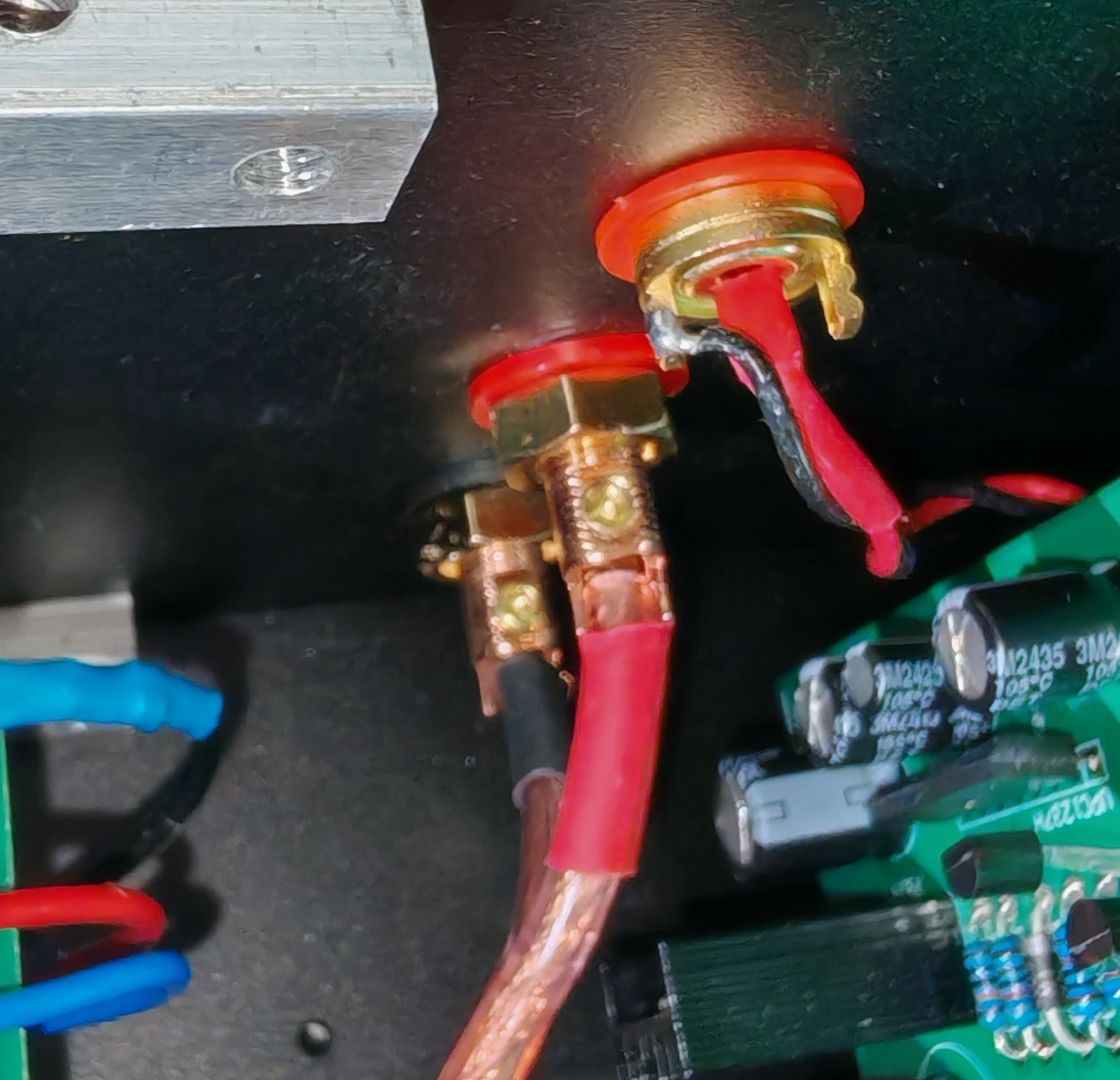

Last step was to use copper end sleeves for the speaker output wire, they are crimped and then firmly screwed down in the speaker terminals. The original brass rings were also crimped by the way, which is always a better connection than soldering.

And on a final note I'm wondering what the purpose of those fuses is. They did nothing to protect the amp of Neiljd, and they are rated for 16A 250V, does that even make sense? I guess I will bypass them, the original amplifier doesn't have them as well.
