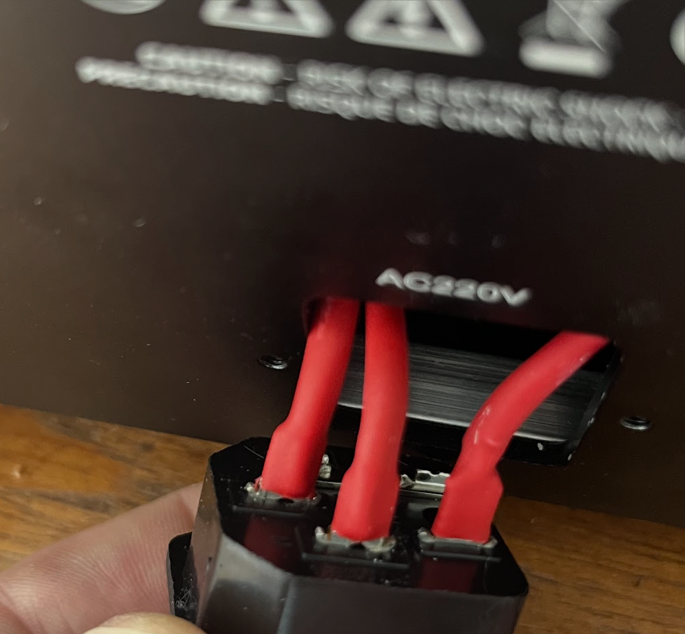

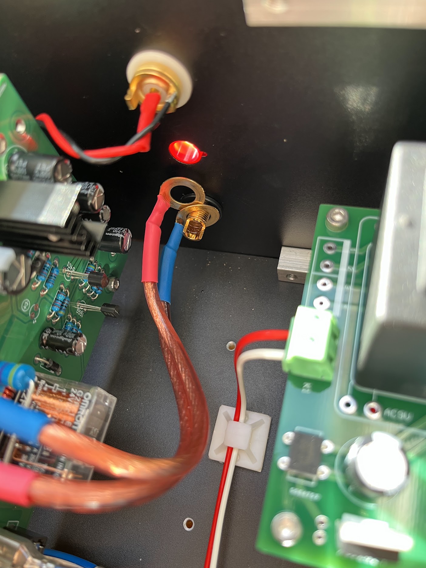

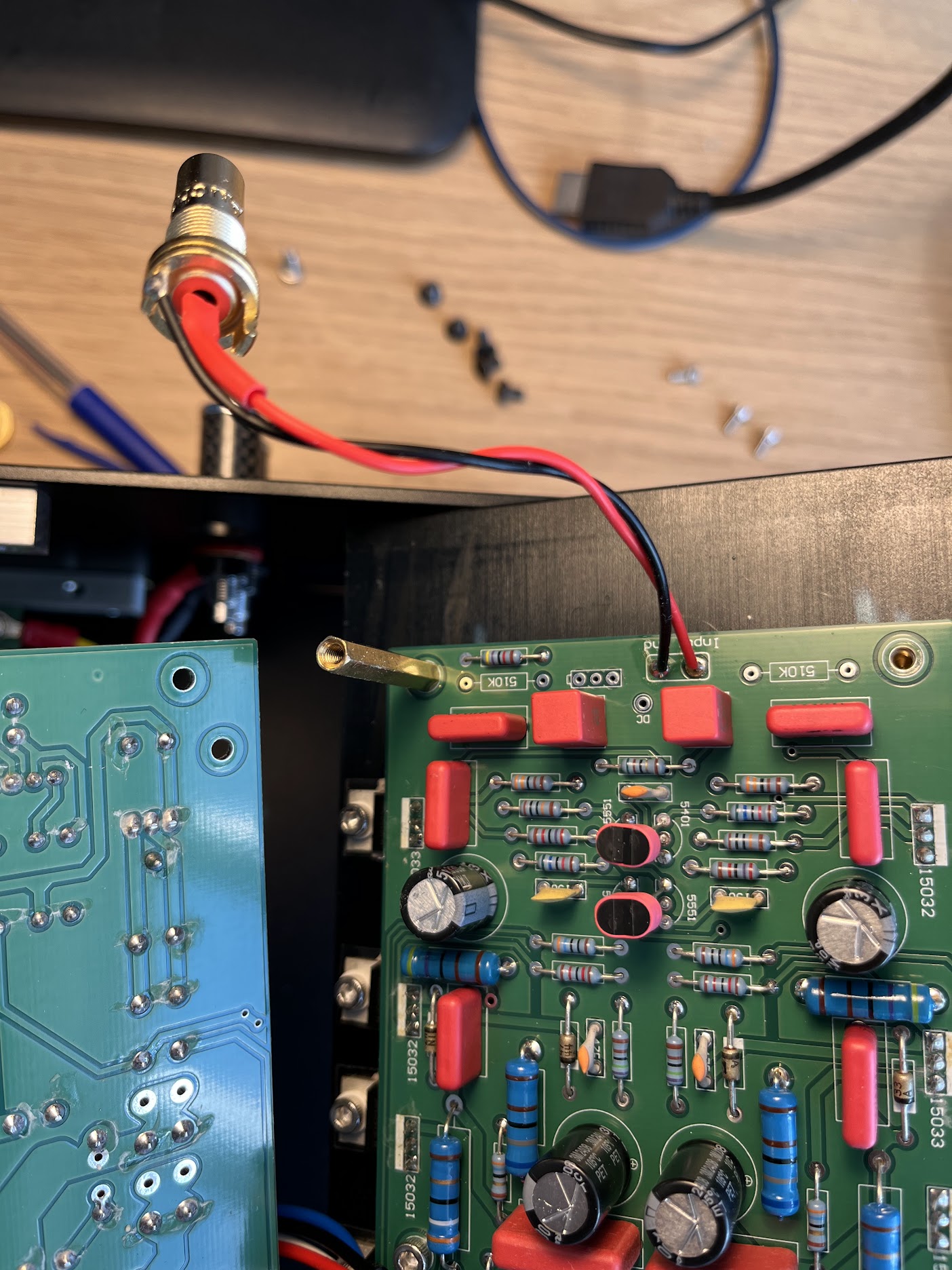

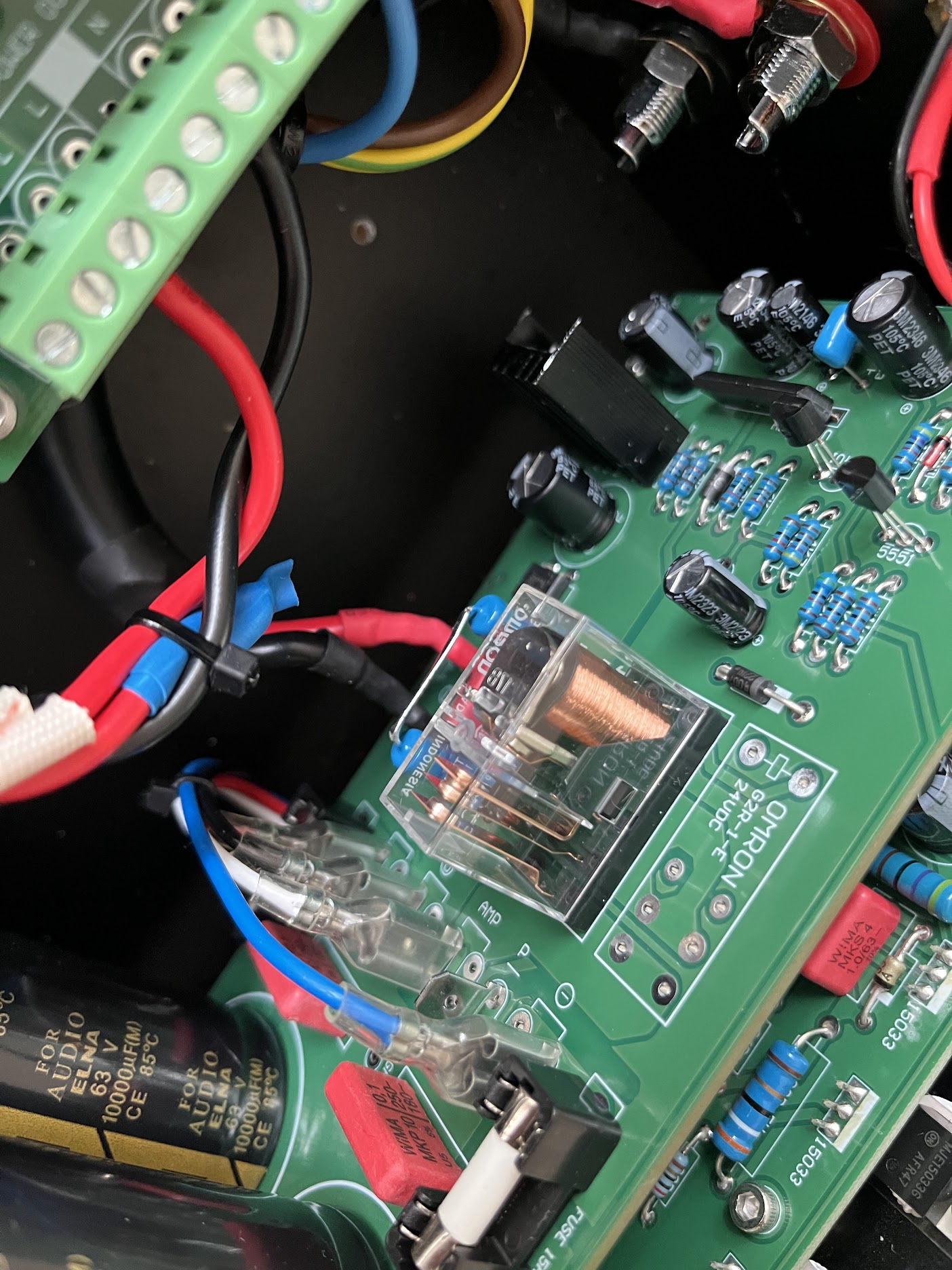

So.... Finally I got some time and energy to go to the first stage of tweaking. I did one channel first, and the next day the second one. First step means just some changes in the power supply and two capacitors on the main board.

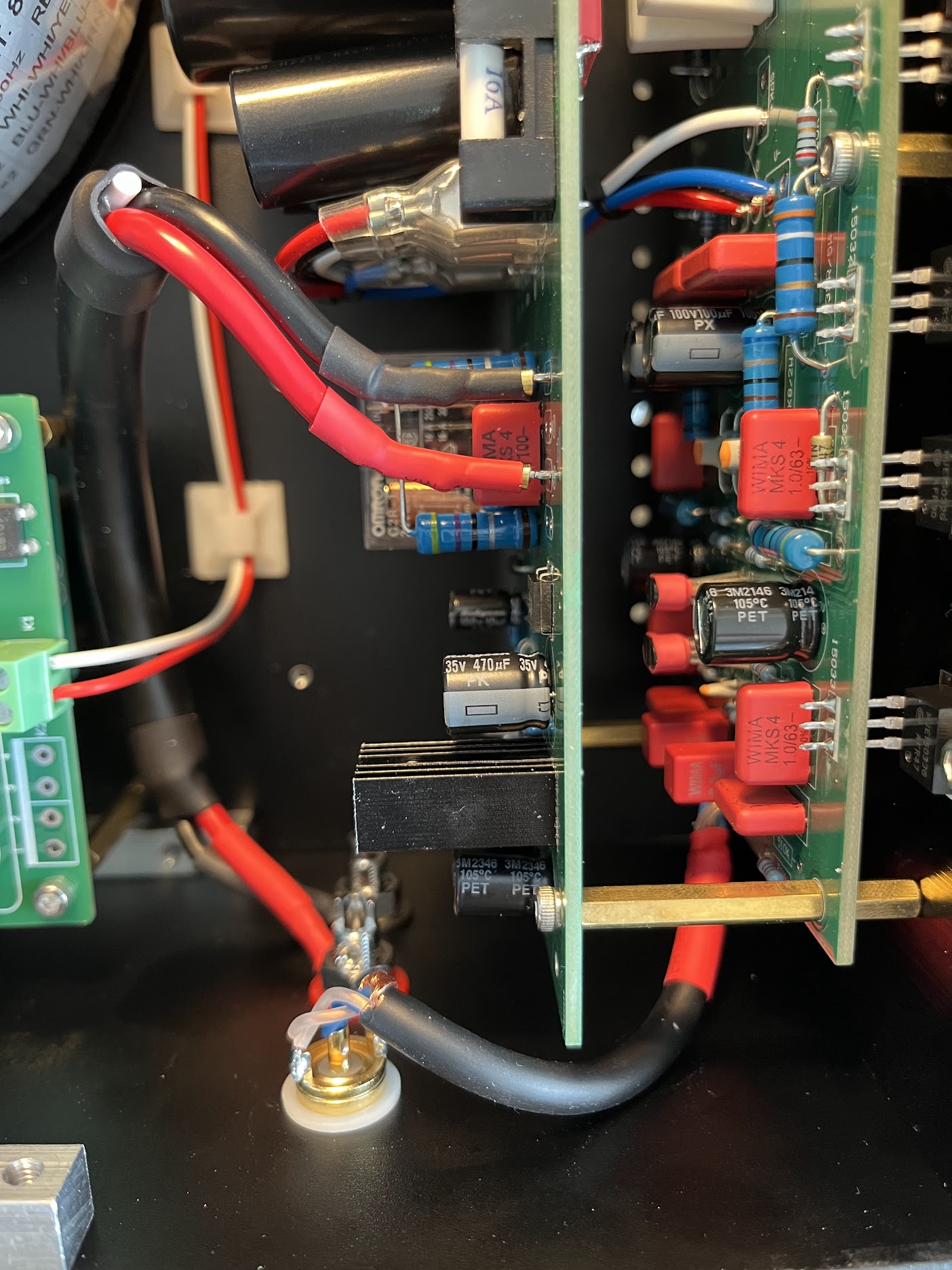

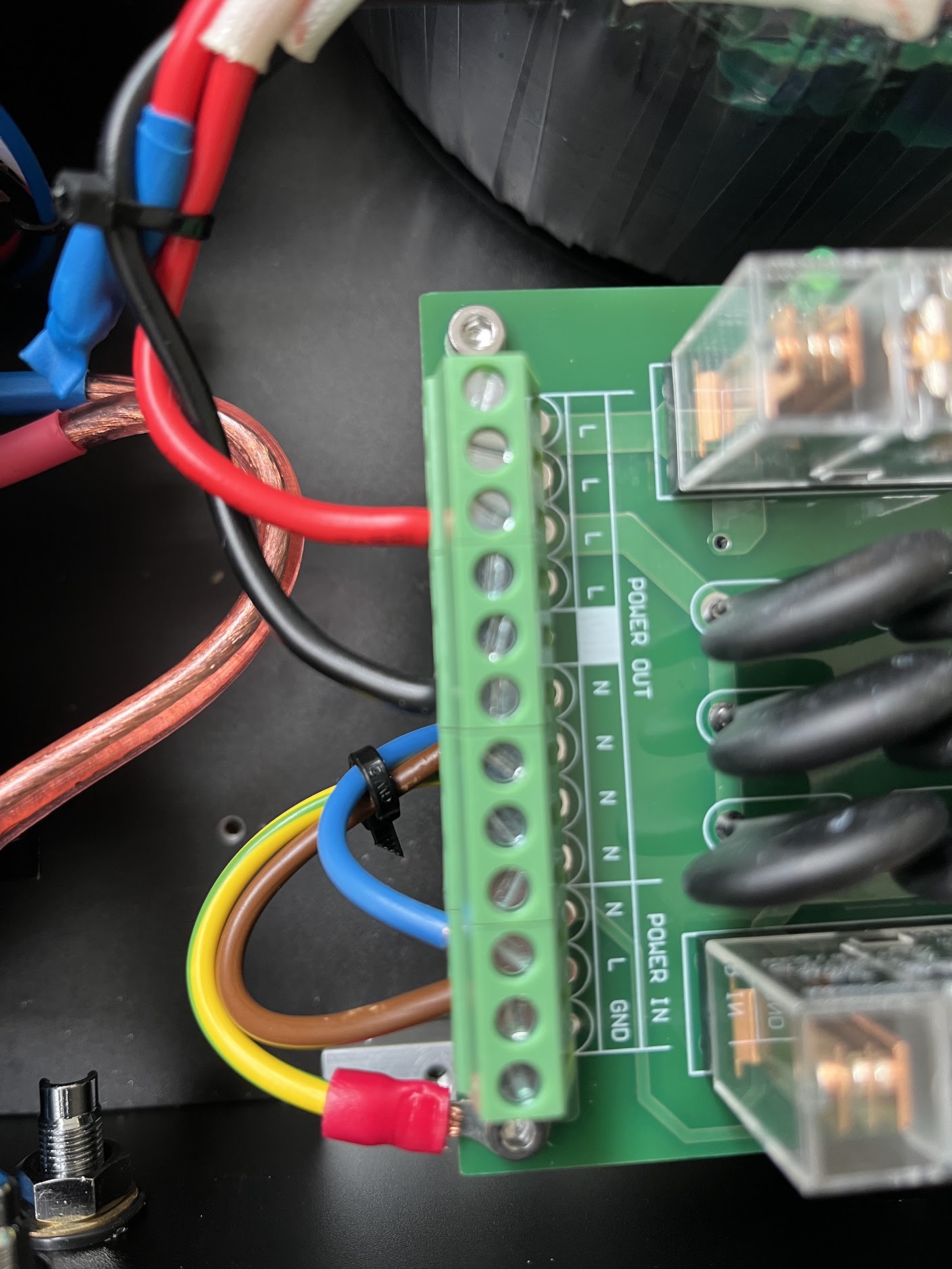

Having a closer look at the power supply board I realized that there is additional space for extra blade terminals:
So it is rather easy to add additional wiring to the existing one and so doubling up on wire size from the power supply to the amplifier and also to the speaker outputs. Conveniently there are also solder pads on the amplifier board.

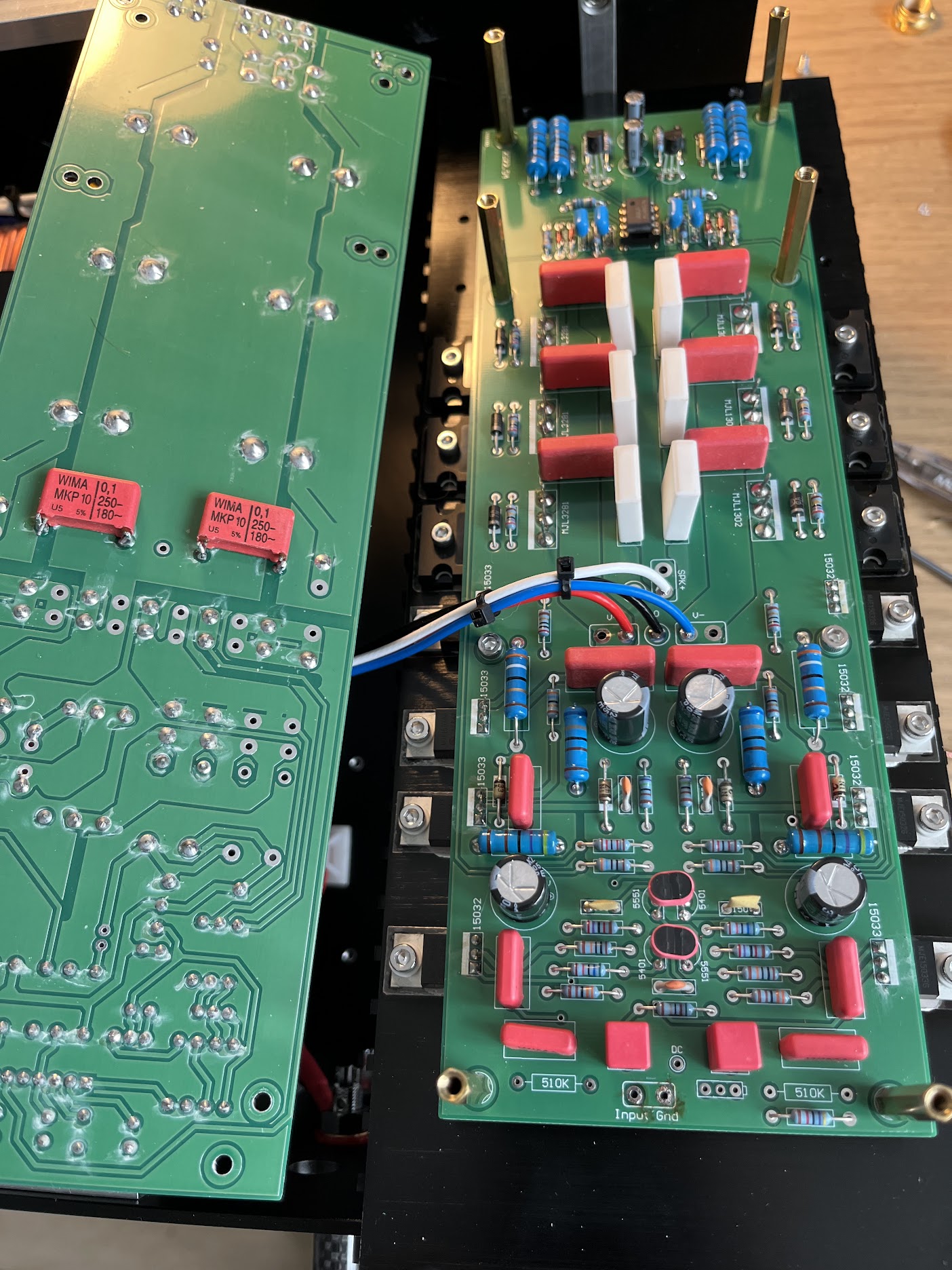

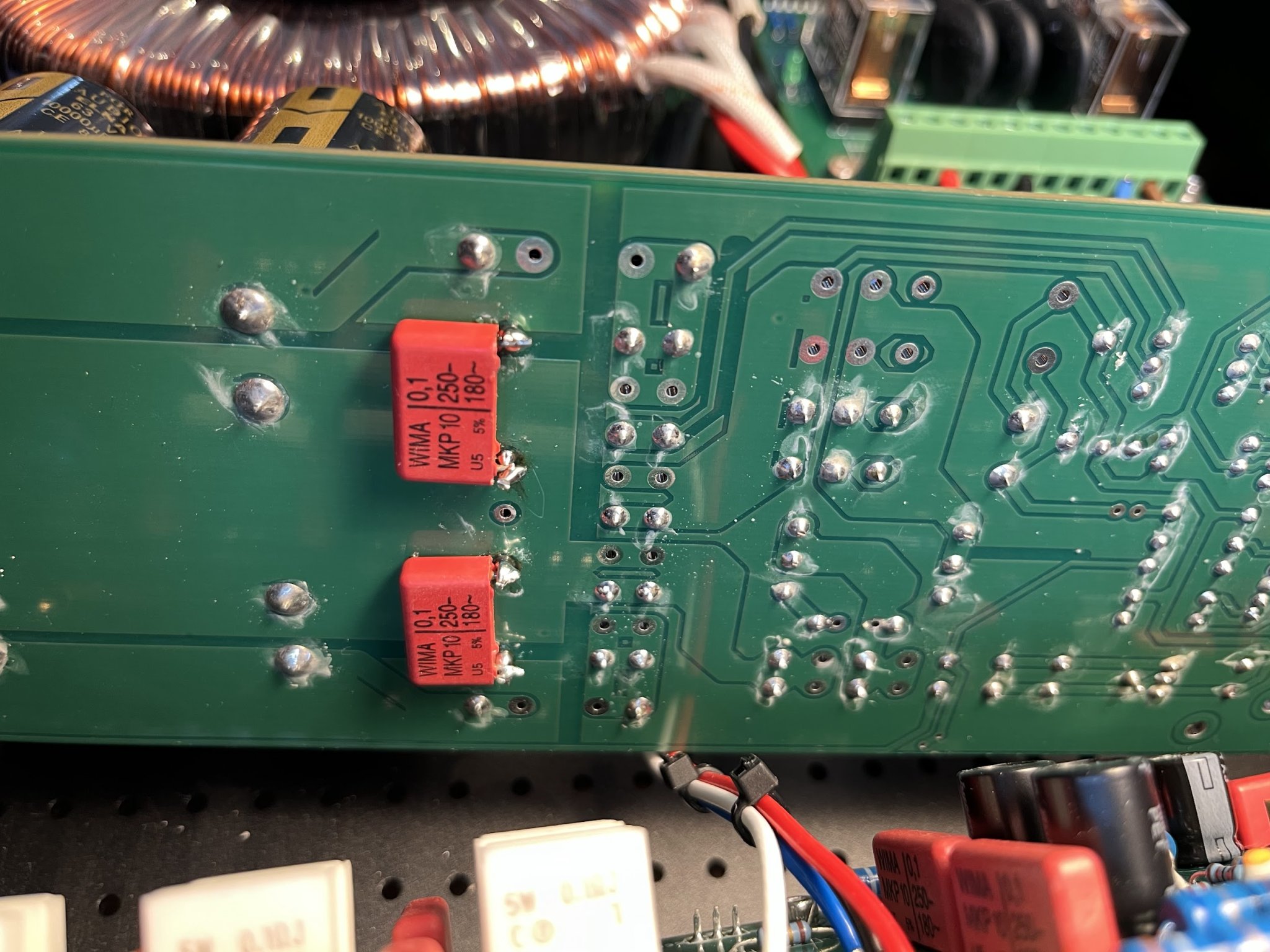

I also added 2 220uf 100V Nichicon KZ to the power supply as Niekos did before.

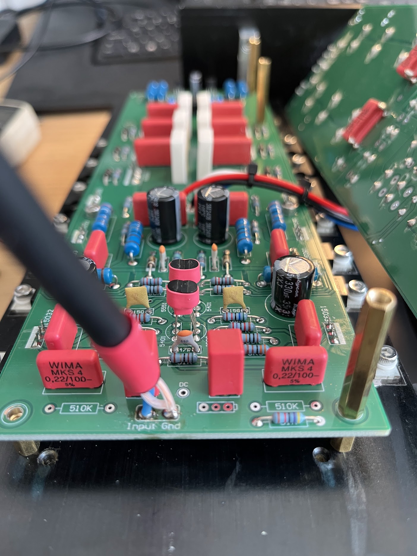

Then I replaced two 330uf caps with Elna Silmics, they are right at the input transistors, so they should have quite some impact on the sound.
As they are pretty long I put tape on top to avoid some short circuit with the power supply board, but it turned out to be unnecessary later on.

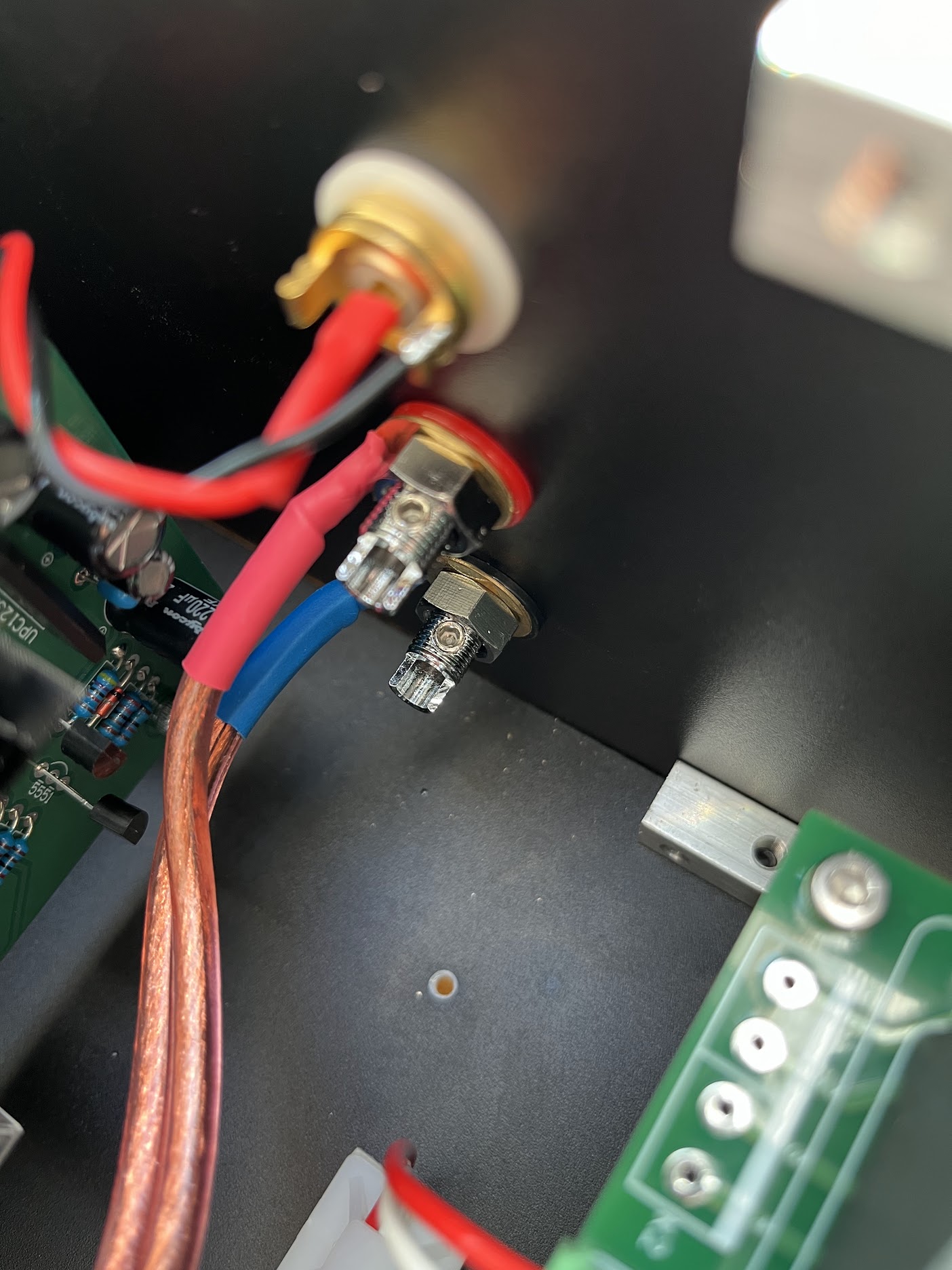

Last step was to use copper end sleeves for the speaker output wire, they are crimped and then firmly screwed down in the speaker terminals. The original brass rings were also crimped by the way, which is always a better connection than soldering.

I guess that the Elna Silmics are responsible for the beautiful tone, it sounds a little darker than before with the tonal balance shifted a little bit towards the lower mid range.
But because I will swap the input caps for the Miflex this will be balanced out again, because those should be far more transparent than the Wima MKS.
But also without changing the input caps I like it much more than without those tweaks. It just fits to the music I'm listening to which is jazz, classical music, experimental and sometimes some Electro. If someone prefers techno or something like that snappier sounding caps could be the ticket for these 330uf.
In any case they have a big impact I'm sure. Don't know about the wires, but the more powerful bass could well be a result of those.
Second step will be then replacing the input caps and resistor.

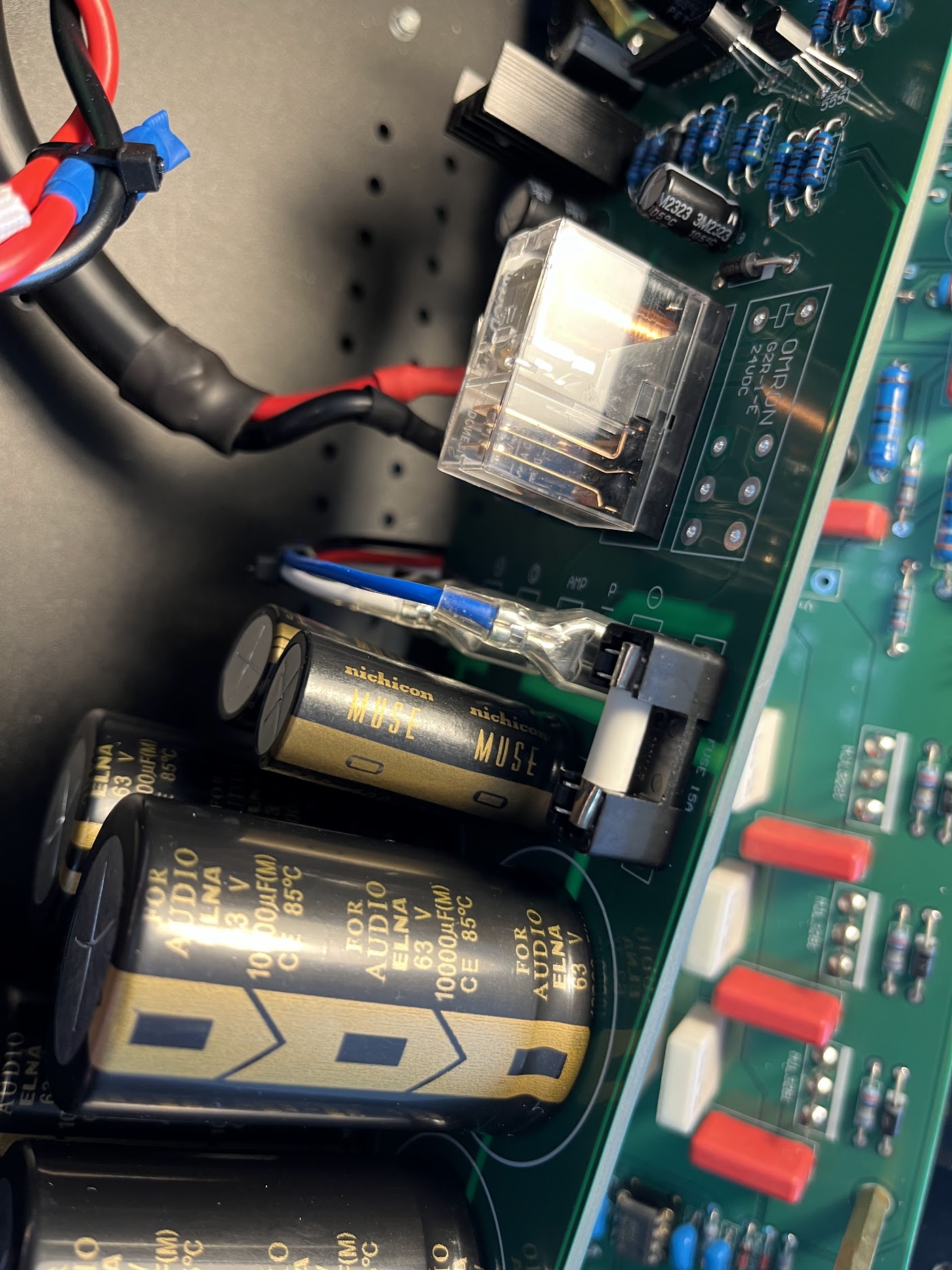

And on a final note I'm wondering what the purpose of those fuses is. They did nothing to protect the amp of Neiljd, and they are rated for 16A 250V, does that even make sense? I guess I will bypass them, the original amplifier doesn't have them as well.
Good idea! I also noticed the extra blades, but did not check to see if these could be used. What kind of wiring did you use?
Good question, but why add them when not needed? It would add to the total cost unnecessarily?

When you placed the Elna caps, did you remove the amp board from the cooling chassis? Did you encounter any problems in doing that?

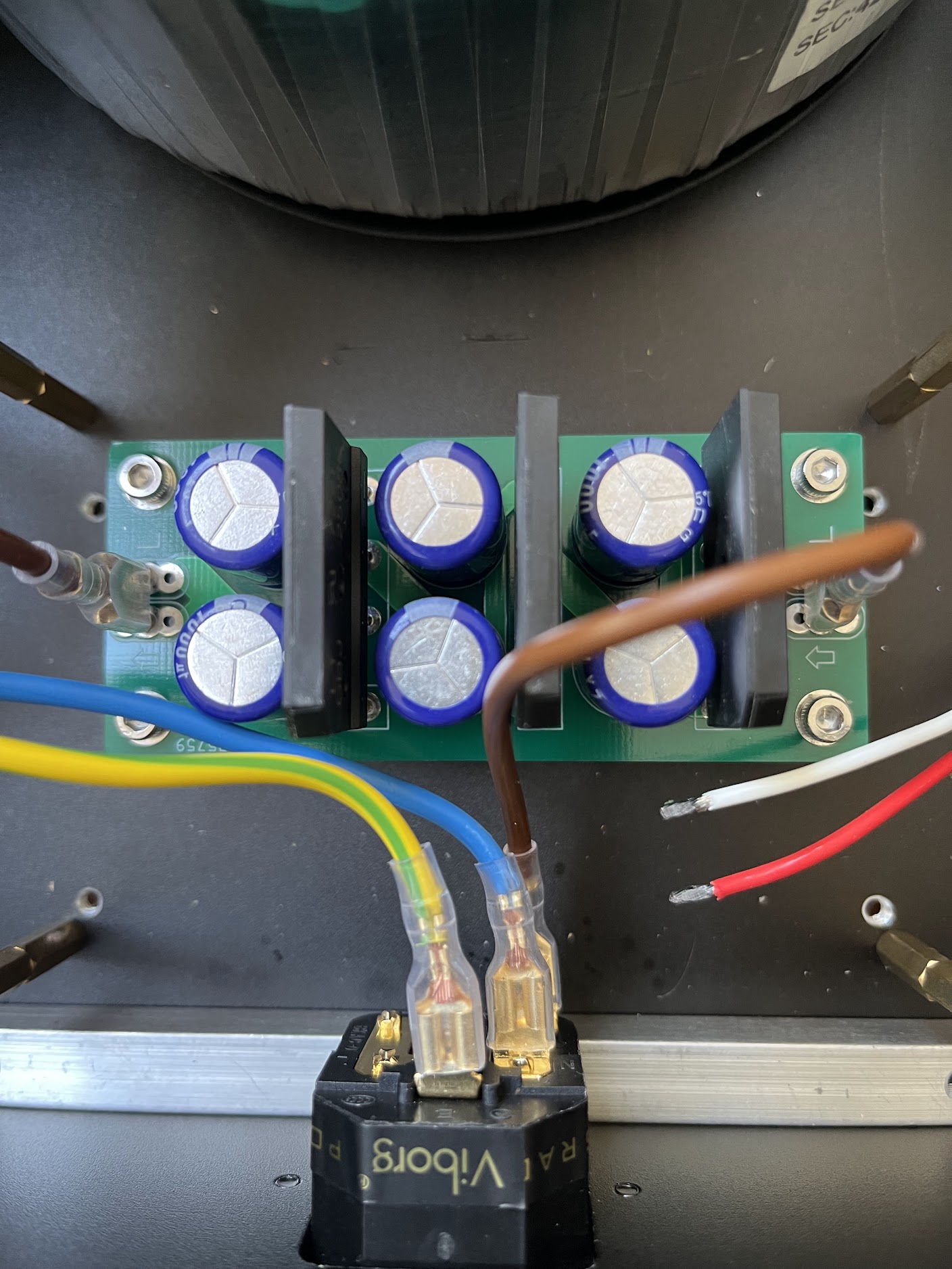

I am in the process of following in Jogi's footsteps - just not sure about those additional 220uF Nichicons though. When it comes to the 51R resistors: in another project I replaced those Zfoils with AN Tantalums and found them tonally more pleasing (less leans?) and those Niobiums are even more "colourful" which I find very pleasing to the ear - and no, I do not find them less transparent.
@ Niekos
I just used plain vanilla 1,5mm² speaker litz wire for 3€ at 10 meters.
Never used those Z foil resistors, from what i read about them they should be very transparent but also a little bit too much on the neutral side for some.
As the amp sounds warmer now they could be an option though. Interestingly it sounds more transparent at the same time by the way.
And for the fuses: the original amplifier doesn't have any protection circuit, so they are not really necessary. The clone has relais for DC protection I assume, should be suffice. And also at 16 ampere my house fuse kicks in anyway.
And I did not remove the amplifier board, because I'm lazy as I mentioned before already. I am reluctant to dismantle the whole amp as the risk of screwing up something is increased a lot. I just pulled the capacitor bodies off, so the legs stayed in and I could desolder them easily and pull them out. Then I soldered the Silmics in from above with a thin solder tip, so there is 5mm space between the caps and the board.

And... Really important to double and triple check, of course I soldered one Nichicon with reversed polarity, would have been a nice firework.
Also make sure that nothing touches the heat sink when things are soldered from above, capacitor legs or wire.
Ah, that is also a way of doing it. I think I will remove the complete board to do all caps, the 0R51 resistor and the Futaba MPC 71 resistors. But not much time the coming weeks, and also I do not have all the parts yet. To be continued!

Those parallel caps are usually used in power supplies, as they reduce ESR und can charge and recharge faster. That doesn't apply for small polyester caps at the input of an amp though.
