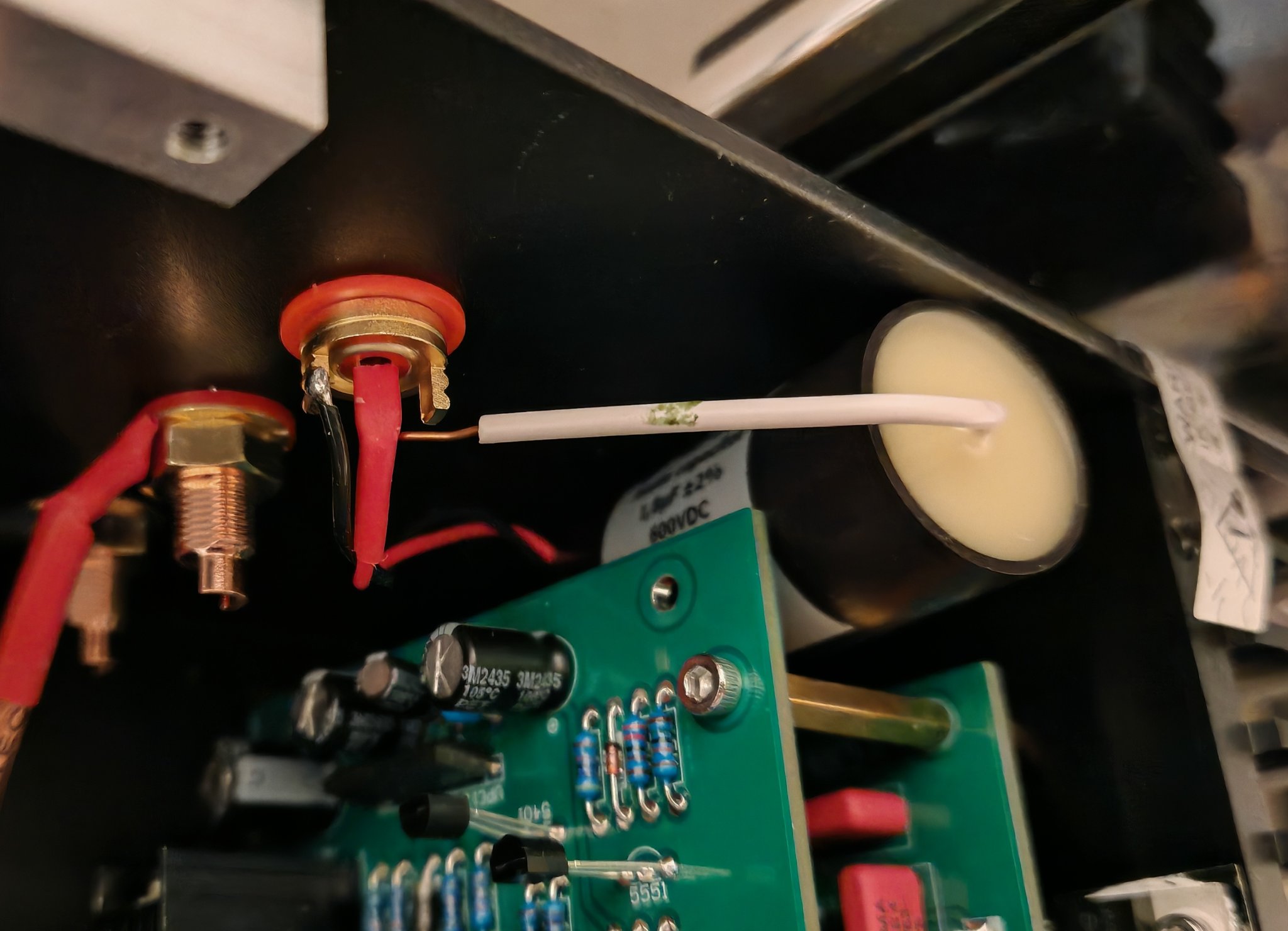

So that's the plan for cap replacement: first removing the back panel, then desoldering the input caps, should be possible without having to unscrew the amplifier board, because the caps are very close to the edge.
Then going directly from the input connector the PCB, as these Miflex MKP10 have long legs like Claudia Schiffer, so the input wires can be left out.
There is a small hole in the PCB where I'll fix the cap with a cable tie.
Hope the picture clarifies how I want to do it:

😀I also like the Miflex, but I have only used the KPCU caps (quite expensive and big, but sound great in my tube preamp and dac). Great idea to do it directly using the legs, should be possible indeed! Looking forward to your results 👍Miflex MKP10 have long legs like Claudia Schiffer,

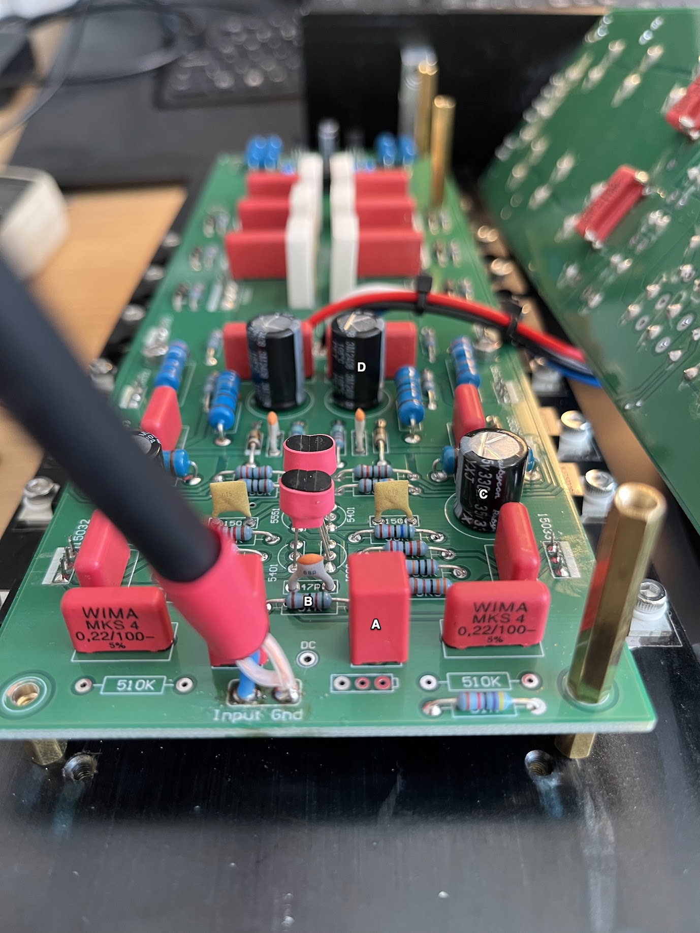

I found the schematic now, and had a look at it as well. And also was wondering if you were to remove the amp board for better access, what would be worth it to replace with better parts?So that's the plan for cap replacement: first removing the back panel, then desoldering the input caps, should be possible without having to unscrew the amplifier board, because the caps are very close to the edge.
Would that be the parts marked with ABCD in the picture below?

If you remove the amplifier board, you can go wild with swopping parts of course.
Then you could tackle the white 0,1R emitter cement resistors; very good replacement are Futaba MPC 71 non magnetic resistors, which are pretty cheap and sound smoother than the simple ones.
And yes, it's number 1 and 2, 3 and 4 should have some impact as well.
