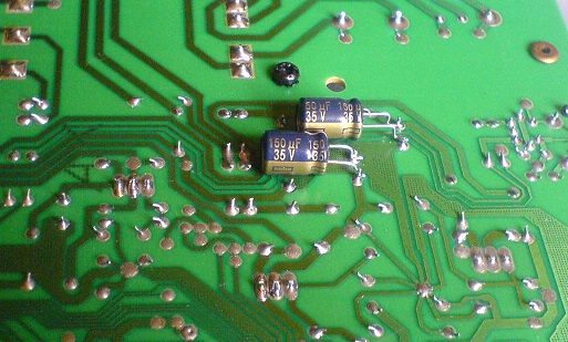

So I’ve done the bypass of C47 & C48 of the Alpha 9 (see attached picture) and it definitely is an improvement! The Alpha 9 and the CD23T are now closer in terms of detail/resolution and soundstage. However, something is still lacking, most notably in the bass which seems more linear and which is deeper and better defined in the CD23T..
Yes I believe some caps don't change the layout and I surmise the CD23T to have a better one and different implementation and active parts; maybe too a different digital filter !
But hey; is it not "formidable" you improve a lot the result with just 2 euros of caps 🙂 !
Are they FM or FC ? It looks like FM ? Could you give me the serie/brand of the main caps which are bypassed (c47/48 on the other side of the pcb) ! You could also swap them by Panasonic FC ! (if your bypass is FM and you believe bass or mid-bass are missing yet : go for the swap of the main C47/48 with FC and/or try too smooth the result with bypassing with FM or add some devill by bypassing with bigger value : around 330 to 470 uf with FC serie !). If your bypass is FC like I advised go further :
If you already bought c44/45 for the swap with FC : try this before modifyng what you just made : but desolder the two bypass to understand what difference c44/c45 are with Panasonic FC !
Step by step is the key, you have to go back to understand what is the better equilibrium ! After understanding if FC is better as well for C44/45 or not : you will again bypass c47/c48 to listen to how it is this time with C44/45 FC !
Only after all of this, try to swap the main c47/48 by FC (and keeping their bypass with FC also or FM if not smooth enough (at the ears) : but FM will rmove some bass and toght mid-bass : choose youir equilibrium by tests !

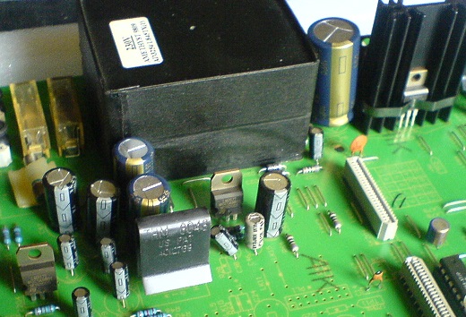

Well I replaced C44, C45 and C36 with Panasonic FC and didn’t remove the bypasses of C47 and C48. Overall sound seems to be slightly improved in terms of resolution/definition, but there’s still a big difference with the CD23T. The CD23T is supposed to be one of the best CDPs out there, so maybe this is just the difference between a good CDP and a top player..
I think I will arrange another CDP, a (single bit) Carver SD/A 360, which I know well and which I like very much, but which used to be outperformed by the Arcam Alhpa 9. If the Alpha 9 is now outperformed by the Carver, I’ll know something is wrong with the Alpha 9..

That's a good news for few bucks your cdplayer is now safe with the swap of the smoothing caps (your first goal)...and you have a little improvement thanks to the 150 uF bypass as well!
You should remove the bypass to listen to the difference (because now you changed the smoothing caps) : step by step.
After replace the Rubycon with FC yet then listen
After replace the 150 uF with the double of this value: around 330 uF (here try FC or FM - both to choose !)
After... stop here !
Don't give up yet : the goal is not to beat the cd23t but here you listen by yourself how the reservoir caps can interact with the supply... Changing the tonal balance can sometimes improve a player by a subjective improvement of some aeras of the frequency curve (it's not about going lower or further, it's more about playing with the actual FR curve of the player): at least this the feeling it gives !
For the moment you just really remove the first smoothing caps and just bypass a little the Rubycon "reservoir" caps !
Of course some caps can't be more important than a different layout with some other active parts and such tweaks have some limits.... but you have a margin yet with the cd9... and this Learning will help you after on the Carver...
Good Luck...
So I removed the 150uF bypasses and it’s actually an improvement! 😕 The alpha9 sounds more balanced and pleasant to listen too. The 'non-linearity' in the (mid) bass is gone and there’s more space around individual voices and instruments. It might sound better than before the cap replacement.. Could it be that the new caps need to 'break in'?
That's a good lesson ! That's why I said : step by step, never more than one change and then a control by ears (always with the same discs!)
It just means the main Panasonic FC has changed the tonal balance, despite the Pi filter for C45/48. Don't forgett too the big 3300 uF ! : you swaped 3 caps !
If you have the courage to do it, you can now swap also the two Rubycon C47/48 by their Panasonic FC equivalent... then try a bypass (again) with a stronger value like I said above !
A Rubycon ZL here could be a candidate as well (darker than a FC and less snapy, a little like a Panasonic FM but less fatiguing most of the time !) for c47/48 ! You could try also a smd bypass with a Panasonic PPS (something around 0.22 to 1 uF on the leads of C47/48...)
This is just a try & errors technic : nothing scientific but sometimes you can get a very pleasant result ! It seems this is maybe what you have here ! The day where you will be happy with your tweak and if few caps are involved, you can go back to the original conf to benchmarck the best tweak tou keeped with the stock player (it will cost you some soldering and time, but you will be sure ! At least you have also your cd29t as a benchmark !).
