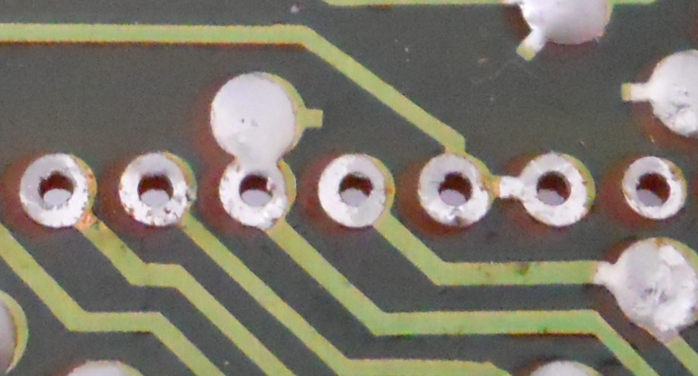

By the way, when I disassembled the Alpha 9 to get out the main PCB, I noticed that most of the screws that fasten the main PCB where loose.. 😕 Could that possibly have been a problem in terms of internal rigidity and fibrations altering the sound?
