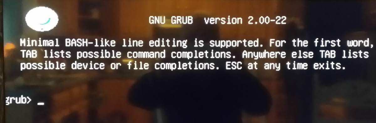

All the talk about PC convolution, along with a helpful jump start from BYRTT, has moved me to try the JRiver route....
yesterday, I got a JR ID to run a 6 channel FIR filter, using the same FIR files I use in openDRC boxes, but converted to wav.
The ID is an Intel NUC running linux, that can be used as a standalone media computer, or a DLNA renderer or server. It can be run headless and controlled by phone.
I've been using it solely for 2 channel playback, either inside at home letting my Win 10 desktop stream to it, or when outdoors, as a standalone media computer.
In case you haven't seen it..JRiver Id
I really like the small silent form factor of the NUC, and the idea that ALL it is ever used for is playing media and convolution.
It would be great if convolution fully pans out.......
The ID's Performance reporting said the cpu was running 10x faster than real time, processing 6 threads of 6144 taps at 48 kHz. So it looks like there is room for the additional taps to handle lower frequency needs. And there are always faster NUCs if needed.
I can already see the lack of flexibility vs the openDRCs is an issue, as is how to use the ID with other signal sources....such as REW test sweeps.
But it's very encouraging so far...

jriver linux (or mac) doesn't support any form of audio line in atm, which is a rather annoying gap, so you would need to use REW having exported it's sweep measurement as a wav and then selected that for playback by jriver. I think you then have to manually press "measure" on your REW machine at the right time in order to get a valid measurement. Is the id a general purpose linux machine or does it just run jriver? I thought it was the latter.
Yes, it's the "Ultimate Couch Potato Mode", tho I can never remember its real name. It' something you do once, then it always works. From the local computer running JRiver you control another instance running on a remote computer, and the interface is exactly the same. There are few tweaky things you cannot do remotely, but they aren't day to day needs. I used remote desktop to do tweaks.BYRTT Didnt knew that jriver has the possibility to control Jriver from one computer to another - thought it involved teamviever etc.
Now with the new JR id, which I've never seen before (thanks Mark!) it should be even easier. It's a very cool step forward.

BYRTT, the ID has a WDM checkbox where you said to look, but my bet is 3lld00d is right about a no go.
3lld00d, I think it just runs jriver, with maybe some very limited general capability.
Tried seeing what startup options are available prior to jriver loading....this is what I got...means nothing to me 😕
