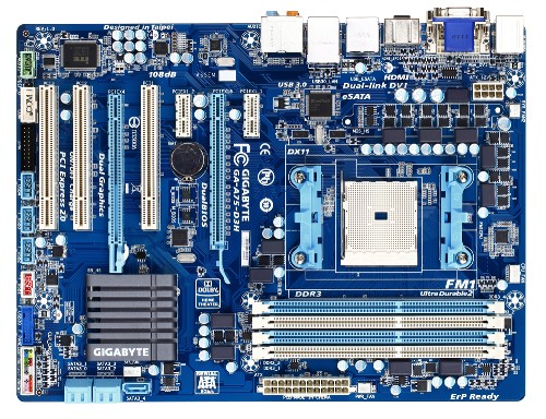

Agree tips by Laotzu1 and Pano, also if you on a desktop one can change priority electric hardware routes. Example my dedicated audio PC that run on low cost AMD platform (Liano APU A8-3870) have normal prioty electric routes turn upside down. All onboard hardware turned off to free IRQ's and memory is only one 4Gb module in single mode because think sound is better than running dual mode by two modules on this particular platform. Dirty jobs is moved to electric route via chipset south-bridge that is VGA GT720 (8xPcie) physical have a 4xPcie electric slot and a special PCI USB3 card for mouse/keybord and flash disks and OS HDD is down here too. Then have 3 free Pcie slots with direct electric route to CPU where normal VGA would have been mounted, at those three run network adapter for streaming and a AHCI controller for dedicated audio HDD's and a Renesas USB3 controller for USB audio device or pull that USB3 controller out if a dedicated Pcie audio device is used. Below you see MB the three Pcie slots at right (two x1slot and one x16 slot) have direct electric route to CPU the other slot's goes via chipset south bridge. Setup in this way is probably not nessasery but worked pretty good for this platform, on the fly can tick convolution engine and IRR filters in JRiver on/off to compare sound before/after without any crackling. Also have no problems let program TrueRTA build in signal generator send square waves via JRiver virtual sound device/Jriver DSP/Hardware sound device-DAC/AMP/Speakers/microphone back to TrueRTA oscilloscope presentation.
