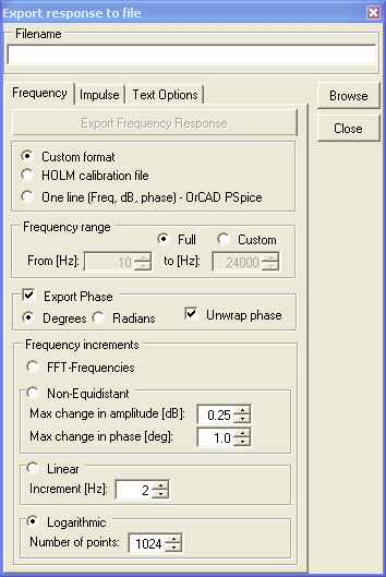

What format files can be imported to rePhase in measurement import?
I had txt file frequency, magnitude, phase separated with "," decimal separator is ".", but only frequency and magnitude are imported to rePhase, no phase data. Fail is exported from HolmImpulse. Phase export settings in HolmImpulse are Degrees and Unwrap phase. I tested also Unwrap phase not selected, same result, no phase imported to rePhase.
Use a space as the separator. No header. Choose "unwrap phase" in the export dialog.
Works fine for me. See below. Also attached is a sample text file from HOLM that should work for rePhase
