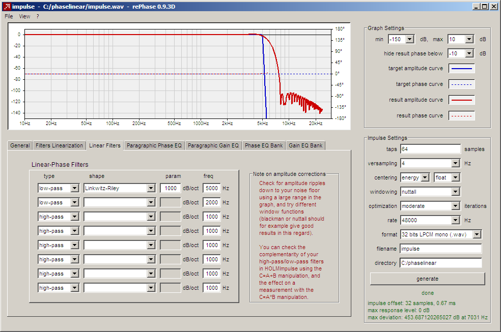

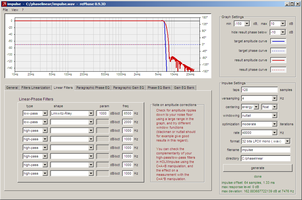

Which problems, specifically? I'm familiar with the motivation for apodizing filters but my experience is subjective audio quality tends to be dominated by the impulse ringing introduced by the filter. Since the Fourier relation mandates an abrupt transition in the frequency domain is a slow one in the time domain brickwall is often a worst case choice in this regard---it's my experience a more even tradeoff of frequency and time domain behavior sounds better. Upsampling from 44.1 mitigates the issue but requires caution as most sample rate conversion defaults to brickwall antialiasing (miniDSP is unlikely to document their implementation on the miniSHARC---someone'll have to get one and measure it---but Analog's ASRC implementations are all brickwall so I'd expect miniDSP's to also be brickwal), as do the majority of DACs. So adding a third brickwall in one's own filtering is an interesting choice.
You would agree that to do the downsampling, for example from 48khz to 16khz, you first have to remove any frequency above the Nyquist frequency of the targeted sampling freq.
So you first have to apply a LP filter that reject anything above 8khz low enough (lets say -100dB), and then take 1 sample out of 3.
I said "brickwall", but of course with the shortest possible impulse it will end up much more like a gentle filter 🙂 (but this will reduce the usable range).
Here are two examples of such filters, generated with rephase for a 48khz initial sampling freq, targeting a -100dB rejection at 8khz.
They were generated by trial and error
First example is with a 128 taps LP filter, and you get a usable range up to 6khz.
Good enough if you are planning to use a 48dB/oct LP at 2000Hz for example, as it end up "brickwall" (and possibly ringing) or at least steeper than expected -80dB down the target slope (albeit this could also be taken into account with EQ...).
Now with a 64 taps LP filter, the slope is more gentle and you end up with a usable band up to 5khz.
With the same -80dB target you can do a 48dB/oct LP at ~1500Hz.

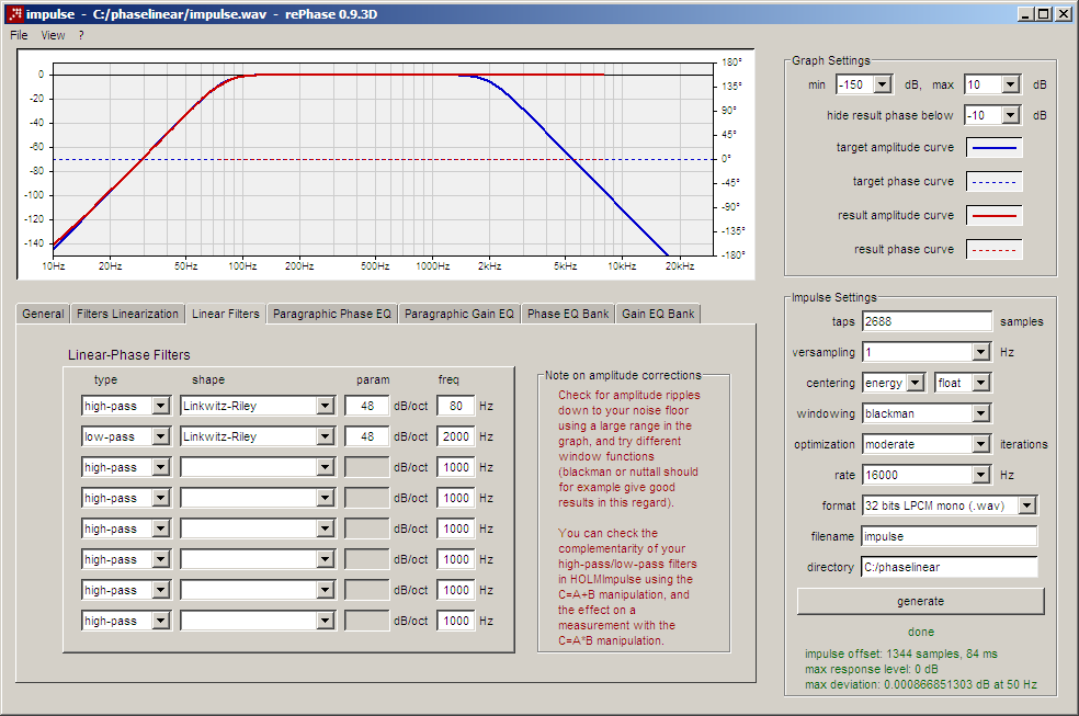

Now with the first example (128 taps), lets calculate the available power that would get us. Lets pretend we have 1024 taps available at 48khz, and just count naively for the sake of an example.
After that first 128taps convolution we might have 896 taps "left".
After the filter you get 1 sample out of 3 and do the convolution on that.
So for each sample you have 3 times the processing time: 896 => 2688.
And then we are applying the convolution on a 16khz signal, so we have basically the same filtering capabilities than if we had 3 times the taps at 48khz (8064 taps, that is!).
That means that be can for example do a 48dB/oct HP filter at 80Hz without a stretch:
The final implied delay with direct convolution will be 1.33ms for the initial 128taps filter + 84ms for the 2688taps@16khz linear-phase filter.
So the overhead is only 1.33ms (and half that with th 64 taps scenario), nothing compared to an FFT based convolution...
If you add the possibility of freely assigning the taps accross channels I think any real world 8-way crossover could be generated with a single miniSHARC and direct convolution...

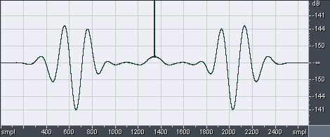

I use rePhase for creating linear phase Linkwitz-Riley 48dB/oct 80Hz high/low pass filters for crossover, sample rate 16kHz and 2688 taps. These I import into Cool Edit for inspection. Summation of filters produces ripple in tails:
This is completely avoidable if high pass filters are all derived from low pass counterpart via single sample inversion (subtractive filter).
