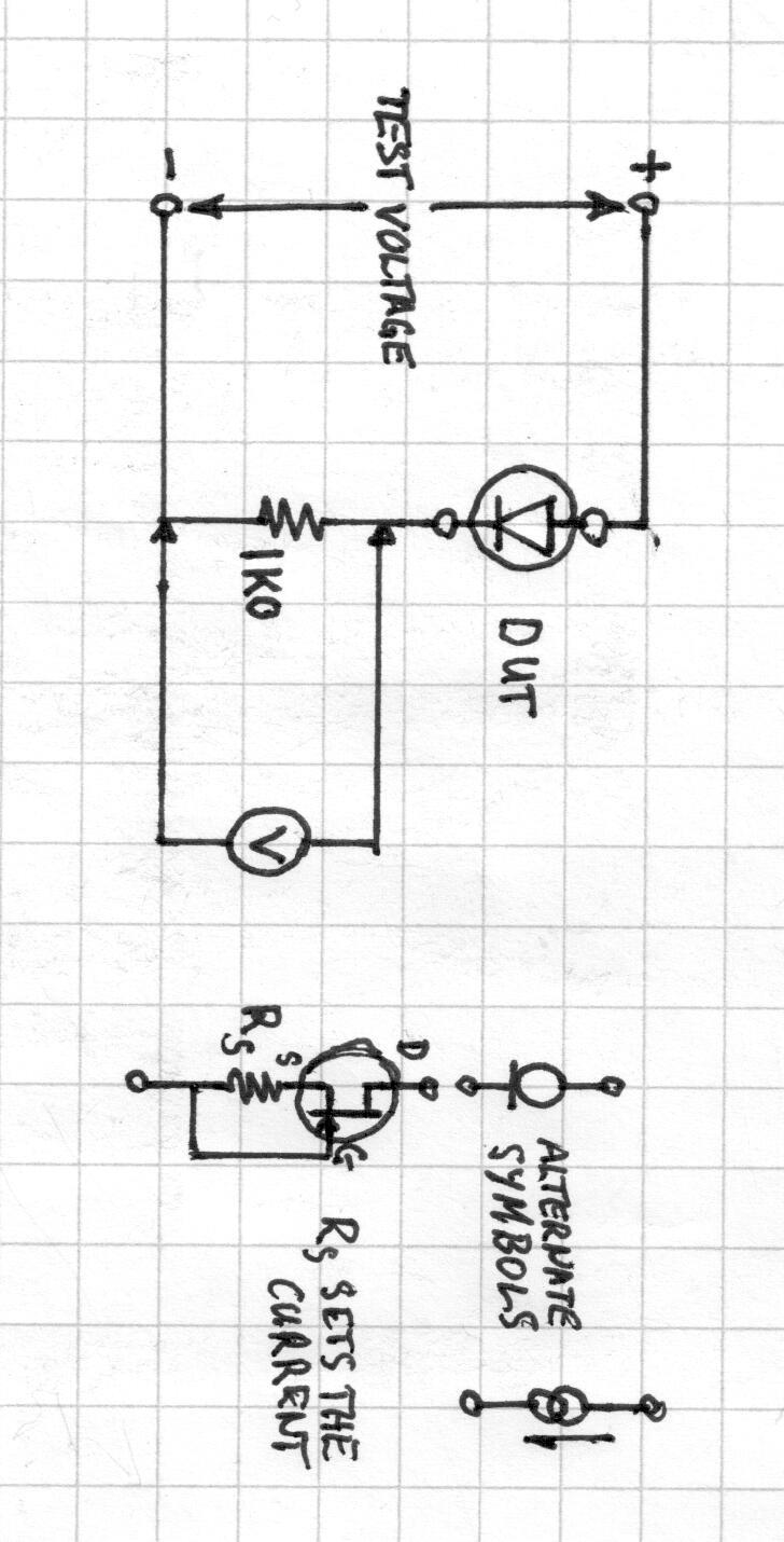

Hi jahsavage,
Just test each current diode, one at a time. Use something like an accurate 1K0 resistor to run the current through and measure the voltage drop, 1 V = 1 mA. This should be more accurate than your current function in your meter.
Most current diodes have a tolerance of 10%, 5% for the more accurate ones. Current diodes are difficult to damage unless too high a voltage is dropped across them. Most are rated for 50 VDC, the other range is 100 VDC devices. So for replacement you can opt for 100 VDC devices with a 5% tolerance.
The next option would be the Microchip DN2540N3 (TO-92 case). These are good for 400 VDC drop, so zero worries. They are D-Mosfets, so you can easily create a two terminal current source. I use them often enough that way. You can set your current up pretty accurately through these. You simply make a test setup that allows you to place a resistor in series with the source lead, the gate connects at the "bottom". You measure the current the same way as above and your new power supply becomes useful again. By adjusting the resistor value, you adjust the current that will flow. It really is that easy. I used a 1 K pot and simply adjusted to the right current, then used a resistor to get the same value of current. You can put resistors in parallel to get a closer value if you feel better about it. Once set these are very stable. I happen to use surface mount resistors mounted directly on the component leads. Works like a charm.
So, step #1. Measure the current with the existing diodes. If you test backwards, they will conduct like a diode, so ramp up your power supply while watching the voltage drop across the 1K0 resistor. Don't turn it up too high.
These diodes were available with currents ranging from 0.1 mA up to 20 mA or so. I would expect yours to run above 1 mA and probably lower than 10 mA. They used two in parallel to increase the current while keeping the temperature in the diodes low to keep the temperature lower than what would create too much heat in the diodes.
If you need, someone can draw this out for you. I can tomorrow if you let us know.
-Chris

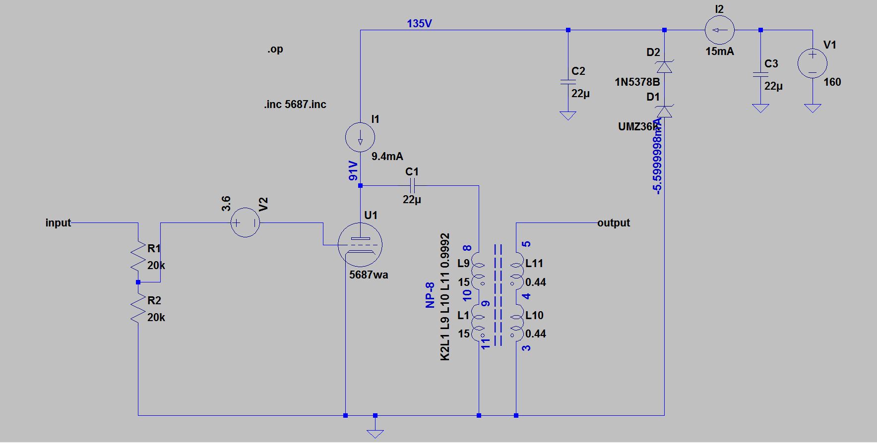

Further speculation
OK, one thing is clear: this design works close to the edge, which probably explains why it failed.
We are still missing the value of the raw dc voltage but this is not so critical for analysis.
The issue comes from the relatively high B+ and the limited maximum voltage of the current diodes. These seem to be limited to either 100v or 50v depending on nominal current.
Looking first at the plate loads, a sensible value for the op point seems to be 10mA which can easily be obtained from 2 parallel 4.7mA current diodes (1N5314). The tube will then operate at -3.6v, 9.4mA, 91v.
The CRDs for the shunt regulator are more problematic because they need to provide a sufficient current through the zeners. I think 5mA is an absolute minimum but this will depend upon the particular chosen device. Problem is that above 4.7mA i have been unable to locate any axial devices that could withstand a 100v; these appear to be limited to either 30v or 50v (Semitec).
So, the raw dc supply should not exceed 137v by much. 160-170v seems to be a safe limit. It cannot also be too close to 137v as a 10% mains fluctuation could render the raw dc below the zener regulation.
It is easy to see how the unit failed. If the plate voltage gets applied by connecting the umbilical of the powered external PS there will be a brief but deadly instant in which the decoupling 22uF will apply the entire raw voltage across the CRDs of the shunt regulator. If these fail by shorting they will bring zeners and other crds with them.
So, safe operation relies on the slow ramping of the tube rectifier output.
Hi analog_sa,
You are correct. I completely agree with your failure analysis.
Hi jahsavage,
In order to upgrade this preamp, I would recommend using the DN2540N5, which is a TO-220 package and can have a heat sink attached. The 400 VDC breakdown and the few watts of dissipation would probably cut the needed devices down to one per channel while also making it a reliable design. I'm surprised that there aren't zener diodes across the current diodes for protection to keep the diodes from shorting.
I can draw the test circuit larger in case you need. Does this give you enough information to test your own D-Mosfets (DN2540N5)?
Best, Chris
