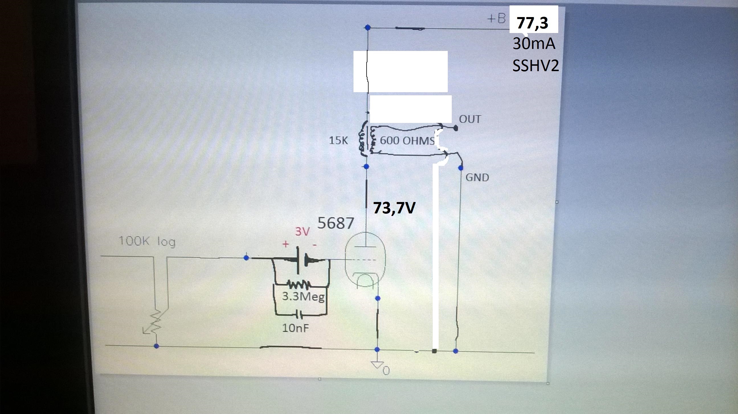

Yups just missed. I used the attached schemati, only change -3.3V in place of -3V at grid.

I meant the transformer will be safe, if connected to the anode without a cap because of the current source. Obviously the anode will not stay at 90v after such a connection.
Draw you badly the schematic?
What's the purpose of OPT having the output coupling capacitor?
To stop dc flowing through the transformer.

If the capacitor wasn't there, the plate voltage of the tube would be very low and performance wouldn't be good. Also, the core of the transformer would have a large DC component which would shove the operating point up into a very non-linear portion of the B-H curve.

Yes, it is a matching transformer from the load the tube wants to see down to the impedance of the speaker.

Apart from a few resistors used for the LED supplies there are none in the audio path or inductor's (excluding transformers). The small transformers in the preamp are used for balanced input and output and do not feature if just rca input and outputs are used.Hi merlin,
I would believe that if I could see a resistor in the ground return to generate that bias voltage. It's probably there and is simply missing as an error in the schematic.
A corrected schematic would be nice so we don't have to guess at things.
