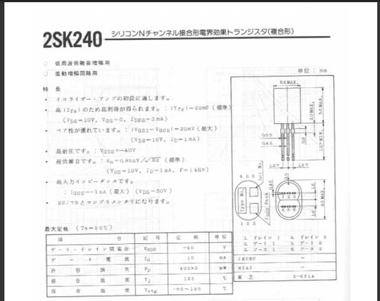

1. What will be the approximate VDS of this input excellent 2SK240 dual monolitic pair?
It`s not monolithic, just matched pair, not more exciting than 2x2SK170 (but not less excellent either).
Lumba.
Thanks. Yes, 2SK240 is 2 separate transistors.
Was the sheet below tht fooled me.
Probably only shows how to use two 2SK240 for close temp matching.

Hi m2003br,
A 2SK240 is in fact two 2SK170 bonded in a aluminium shell.
I still have a couple 2SK240s. They are two transistors tightly bonded together, TO-92 case style in an aluminum casing. I wouldn't be surprised if these were a pair of 2SK170 transistors, but I'm not about to crack one open to look.
I have seen these go noisy in some cases, which is why I have some left over.
