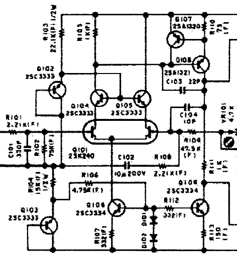

kilowattski said:Since it is a Nelson Pass design .....
Nakamichi P7 looks like having a voltage gain of ~20.
Thr input 2SK240 pair works 1mA each.
😕 Can not figure out the cascoding arangement ....
One 2SC3333 used as a backwards attached diode is connected to GND.
One 22k1 resistor feads the cascoding pair 2SC3333.
1. What will be the approximate VDS of this input excellent 2SK240 dual monolitic pair?
2. Is this Drain-Source voltage dependent of hoe much base current is supply to cascoding 2SC3333?
The input could very well be a Nelson Pass idea.
Probably it is 😎
Is it being used as a 5 or 6V zener ?
Naah.
I can only think that the diagram of amplifier is not correctly drawn.
Maybe Nelson Pass could give us some clarifying, if he reads this.
The thing is, there is another one biasing the diode string of the two current sources on the -ve rail. Someone makes the same mistake twice 😕 😕 , or is it a deliberate attempt to confuse us
q102 acts like between 7v to 8 v zener.
1. so the 2sk240 jfets are at roughly 6v to 7v drain to source.
2. not to the first order
mlloyd1
mlloyd1

not a mistake or confusion
that one helps reduce impacts of negative rail voltage modulation on the current in the diodes (which contribute to the reference voltage for constant current sinks).
hmmm ... i suppose that was a very long-winded way of saying it improves the negative power supply rejection ratio.
