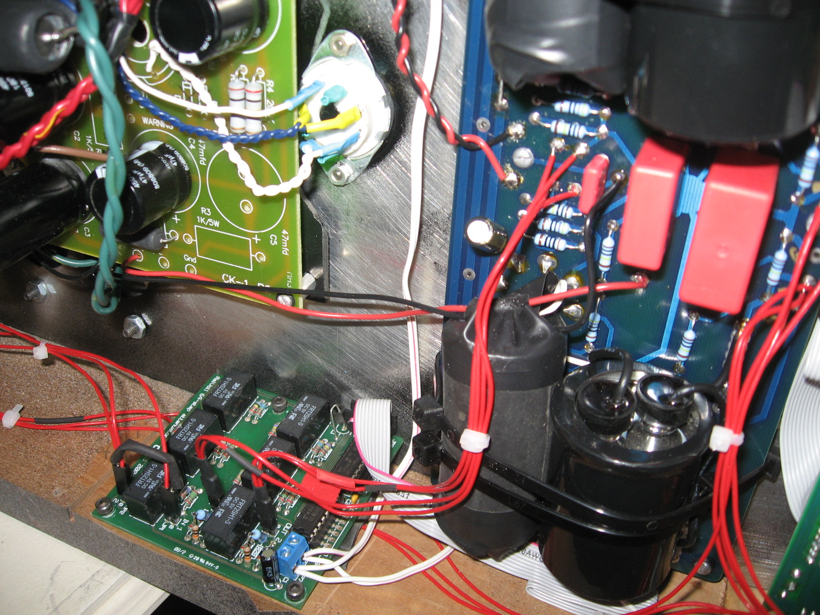

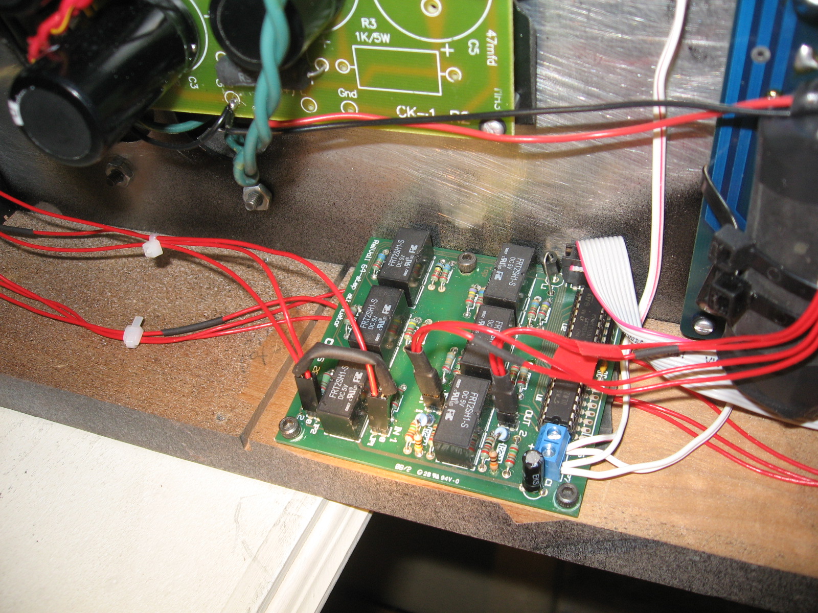

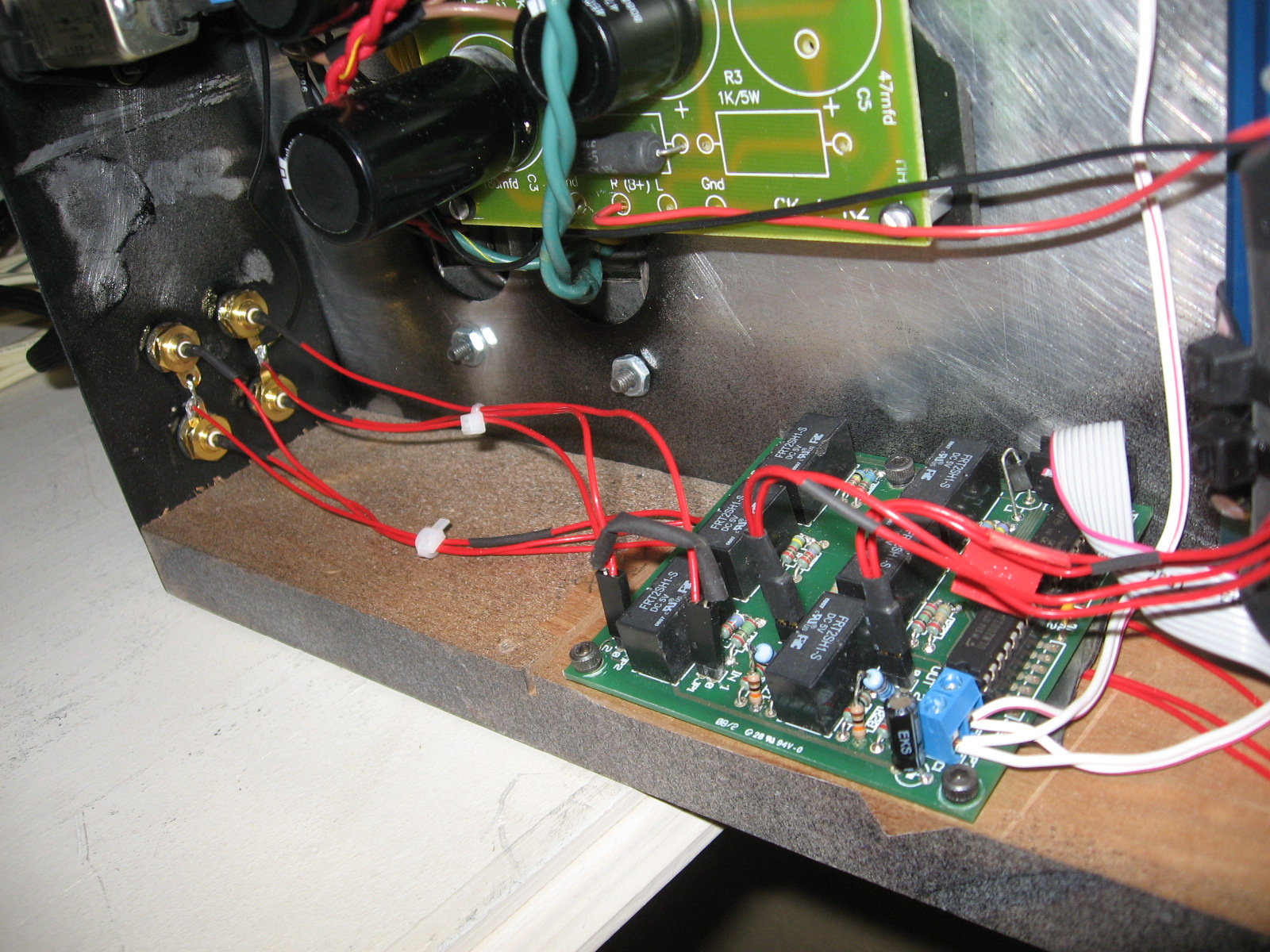

Did you wire the RelVol1C BEFORE the Aikido input? Yes? If you wired it after then that's the problem.... 🙂
Here's the pics.
RCA inputs are on the top near the metal plate (right side in the photo)
Outputs are from the Aikido capacitor selector.
We'll make it work ................or burn it trying!
