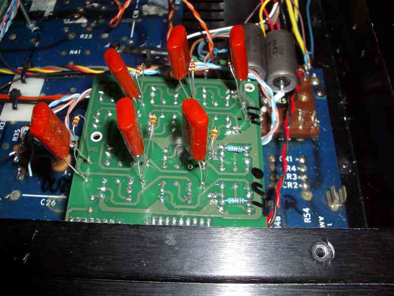

Oh, mine too is mounted on a preamp, please, help me to reach zero sound output, just to have a problem less 😱
Piero7,
Ok, I found the manual, Do you have the RElVol1 or RelVol1C board?
What is the value of your imput resistors? R28 & R29?
What is the input impedance of the linestage (preamp) after the attenuator board?
Changing the R28 &R29 values will change the total amount of attenuation.
I thought it was a jumper, but that was another board I had built.
I remembered wrong. Sorry.
I'm using an Aikido 6sn7 tube preamp with 100K impedance.
Don't forget that when this board turns on it doesn't start at the highest level of attenuation -63 but at -53, a midway point about 1/4volume.
I hope this helps, I can measure my resistors in R28 and R29 if needed.
I have to take my preamp apart to do it. Why I haven't done it yet. 🙂
Ron
Yo, mine is the RelVol1C, and I have for r28&r29 111K due my Aikido with E800CC is 1mega drid resistors
Nope, I get no volume zero even changing these two res and the grid resistors from 1M to 100K and adding 11K for r27&r28 🙁 Argh!!!

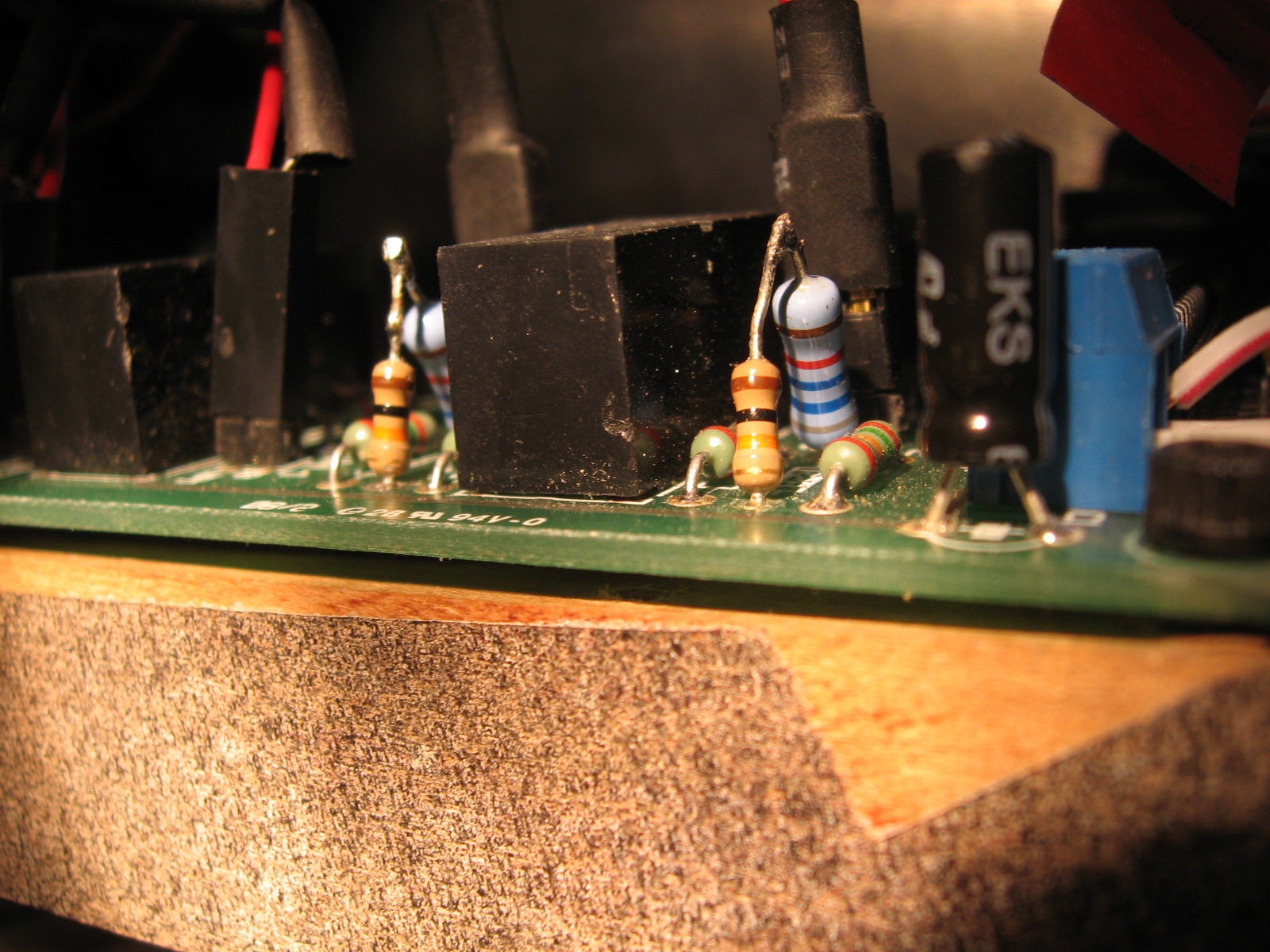

Looking at my R27 & R28 I come up with 126M + 100K in series for each of the "Load Resistors".....? That doesn't sound right to me, but it's whats in there. Picture from my board. I don't remember exactly what I did to get those #s but I do know that I had to change them a few times to get the volume to adjust correctly. It has been a while since I built my Aikido.
What is the MU of you preamp? I thought mine was high at ~21MU.
Your tubes are E800CC right? Are they similar to the 12AU7? If so then the expected MU is ~ 17 -18MU.
Don't change the Grid stop resistors in the Aikido! Change the load resistors in the ReVol1C. Try a 100M resistor.
It doesn't sound right but that's what I ended up with.
Ron
