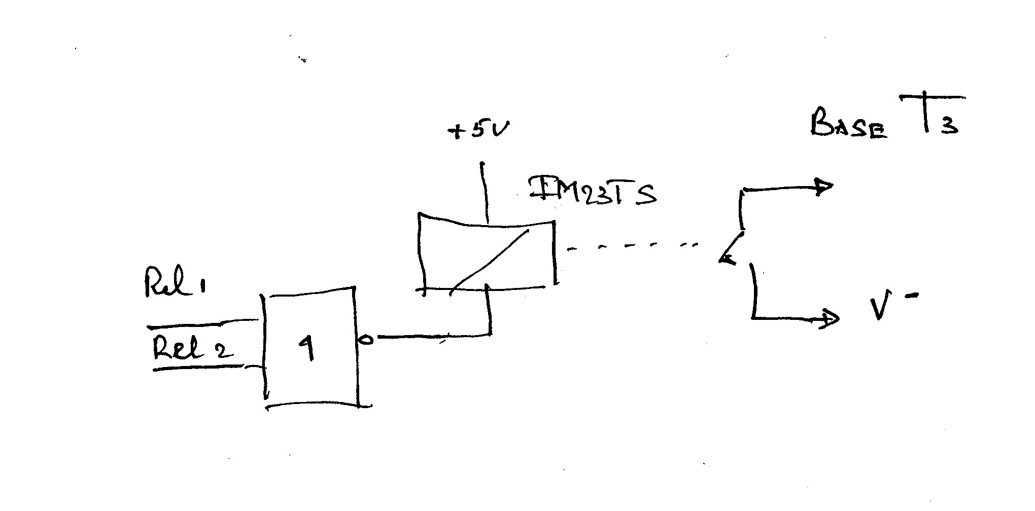

Correction
It should not be a NOR but a NAND.

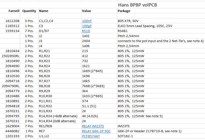

Does anyone know a better source for the thin film resistors for Hans VolPCB in Europe. I managed to assemble below from Farnell, but some values need a series of 2 as original value is NA and the inner geek would of course rather have all resistors from same manufacturer as well.
This project has ended up being a bit of a chase of 'perfect implementation' so getting the right resistors would fit the overall logic.

What is your problem with the values of the thin film resistors?
51.1, 1K33, 1K69, 7K68 are all available from Farnell.
And yes 4K should be 4K02.

Ergo, if you can get an order of 60 euro or so together, Mouser has it all and cheaper than Farnell normally.

I'm ordering parts and can't head nor tail of the following "RS1D RS481". I can see it's a diode but that case designation comes up with nothing, does anyone have a part number, or even better a full BOM from Mouser?

RS1D is the name of the part and RS481 is the shape of the housing.
Hans
RS481 doesn't appear to be any kind of smt part package designation according to mouser, farnell or google.
An actual manufacturers part number would be a huge help here.

Here is an example for RS481
http://www.farnell.com/datasheets/32250.pdf?_ga=1.33413690.56940285.1447157221
But a DO214 package is also OK.
Hans
I ordered the G6k-2p instead of the correct footprint g6k-2p-y. This should be ok with a little massaging to get the pins to fit?

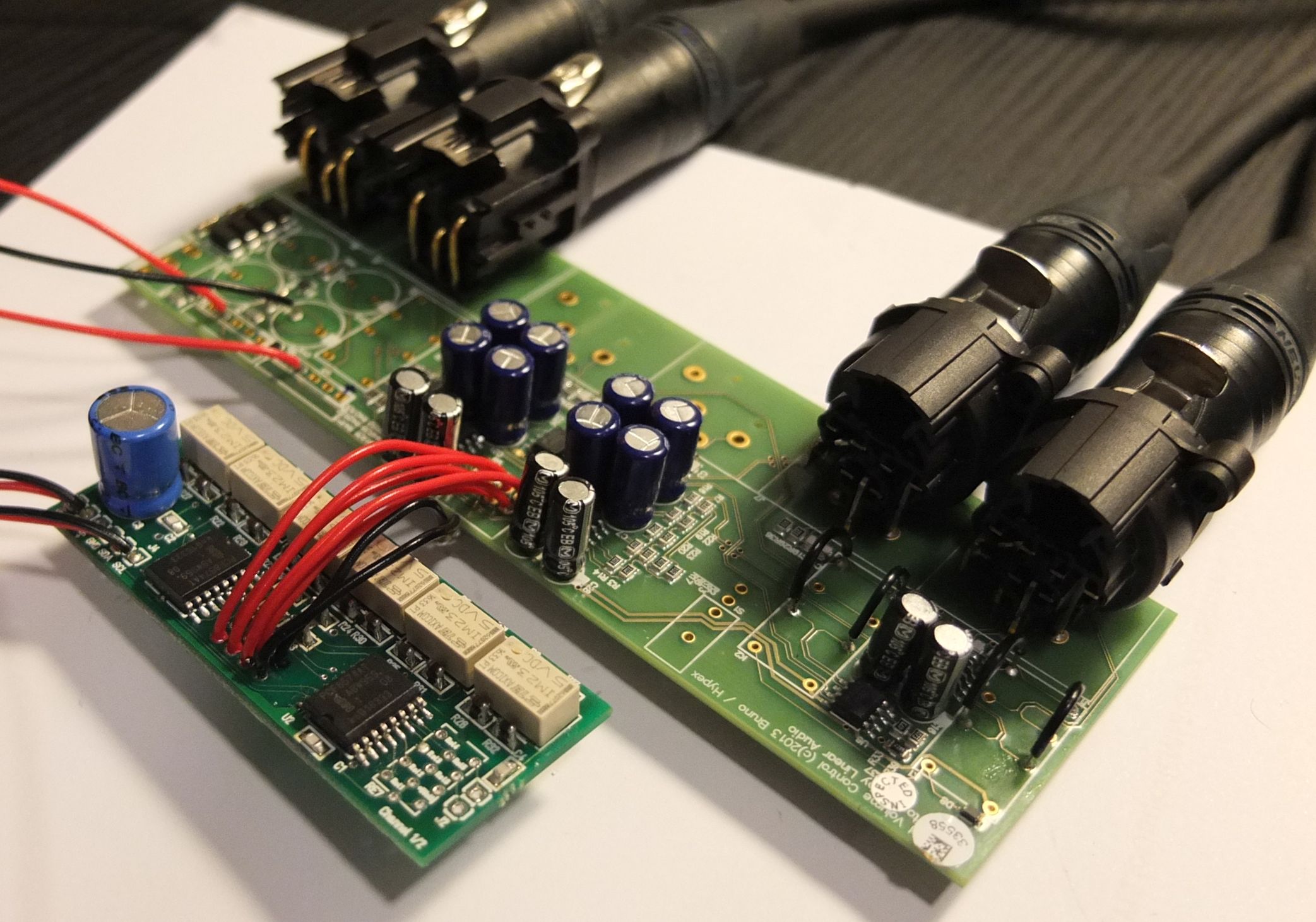

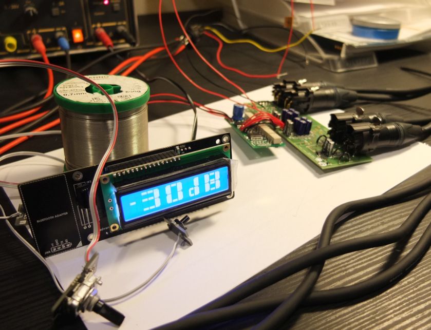

Thanks to some days off work I've finally got around to building the BPBP with Hans VolCB and Maya.
The power is running off a lab supply for now. I don't even have the Hypex regulators in use. I'm waiting for Jan's Silent Switcher power modules to arrive and will try to run the whole setup off of that.
Also I plan to use only 1 input for now so no input relays either.

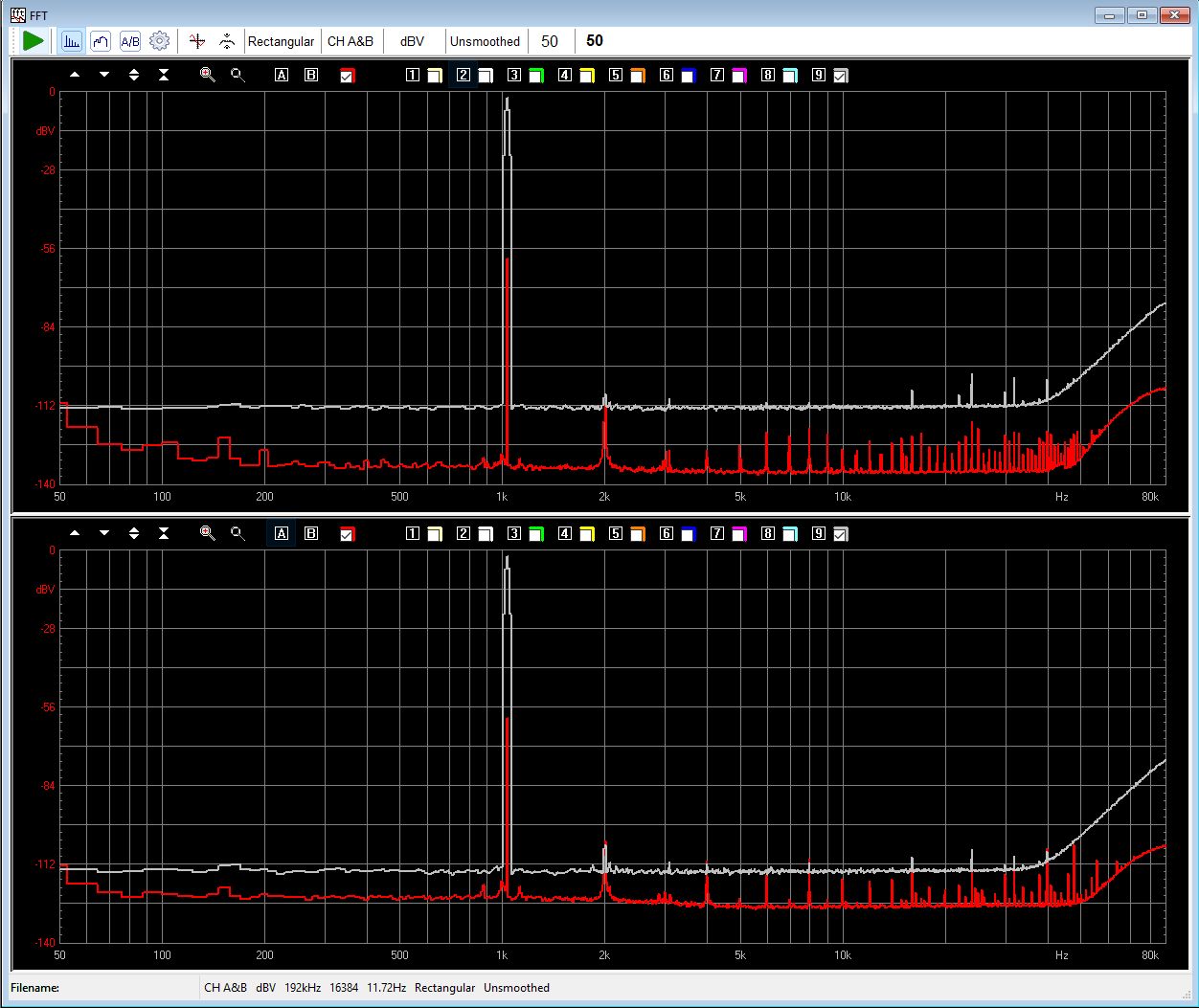

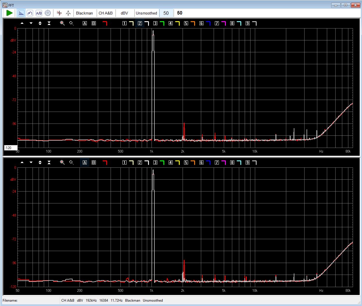

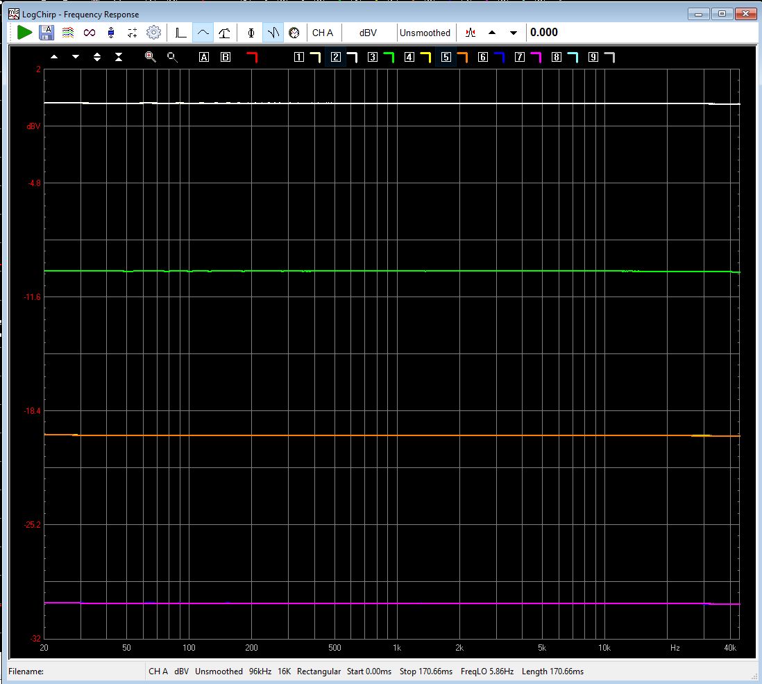

Anyhow - here are some preliminary measurements
Noisefloor in gray is the CLIO FW self noise with loopback. So clearly the measuremnt instrument limits the performance here. I'll repeat this with NTi FX100 once I get back to work... that should do better.
The plots are
0dBV sine going in -> vol set to 0dB
0dBV sine going in -> vol set to -60dB
and then sine sweeps with 0, -10, -20, -30 and there are two lines for each - left and right channel. The tracking is so good that one can hardly tell there are two measurement on top of eachother.
So bench results are superb as expected already.
