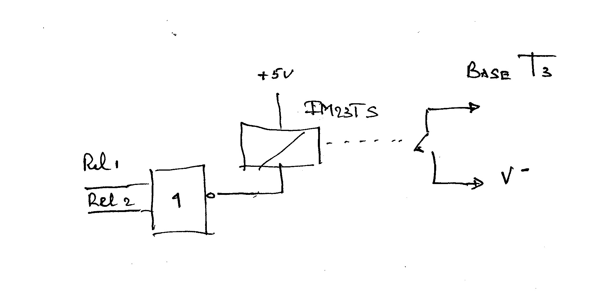

Yes but the mute function needs sorting out for the 2 input board
That is outside the scope of the Maya Controller.
There is however relay K3 on the BPBP that can short circuit the output.
With just 2 channels you can use this relay to get a mute function, simply by pulling the base of T3 to V- with a switch.
A more complex solution is to connect an NOR port to channel 1 and 2 of the PCF channel selection chip and let this port steer a relay that shorts the base of T3 to V-.
In that case the Maya Mute works also for the 2 channel version of the BPBP.
Hans
