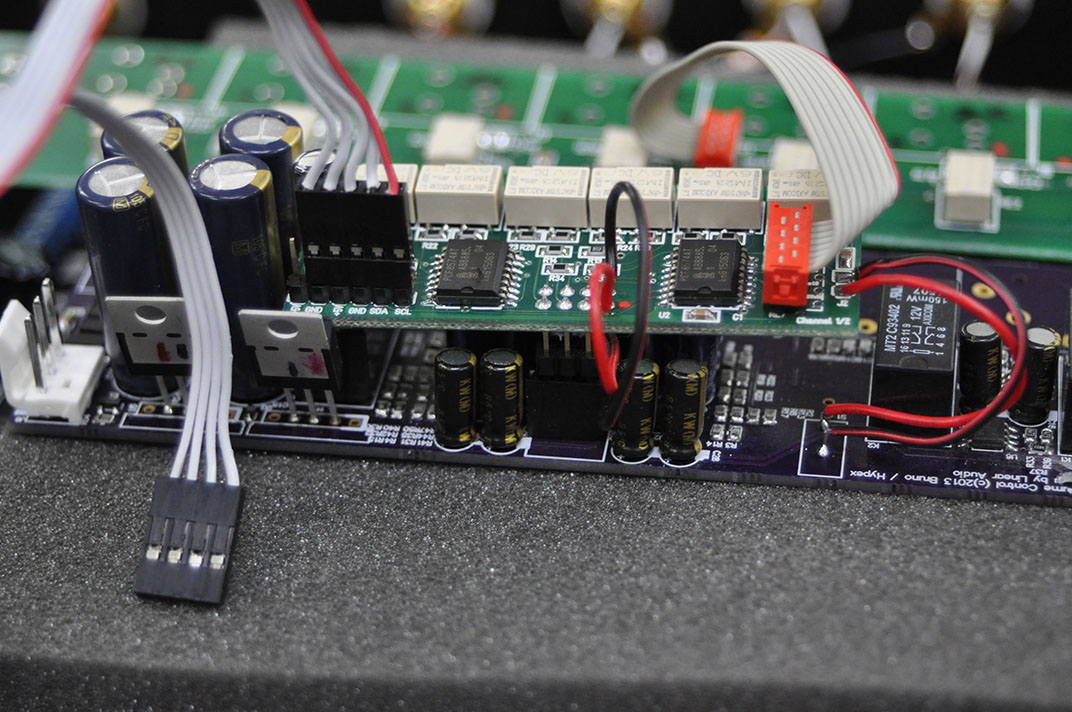

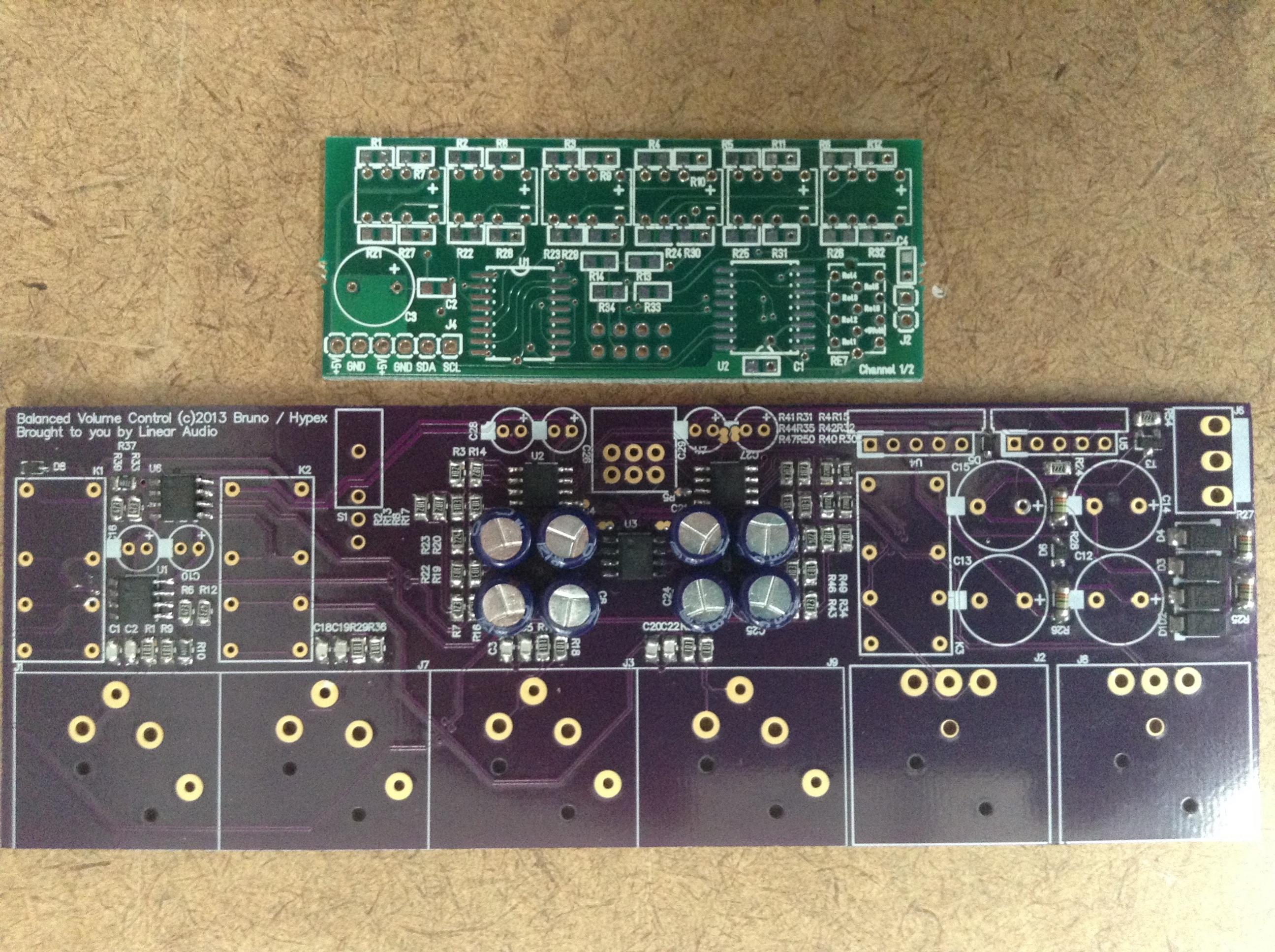

I received today the VolCB from Tibi. My first thought is " How am I going to mount this pcb? There are no mounting holes and not even space to drill. Hans, how did you do it?
I am talking about the VolCB board
In Posting #60 there is a dropbox link.
In the BOM for the VolCB there is some comment below, telling that you can place the VolCB on top of the BPBP through a 2x3 pin header and connector, or alternatively use solid wires and solder both PCB's to these wires.
Even firmer is to use a 2x3 Board to Board connector with pins that are long enough. Farnell has a huge assortiment to select from.
The way to connect both PCB's can be seen on the illustration, also provided in the dropbox link.
I have used an angled board to board connector, so the VolCB is standing upright before the BPBP.
The VolCB board is as light as a feather, so when connected correctly to the BPBP, it does not need extra support in normal use.

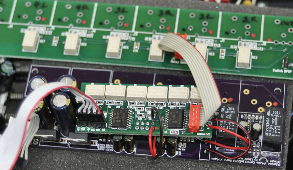

After assembling the VolCB and 4 input boards I hooked them up to my existing Maya controller. When power was applied to the Maya the display remained blank except for a blinking cursor at the left. After about 5 seconds I noticed a wisp of smoke and quickly cut power.
Hans, Please take a look at the attached pictures. This was how things were hooked up. Do you see anything improper. I am reluctant to try this again.

Hi Mike,
There are two things that I can see that are wrong.
1) On the VolCB U1 is mounted the wrong way because it is 180 degrees turned, this is a serious error.
2) The two wires leaving the right bottom corner from the VolCB should have been connected instead to J13/Switch BPBP from the 4 input select board. This is a harmless error, but will have to be corrected.
So you will have to renew U1 and connect J13, and hopefully everything will work.
Hans

I don't quite understand #2. Should the switch wires go from VolCB to the 4 input board? or from BPBP to the 4 input board? The input selection relay on the BPBP needs to be switched, right?
When using the VolCB only, the wires go as you have routed them now, and a relay on the same spot as where you have placed the header from the flat cable will do its job in selecting one of both inputs.
But when using a 4 input select board, switching of the relay on the BPBP board is effectuated from J13 on the 4 input select board.
The two connections on the VolCB in your case are connected to nothing, what you can see when looking at the PCB layout.
Hope you can remove U1 without damaging the PCB.
Succes and feel free when you have further questions to ask.
Hans
OK, I understand. Wires go from J13 on the 4 input board to the BPBP.
I have removed and replaced U1 (using Chipquick) and all seems to be working. No signals are hooked up yet but I hear relays clicking for volume and input selection.
