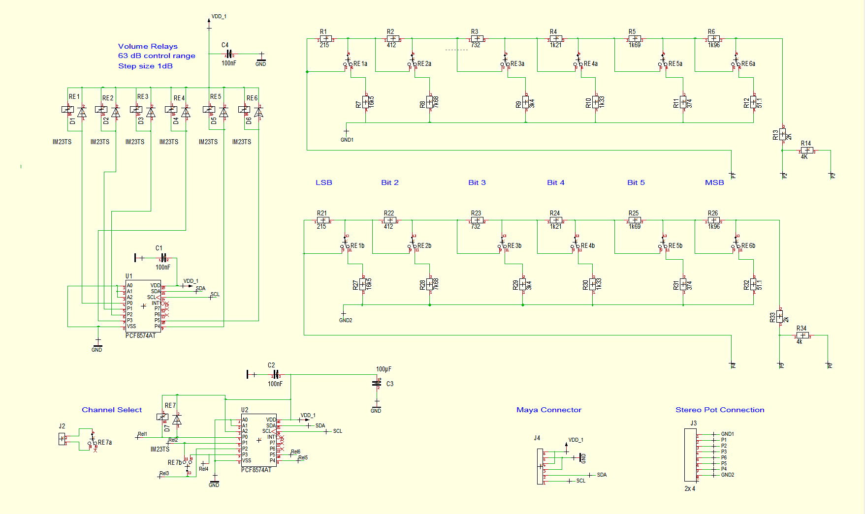

The VolCB has 6 outputs, so yes, your board can be controlled by Maya, but only when 5 Volt relays are used, since the I2C chip on the VolCB cannot handle 12 Volt.

You are right, a Hex Inverter + ULN2003 can perfectly do the job.
Looking at the cost factor, it might be an alternative to replace the 12V relays by 5 V versions, in that case without interface board.
The circuit diagram of the VolCB is here.
There is either the possibility to just use the 2 inputs on the BPBP, or to steer up to 6 external relays.
When only using the two BPBP inputs, relay 7 should be mounted to replace switch S1 on the BPBP.
For external inputs, the signals Rel1 to Rel6 are to be used and Relay 7 should be discarded.
Hans

Hi Enrico,Hi Hans,
Thanks for the schematic. It's clear now
Thinking about the cost, the price of 12 relays G6K-2F-5DC at mouser is 4,06 USD each = 48.72 USD plus shipping.
If I consider just myself you are right but I need to take in consideration the people that joined my GB and have already the 6 input board in the hands. The 12 relays are SMD and many are not able to do the change by themselves.
The 2 ICs plus connectors and caps are more or less 6/7USD. If there is interest the cost of the PCB will be much less than the cost of 12 relays.
Best Regards,
Enrico

That why I have includes a circuit diagram.
View attachment Schematic MAYA 3.2.pdf
As you can see, a Maya board supports 4 SE stereo channels, and 2 Maya boards support either 8 SE stereo channels or 4 Balanced channels.
A VolCB has no inputs or outputs and is not controlled by a Maya stereo board, but by a MAYA CPU controller. A VolCB only controls a BPBP, which depending on the configuration can switch between 2, 4 or 6 channels.
Here a copy of your question to Tibi
Here again, each Maya board supports 4 different stereo SE inputs and 2 Maya boards support 4 balanced stereo inputs.So does it mean that maya would support 4 different inputs for each maya board.
And the same applies to Hanns VoICB boards as well.
If used with 3x VoICB boards we can have 6x balanced channels and 4x inputs with 6x bala ced channels each?
That DOES NOT apply to the VolCB as well, because one has absolutely nothing to do with the other.
When using 3x VolCB boards in parallel, you can have 3 balanced stereo inputs playing at the same time, with 2, 4 or 6 triple stereo inputs to select from, depending on configuration.
Hans
