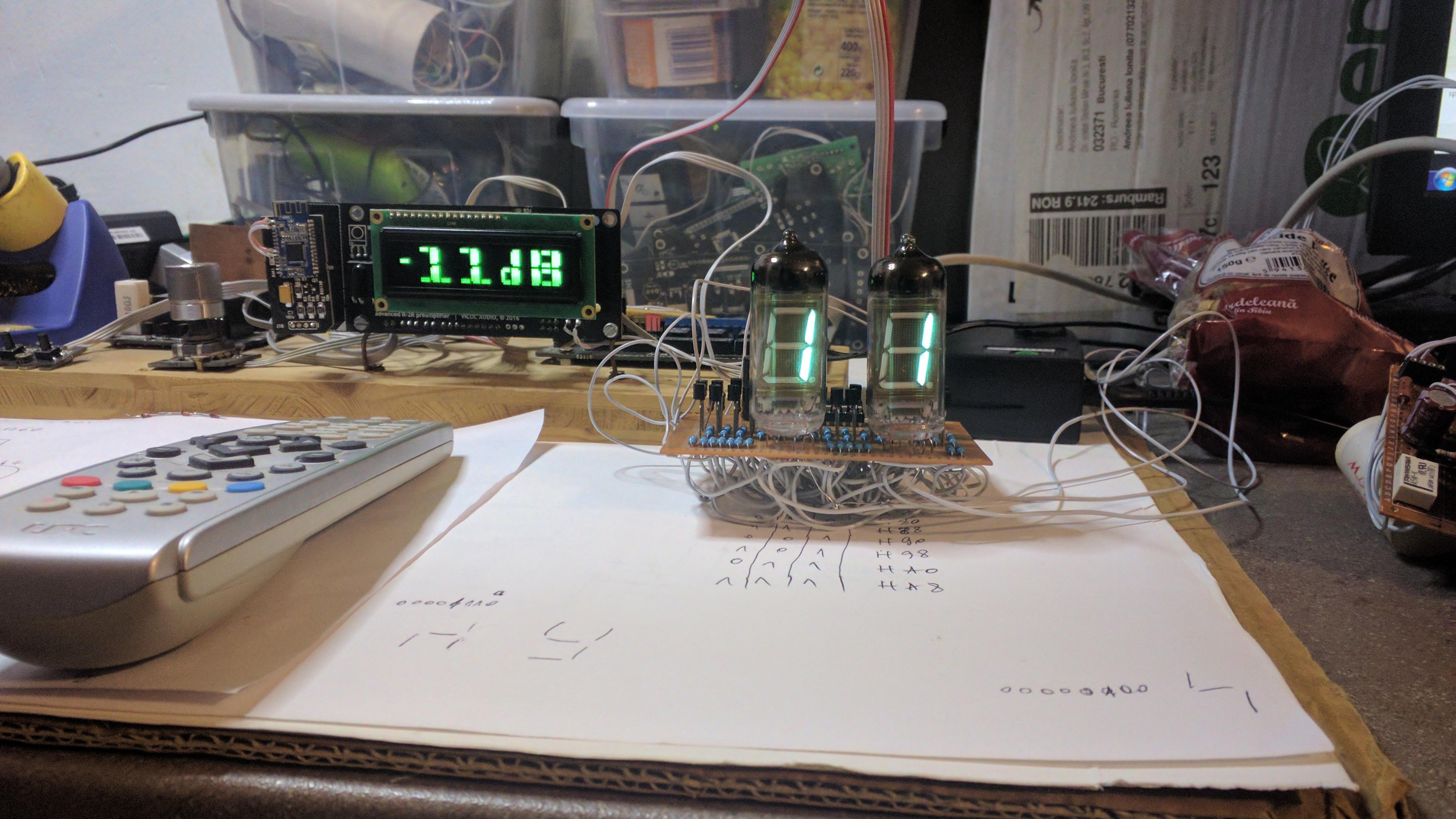

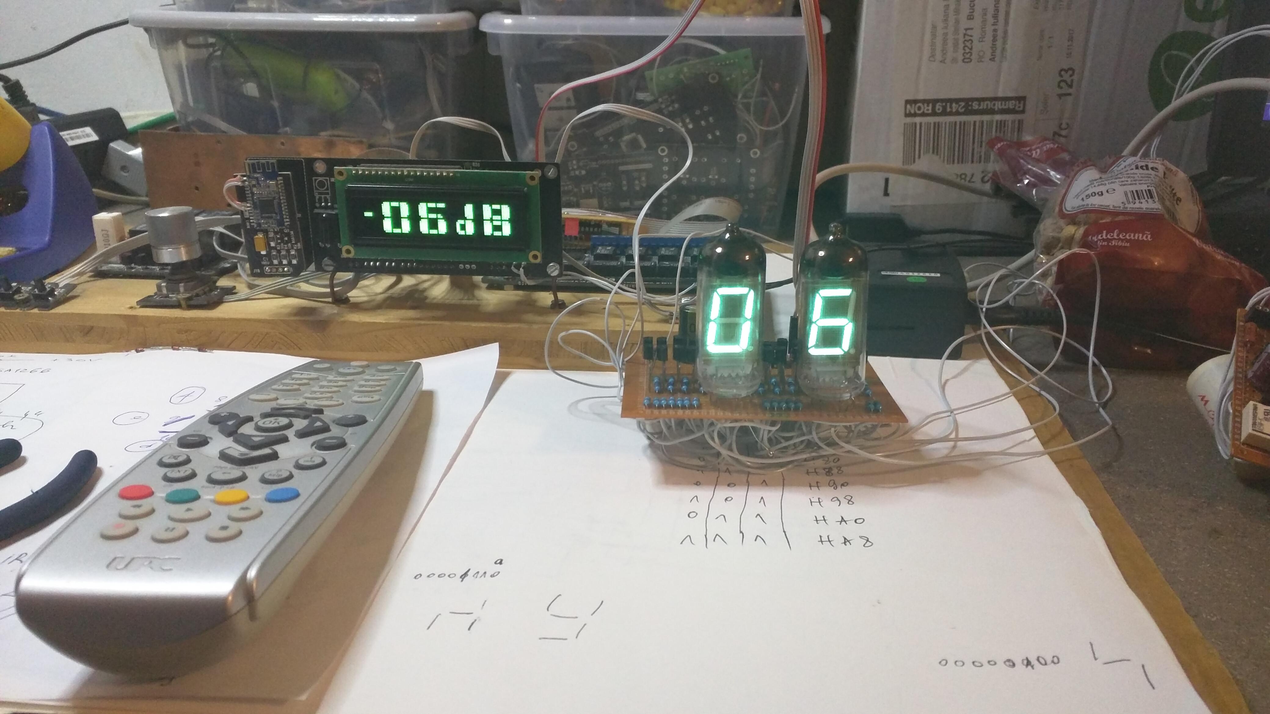

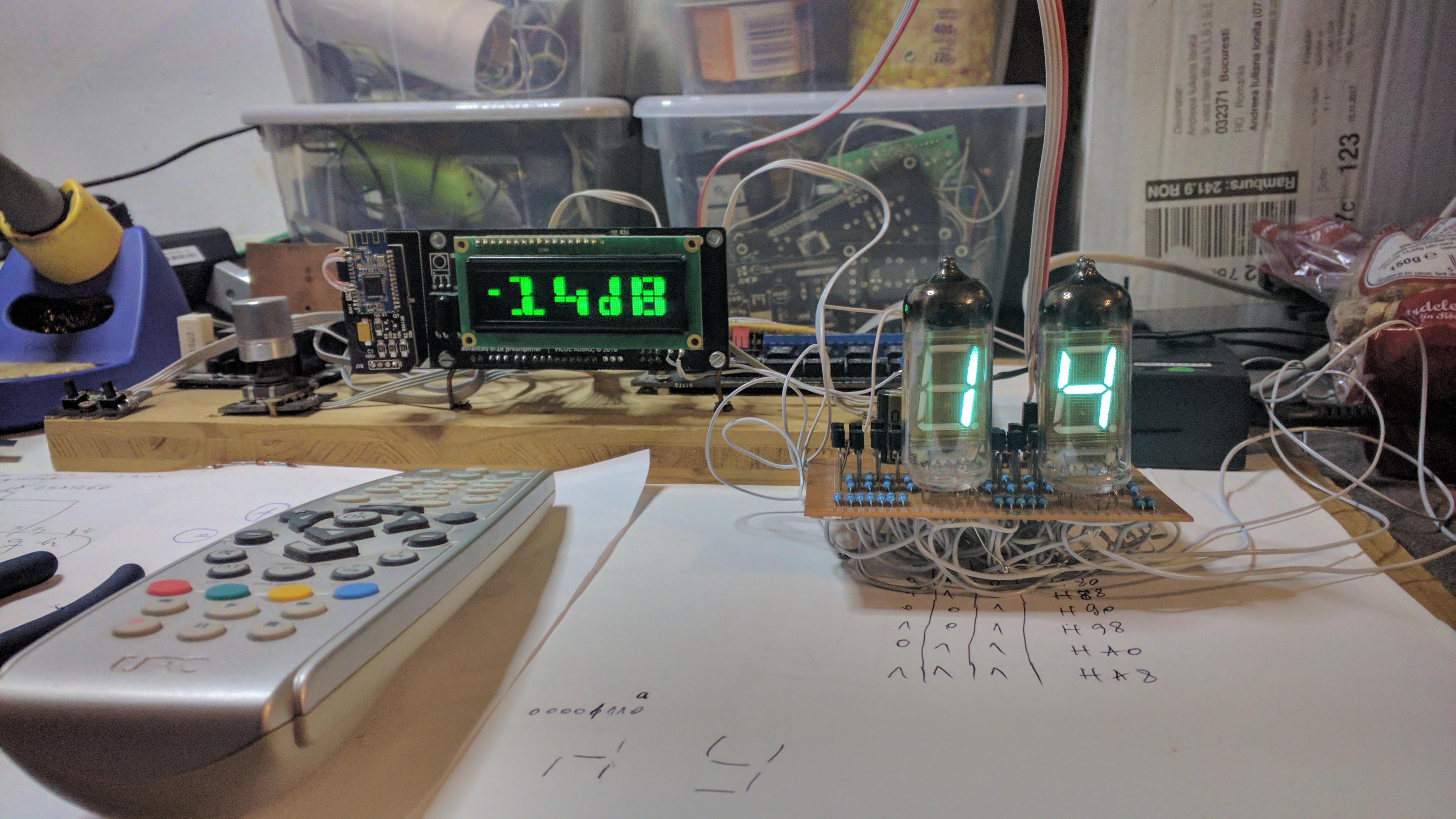

Some interesting module with VFD that work with Maya using Russian tube IV-11 as display :

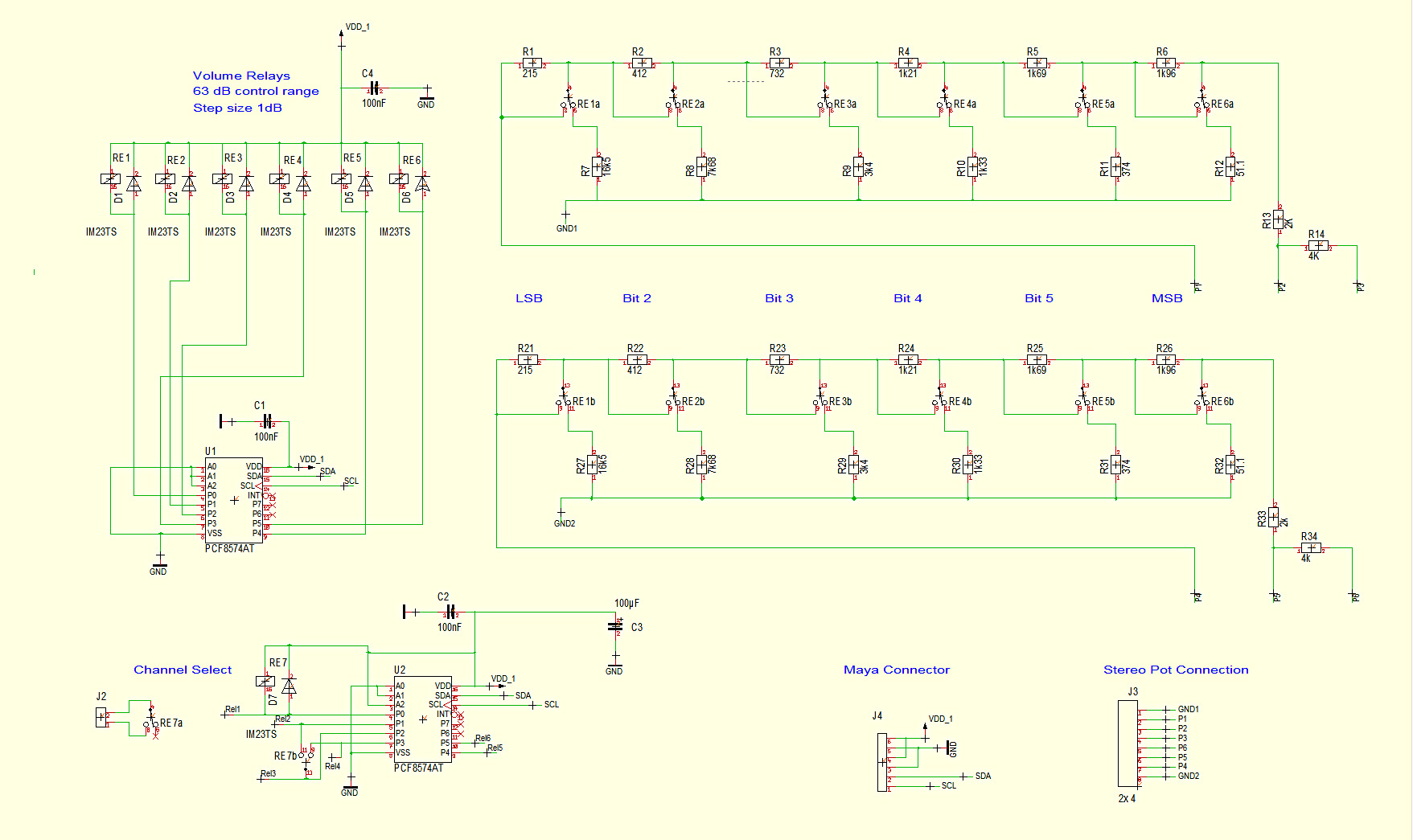

From the schematic (attached) my understanding is that RE7 is driven by the PCF8574AT, just like the other relais. I presume that they are all the same voltage?
The BOM is correct.
RE7 should be a GCK-2P, also a 5V relay with a different footprint.
The problem seems to be that the IM23TS will only be available as from febr 2020.
You could use the IM03TS instead, but that relay consumes more current.
Because of that the PCF8574AT has to be replaced by a PCA8574D (not the AD !) which ca supply 400mA instead of 200mA.
