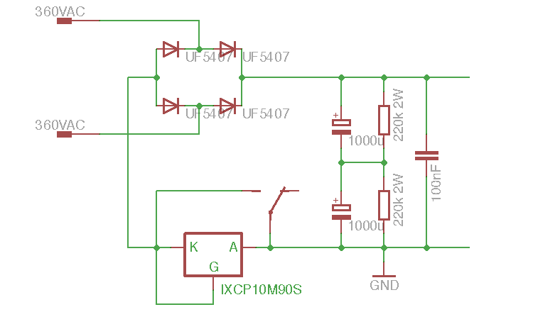

Here's my "final (and best)" solution.
[1] lose the 22K resistor in the 500 B+ leg.
[2] insert a 2-terminal high voltage 100 ma regulator in the ground leg.
[3] give it a mid size heat sink to soak up the joules
[4] wire it to a bypass relay which can be switched in when the caps are topped up.
This does ALL these things:
* minimizes time-to-charge
* ... at safely limited current flow
* is simple to implement
* doesn't expose the relay to persistent high voltage
* is cheap
The 100 ma CC regulator will charge the caps in 5 seconds to 500 volts. This can NOT be shorted any further without increasing the current flow. If "100 ma" is safe, then this is definitionally safe. The current regulator will still need to dissipate those 125 joules though, in 5 seconds. That's an average of 25 watts. Heat sink!
Further, since the regulator is in the ground-side leg, it can produce a low-voltage (through 2-resistor voltage divider) signal to run to a comparator, to drive the relay. i.e. "when delta-V across regulator drops below 10 volts... engage relay".
You get the best of all the design ideas - fastest charging, (actually "near-constant charge time!"), easy implementation, trivial bypass (so the current regulator doesn't get in the way of the operating point of the amplifier). Moreover, one might choose to use the same switching signal to drive an additional high-voltage side reed relay to engage the B+ to the amplifier's tube finals.
This gives a nice A/B operating point: "A" is "disconnect finals, charge capacitors" and "B" is "bypass safety/charge-limiting capacitor charging circuitry, and engage amplifier finals". Worth considering!
GoatGuy
With the risk of sounding like a complete noob, I don't really understand what you mean with number [2], the two terminal regulator.
This haa developed into a VERY informative thread!
At [mouser.com] look for: IXCP10M90S
It has 3 terminals (the 2 terminal reference was a typo), but can be "treated" as a 2 terminal device, once the control lead is connected to the Gate is hooked to the Kathode via a suitably spec'd resistor. (When no resistor is used, it self-limits to 100 ma)
Very nice devices. Often used in "very modern" circuits for constant-current plate loads. Tolerates such high voltage (900V) that they are basically "universal parts" for the tube-loving forum. Let's hope the manufacturer never stops manufacturing them!
GoatGuy
That's awesome. Seems like best of both worlds (beats the hell out of a thermistor IMO) and definitely worth an experiment.
To be clear, is the attached schematic what you suggest??
Yep. Though you know you actually only have 500uF of net capacitance there... Capacitors in SERIES are like resistors in PARALLEL (same equation C = (C1 C2)/(C1 + C2)). And the converse: when capacitors are hooked parallel, the capacitance simply adds (C = C1+C2). Have fun! Don't forget the *******' heat sink for the amazing constant-current regulator. Otherwise, it shall fry.

Yes, cool you noticed the reduction 😎. It was 1000uF in total, but after some redesigning (slightly lower HT) and new measurments, I decided I could do with half as well. Saves room and money.
Unless the capacitors are fully charged I'd think it'll work. Otherwise, I still think the contacts will stick. It doesn't take much to exceed 3A. It'll be interesting to see how this turns out. That's still an impressive reed relay.
I think you meant "If the..." ... unless doesn't quite work! Nice thing about using the current-source is that you'd be able to sense when its across voltage had dropped to a constant trigger value indicating fullness.
