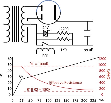

This i the PERFECT example of where to use a reed switch. The glass-ampule sealed ones are just the ticket - with the right clearance, they can withstand thousands of volts ... relative to their surrounding coil, and when asked to short-out the inrush resistor, they can handle the few dozen DIFFERENTIAL volts across it just fine. Opening, or closing. They are however, with rare exception, NOT good at switching many hundreds of DC or AC volts. And they're tiny. And not very expensive. And PCBoard mountable. And low drive current. Really quite nice!
Of course, another of the many options is to think out of the box here ... and put the "inrush limit resistor" in the ground-side of the power supply (since current doesn't know in the slightest where the resistor is in a current-loop), and, given its low voltage potential (ground +/- a few volts) ... then you could just use a conventional low-voltage PCboard type relay. Or a front-panel switch for that matter. Why not? Indeed... a front panel slow-start switch.
Or again, thinking outside the box, get rid of the inrush-current limit resistor, and replace it with the most time-proven device to do a better job: the choke. Resistors, after all, are just "chokes on the cheap". And since you obviously aren't being "cheap" here (7 amps of heaters and 1000 uF of 530 volt capacitance!) ... why bother with the inrush resistor at all? Just go for the golden part: 1H to 10H chokes. Their series resistance can be 1/10th to 1/100th that of your "inrush resistor", but their reactance makes them great at keeping the ampere flow steady and happy. Makes for nice on your rectifier chain.
Or, heck ... do both! Inrush resistor on the ground-side, chokes on the hot side, little R-C timer for the inrush bypass, front panel defeat and a nice red-green pair of complimentary LEDs on the front panel to indicate whether the bypass is engaged or defeated.
And, just to be a bit perfectionist in this ... there are these things called "constant current circuits", my friend. Say your B+ is supposed to be humming along (nominally) at 250 ma (at 500V). Putting a 1000 ma current-source in place of the resistor has a huge benefit, of course in that it changes its dynamic 'resistance' (actually impedance) to match the current flow. When the demand is high, it acts as a current-source. When the demand drops below the limit, its impedance drops (and thus it 'cuts itself out of the circuit').

See my comment just above yours. The "relative voltage problem" is easily handled both by a zener diode and reed relay, AND moving the whole thing to the ground-side (to get rid of the relatively high voltage).
Assumed that the current limiting resistor fails someday, a tiny reed switch will give an impressive arc lamp upon trying to switch 500+ volts with that much capacitance behind it. As a bonus, it will probably explode violently and send glass shards into the surrounding circuitry.

The use of the Zener protects the relay, but negates the point of soft-start...See my comment just above yours. The "relative voltage problem" is easily handled both by a zener diode and reed relay, AND moving the whole thing to the ground-side (to get rid of the relatively high voltage).

Maybe not...
See:
See:

Except at initial power on. The voltage across the resistor is full voltage...They are never going to arc because the resistor is keeping the voltage to a low value.
Still the same problem... Full voltage at initial power up. The Zener won't clamp the contact voltage that way.See:

IMPOSSIBLE. Reference Ohms Law. Or if in doubt read Kirchoffs laws.Except at initial power on. The voltage across the resistor is full voltage...
IMPOSSIBLE Reference a simple RC circuit:IMPOSSIBLE. Reference Ohms Law.
Vs = Vr + Vcap
Setting Vcap to 0 at initial powerup:
Vs = Vr + 0
Vs = Vr
If Vcap = 0, then Vr must be the full supply voltage. Since the relay is across R, the full supply voltage is initially present. It falls to zero exponentially.
