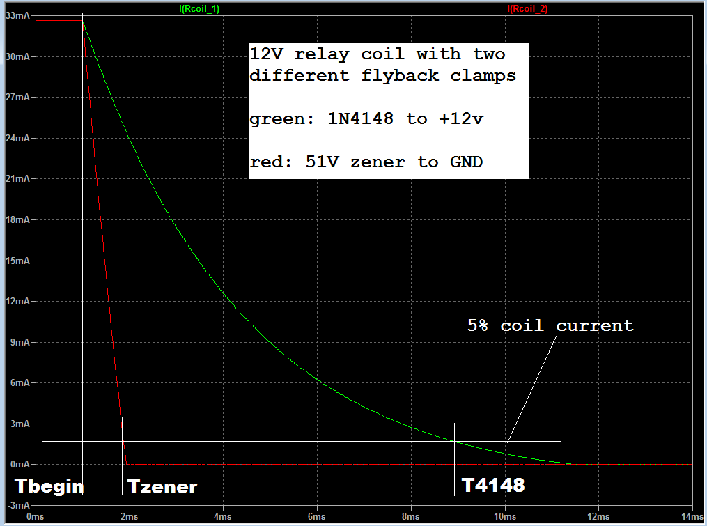

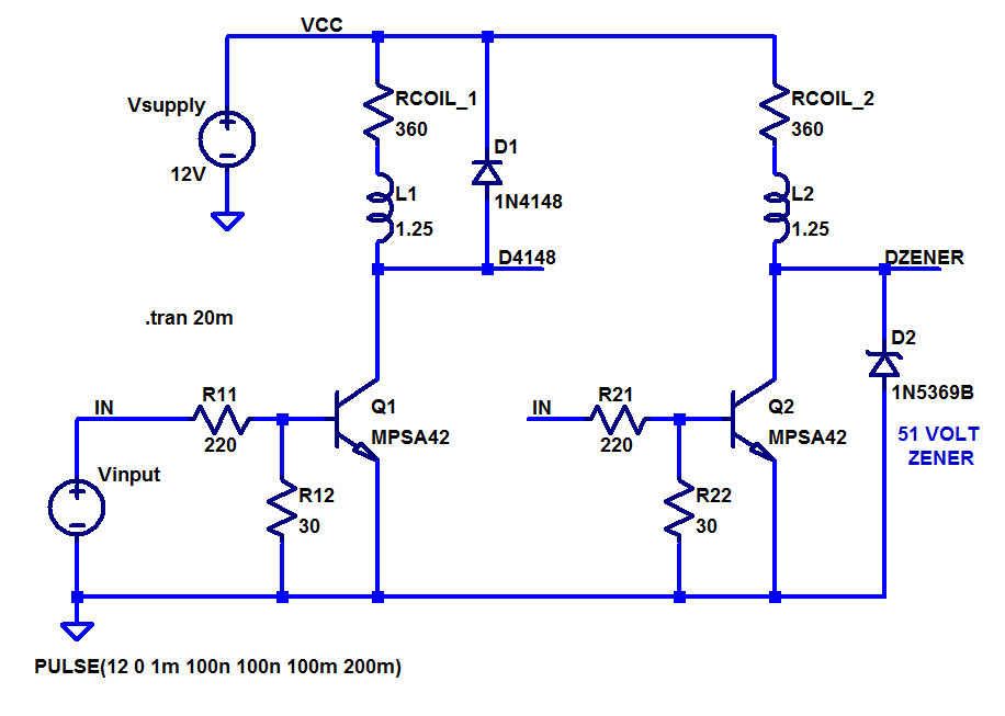

The good news is, you can get most of the available speedup, with a modest zener clamp set to about 4X the supply (thus the coil has Vsupply on one end and 4*Vsupply on the other ... 3*Vsupply across the coil). In this case, a 12V supply and a 51V zener. I don't think anybody has any fear uncertainty and doubt about harming a 12V relay with a 51V flyback pulse.
And I'll bet that member wrenchone's resistor "clamp" (post 32) would give equal speedup with a resistor ratio just a little higher than 4:1, but I haven't fiddled with that option.
Here's the standard diode-across-the-coil arrangement, and the zener-to-ground alternative, side by side. I've plotted the coil current vs time, and drawn a line at the 5% threshold. Relay datasheets generally say the relay is guaranteed to release the armature when coil current falls below 5% of (Vrated/Rcoil). Some say 10% but most say 5%.

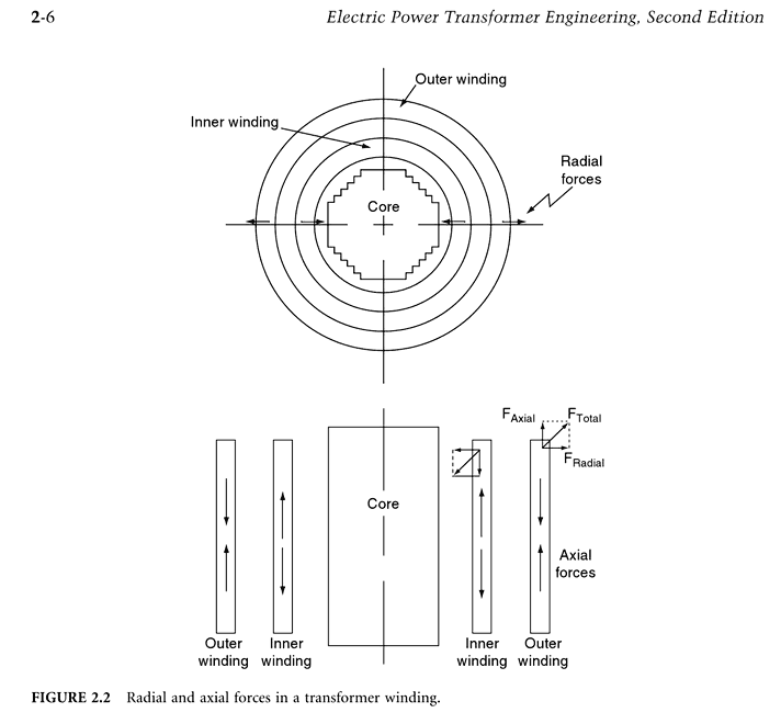

Outwards. With an iron cored coil the coil forces are small compared with the forces between pieces of iron as only a small proportion of flux is outside the iron core.
Lines of flux act like elastic strings that repel one-another. Energy density in a field is proportional to the square of flux density, so spreading out field lines reduces density lowering energy, and shortening lines reduces the total volume of field, again reducing energy.
