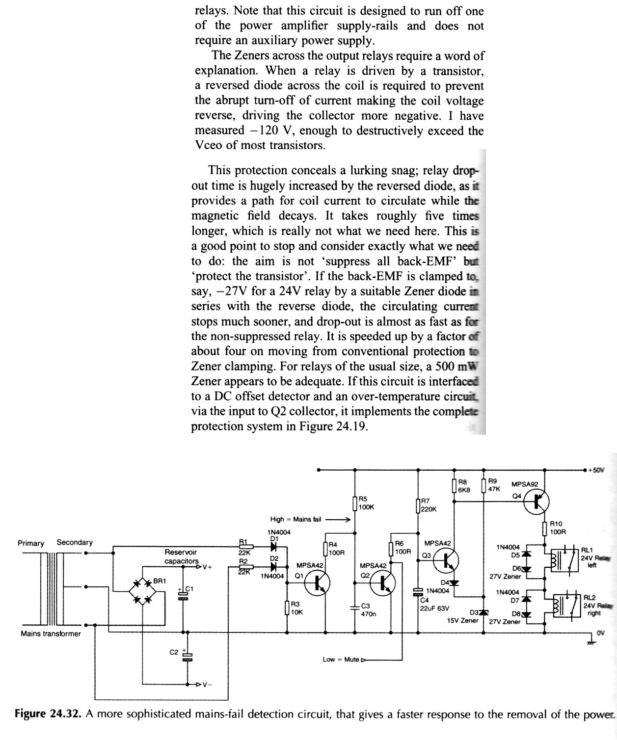

A zener diode to ground requires only one extra component. If the transistor's Absolute Maximum Rating for collector-to-emitter voltage is "V" volts, select a Zener voltage which is less than 80% of V volts. For example if the transistor is a BD139 rated for 80 volts, choose a 1N5264B zener diode rated for 60V ±5%.
This topic is covered in Douglas Self's book Audio Power Amplifier Design, 6th edition, excerpt below

It might be even simpler to specify a 300V transistor; this approach requires zero extra components.
A normal 1N4148 diode in series with a zener diode requires two extra components.

I had noticed the relay is quieter when it drops out compared to when it turns on. I have updated my next version pcb's to use a 1n4004 and a 12 volt Zener.
That should help the relays last a bit longer.
Using a 300V transistor switching a relay coil without a clamp sounds like a lousy way to select transistors for avalanche capability, something one might be able to get away with occasionally on a hobby basis, but not in a production environment. Dropping an oscilloscope probe across the transistor during the switching event might be eye-opening indeed.
The diode plus resistor approach sounds cost-effective - you do need some extra back emf to make the field collapse quicker in the relay coil and make the contacts let go in a timely manner.
If you don't care about some extra current though the transistor while the relay is on, it seems like you could get away with just a simple shunt resistor across the relay coil. At the cost of a somewhat higher voltage rating on the switching transistor, you could make the shunt resistor a significant multiple of the relay coil resistance .
The diode is the usual well proven way to protect the transistor.
