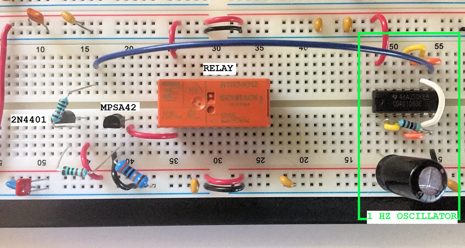

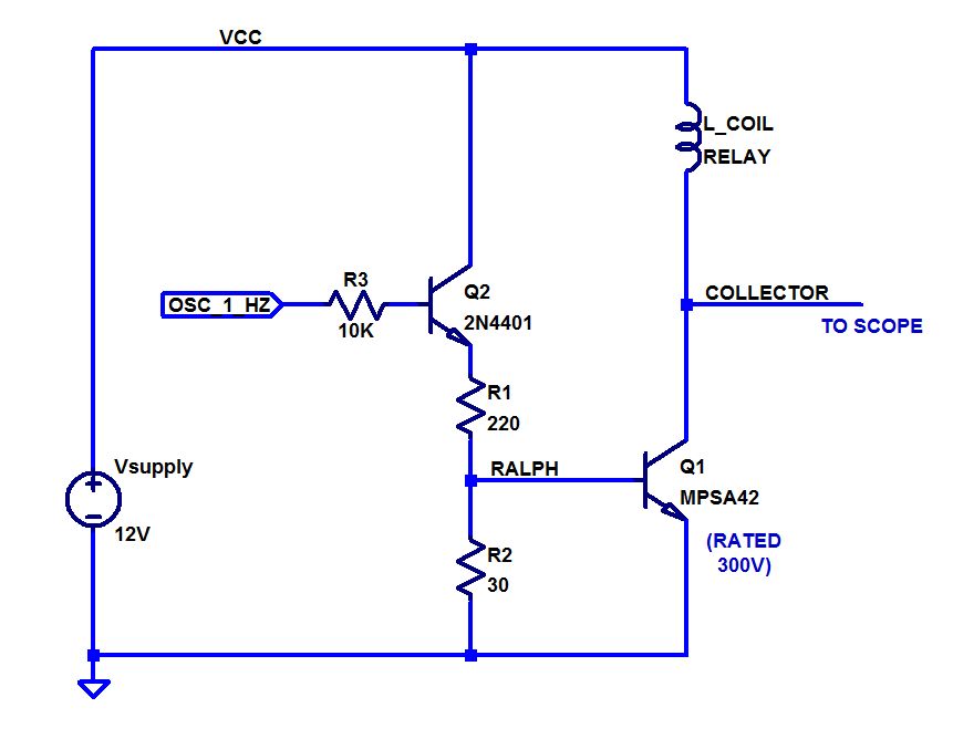

I just put together this experiment on the solderless breadboard.

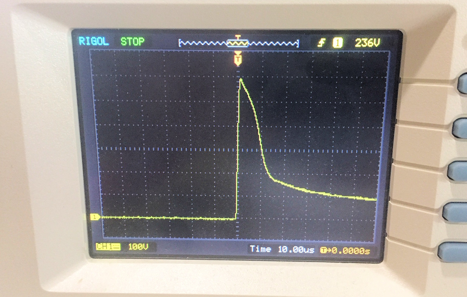

It's a 300V NPN transistor "MPSA42" driving the coil of a 12V relay (33 mA coil current) with no flyback protection whatsoever. No diode, no zener diode, no resistor, no capacitor, nothing. I monitored the collector voltage with my least expensive {most expendable} oscilloscope. Data below.
The scope (100 MHz bandwidth) says the collector shoots up to about 600 volts, and dwells in the Super Duper High Voltage realm for about 1.5 horizontal divisions on the scope, namely, about 15 microseconds. "236V" is where I told the scope to trigger, on the rising edge.
Interestingly, the "300V" transistor keeps right on working. I ran the experiment for about 100 on/off cycles of the relay, i.e., about 2 minutes, while I adjusted the instruments and snapped a photo. It was working just fine with no apparent ill effects, when I shut it off.
Resistor R2 ensures that the relay driver transistor Q1 is turned off extremely quickly; R2 sucks out the base charge of Q1 in nanoseconds. Predriver transistor Q1 buffers the input, because the 1 Hz oscillator is made of CD4000 CMOS logic gates (Schmitt trigger inverters) that are barely able to source or sink half a milliamp.

Thank you! Picture is very clear now (I don't need, but for society).
I'm shure transistor works as zener here, but only we dont know its avalanche parameters. If we take higher rated voltage transistor - peak voltage could be even higher.

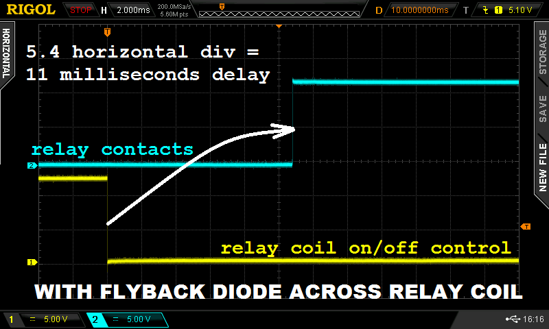

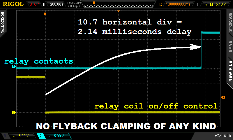

Joined 2011
Using the experimental setup in post #28 I measured the turnoff times (a) with, and (b) without, a standard flyback diode (1N4148) across the relay coil.
It shuts off about 5X slower with the diode than without. At least for this relay.
The yellow waveform is "OSC_1_HZ", the rail-to-rail signal produced by the CMOS oscillator circuit.
_
