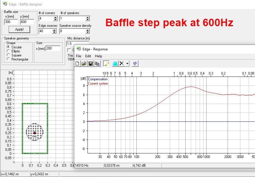

Here is Edge sim of 300x600mm baffle with "ideal" woofer effective width 200mm (resp WO24) BS peak is at 600Hz

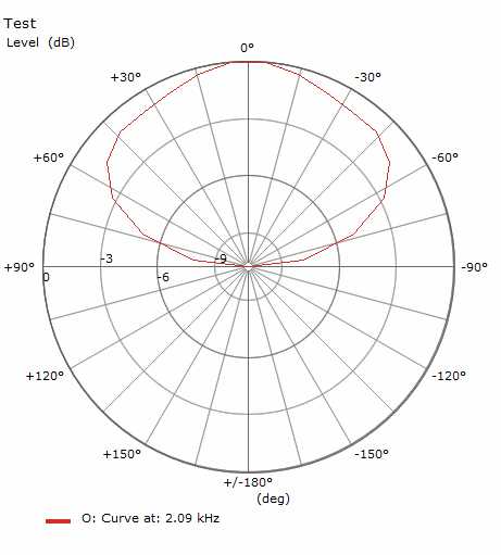

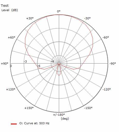

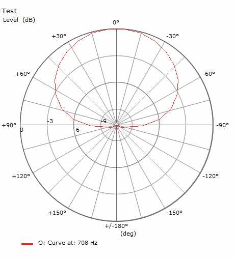

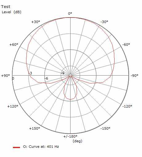

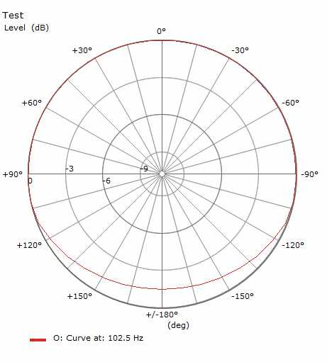

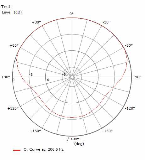

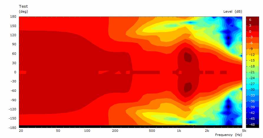

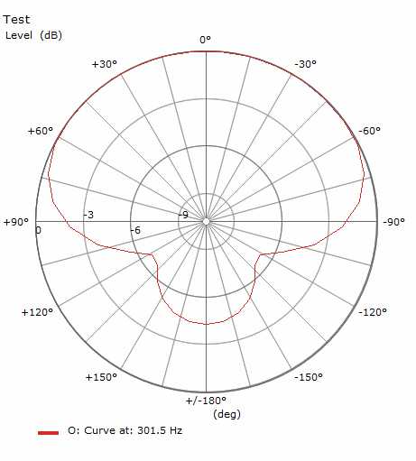

Here is a simple AKABAK BEM sim to show the attenuation around the speaker vs freq. The driver axis is at 0deg and will always be 0dB (normalized) in the polar coordinate plots to allow seeing the relative attenuation that occurs around this speaker (on 3m circle).
A more accurate prediction requires the actual box dimensions, rounding, and driver size and location.

What is the baffle step frequency of that simulation?Here is a simple AKABAK BEM sim to show the attenuation around the speaker vs freq. The driver axis is at 0deg and will always be 0dB (normalized) in the polar coordinate plots to allow seeing the relative attenuation that occurs around this speaker (on 3m circle).

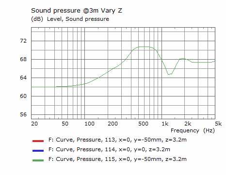

I don't view the radiation transition from 4Pi to 2Pi space as having "a" step freq. At first I was inclined to view it as a filter and look for the -3dB points but the transition slope changes depending on a number of factors, so we'll use something else. Is there a definition that you are using?
Using pic#2 (axial SPL) in my previous post, It has the 6dB transiton (4Pi to 2Pi space) as well as overshoot and undershoot caused by diffraction (lets ignore those for now). So for this example (previous post) lets say the transition ends at ~400Hz [edit - excluding the diffraction], if you wanted a single freq. to describe it.

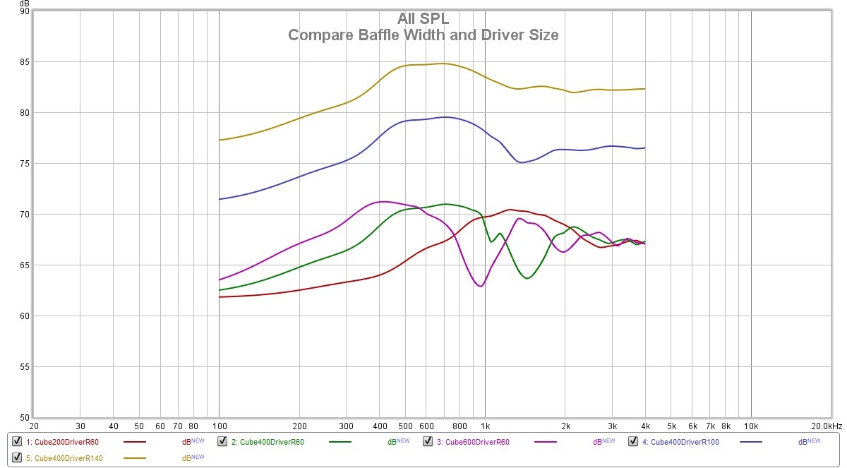

The pic below is for various combinations of driver diameters and baffle widths to show the effect.
