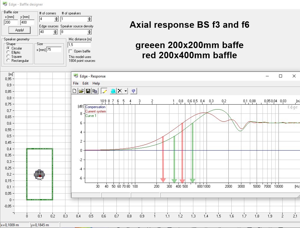

Being handicapped in maths, as well as dumb and lazy, I have found interactive simulation such as the Edge helpful. Helpful to get the idea of what is happening and how change of different parameters like baffle shape, driver location and diameter or off-axis angle make variations.
I get no value from knowing exact f3, but what happens beyond that is interesting! In modern world, 3D measurements tell exactly what is happening, but making tests of eg. driver location means lots of labor. ...been there, done that!
The value of f3 of baffle step is just a starting point for baffle step compensation. Very crude, because BS peak and null shape remains unknown. And off-axis behavior, where box depth plays a role. With dipoles, a cone driver means much more surprises!

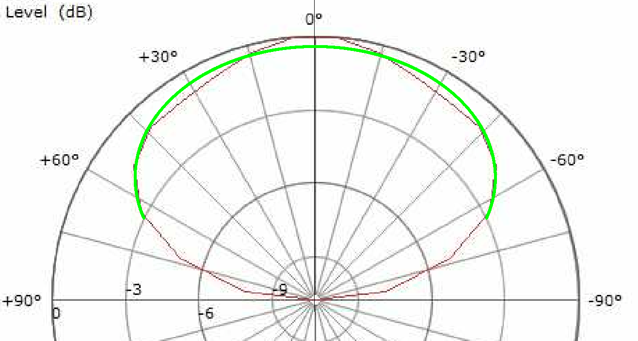

No, what I am saying is that possibly my post #16 in this thread is the answer to my own question. The question was, what is the sound pressure level directly behind the speaker relative to that directly in front of the speaker at the baffle step frequency? If the speaker system is closed- box by means of a sphere, then I think that the solution that I arrive at might be correct. But as I said, my understanding of acoustics is limited and I'm not the best at math either. Some checking that I have done seems to indicate that it holds water.
How do explain the effect when the speaker is EQ'd flat on axis 20-20Khz and there is still a changing SPL at the rear of the speaker ?
There is no conservation of SPL around the speaker. The radiation pattern is changing as shown in post#31 where the on axis is always 0dB and the relative attenuation (dBr) and radiation shape can be read off the polar coordinate plots.

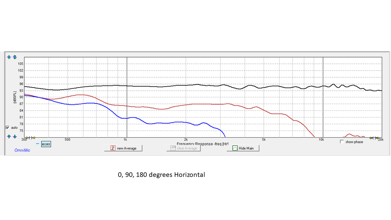

OK, so back to the question. We can look at some measurements I recently did.
My cabinet is 10" wide, so according to the equation in post #34, the baffle step frequency is 456 Hz.
Here is the quasi anechoic data at 0, 90 and 180 degrees. These were taken with an Audix TM1 mic with ARTA, using a rotating turntable.
At 450 Hz it looks like about 6 dB difference between 0 and 180, maybe a bit less?
I do not claim that this result can be universally applied to other systems, but it is one data point.

Your result is about the same as the testing of a cube each dimension of which is equal to 10.5 inches. For the cube, the baffle step frequency equals 430 Hz about equal to 390 Hz. The testing of the cube is on p.9 of the PDF file linked to at post #13, this thread.

The simulation of your post #31 is only showing SPL at angles other than 0 degrees relative to 0 dB at the angle 0 degrees. That is, throughout the simulation at any frequency, SPL at 0 degrees equals 0 dB. At 102 Hz, SPL at 180 degrees equals almost 0 dB or the same as SPL at 0 degrees. At 2 kHz, SPL at 180 degrees equals less than -9 dB relative to 0 dB at the angle 0 degrees.
All I'm saying is what you already know. Some of the energy is diverted modally and it's not a matter of giving a simple number. A box doesn't spread the energy in a smooth manner.
Here I wanted to show the potential of the 0 degree axis to become uncertain in such an environment. Depending on the situation is it often more appropriate not to normalise.
Murphy's f3 presents the frequency where spl difference is 3dB - it is halfway in dB to full baffle step/loss! The problem is angle and shape of the curve, it may take 3-5 octaves to develop to full 6dB. The rearside dispersion varies even more based on many factors, particularly at higher frequencies than f3 of BS.
This is why spl at 180 deg at f3 is useless info as such (IMO). I still don't get what is the point of knowing (theoretical) 180deg spl loss (singularly). Seems like everybody else than OP share this confusion.
Here is Edge sim of how axial response varies with baffle height, while smallest dimension remains the same 200mm. Murphy's formula for f3 doesn't work....
