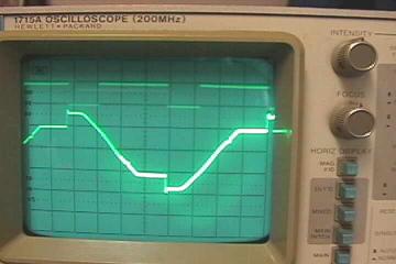

Top trace is mosfet gate. 10V / div. The source is connected to the caps which were at 20V during this test. Output current was about 2A. It was running with a 200W series bulb on the AC. The other trace is the AC off the transformer at 20V /div. That's all for now. I need to draw some schematics.
Darrell Harmon
Darrell Harmon
regulated etc

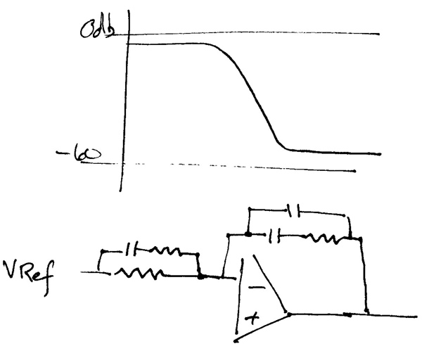

Thanks, I have been trying similar things, but haven't had the right capacitor values. I will get some more caps and try again. The voltage section is working fine. All I need to do is get the current limit to work right and it will be finished. I also think my grounding could be improved.

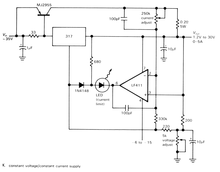

I've attached the schematic of the design I used a while back - it's originally from the national semiconductor LM317 datasheet, reproduced in The Art of Electronics - well if it's in THE book, it must be good 🙂
I added a few more pass transistors, and connected the voltage control resistor via a small regulated negative supply, so the output could go down to 0v.
It worked reasonably (apart from current limiting - unfortunately the main point I chose this design), but has been gathering dust for a while since I had access to some new Thurlby-Thandar power supplies. I've now decided to rebuild it as a different design with pre-regulator.
As for the magic smoke:
The end result: On connection of a low resistance load, one-by-one the transistors reached secondary breakdown, shorted, then blew their bonding wires like fuses!
Yes - They were quite happy, connected to each transistor. The problem was I mixed out my pinouts and had wired them to the transistor collectors rather than emittersdid you remember to put the 0.1 ohm resistors in
