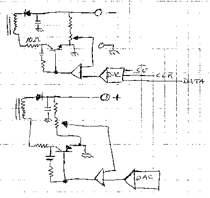

Darrell Harmon
Darrell Harmon
dlharmon said:[snip]They are both going to be N channel because I couldn't find a P channel with a high current rating. This will complicate the electronics some.
Darrell Harmon
Actually, Darrell, it's making it easier. Only one board layout, just 2 copies. Two identical supplies, connected at the common "ground" point.😉

for a tracking supply/P Channel FETs
you have one reference for the "+" side, the reference for the "-" side is derived from a simple voltage divider on the output of the "+" side. <em>Ergo hoc</em> any change in the "+" voltage will become the new reference for the "-" side.
P-Channel HEXFET's -- there are some high power devices -- you can parallel devices but make sure to read International Rectifier's application note on this -- in one "negative" supply I built I just used an NPN transistor in the ground return -- I've already posted the schematic. -- I use a BU208a -- of which I have plenty if you need them.
Reference
True but after thinking I suddenly quite like the idea of being able to parallell connect my supplies for double the current. It seems I will stick with that...
/UrSv
/UrSv

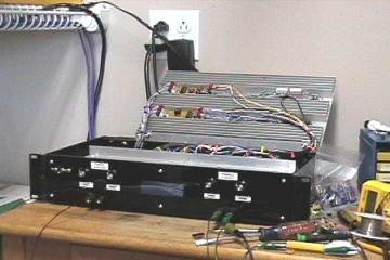

Starting next Thursday I will not be able to post for about a month due to really slow intenet access at home, but I will have plenty of time to finish and test my power supply since I will not be having deal with all this college stuff. (I am majoring in EE, but its stuff like Differential Equations and Phyics that consume my time)

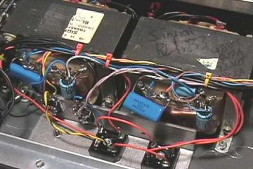

One comment on why I am doing things the way I am doing them: I am using 48VCT transformers since I got them cheap. I want 30V 10A, so I am using the CT as ground. It is not worth new transformers for seperate supplies. I got mine for $10 each 500VA EI.
I did my front panel last weekend. It is plexiglass painted black on the rear except for the LCD and control labels which I masked before I painted it. It worked great. I hope to post pictures sometime. It has a LCD in the center with a pair of binding posts and a voltage and current control above them to the sides of the LCD. On the left side there are switches for soft power (set to 0V all outs) current tracking and voltage tracking. The real power switch is on the rear by the power inlet.
I am using amp MTA connectors for all of the low current internal wiring. They work nicely. I have a spool of 500feet of old cable containing 6 22awg stranded twisted pairs. I am using the pairs to wire everthing low current. The control board had about 40 wires connected to it, but with the connectors and bundling it looks good. The high current things are soldered. I am using a tiny screwdriver as a punchdown tool. It is slow but it doesn't cost $200. (If you try this don't hold the connector with your fingers. Use a vise. I slipped once and the scredriver went through the skin on the side of my finger and out about 1/4 inch below. I was less painful that what I would have expected, but I don't recommend it.)
I am not planning on using the output boards I posted earlier. I just got them to fill some empty space on a pcb order earlier and changed my mind about the design. I will use perfboard for these and maybe later do pcb's if I have spare space again. I am using the control board pcb though.
I hope to have this beast working next time I post. If you have any questions I will be checking email.
Darrell Harmon

Re: for a tracking supply/P Channel FETs
This is the obvious way of doing it, but I am not sure this method
is quite good as it is. Do we really want to (attempt to) track
every spike and deviation on the positive output? I think not.
I have been thinking about an improvement (?) to this method.
We use a voltage divider between positive and negative output,
as you suggest, but low pass filter this signal. Then we use
a voltage divider between negative output and ground, in the
usual way for non-tracking supplies, but high-pass filter this
signal. Then we add the two signals into an error signal.
Remains to choose a crossover frequency. It should be lower
than the bandwidth of the negative output control loop, at least.
Perhaps we want to choose it even lower.
