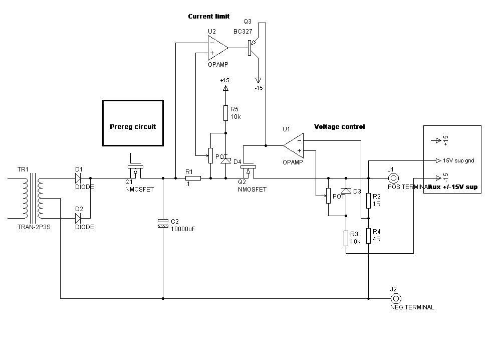

This is how my bench supply looks (except that the prereg is a phase-controlled thyristor thing).
The floating +/-15V supply is a simple PCB-transformer 100mA with a couple of 3-terminal regulators.
Of course, the full schematic has more parts, but this is it conceptually.
Jan Didden
Jan Didden
Thanks Jan,
Looks somewhat like what I had in mind except that I was looking at the stepped input voltage which is crude but would maybe work fine.
Thanks again,
UrSv
Thanks again,
UrSv

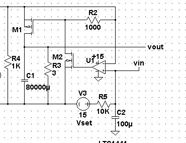

The top wire is rectified ac. The bottom wire is ground. (I'm to lazy to reboot to windows to add labels.) R1 is necessary to pull down the voltage off the bridge so the comparator can sense it. (at least in spice - it wouldn't start up without it.) C1 is of course the main filter cap. M1 is the switch, and M2 is to make it possible to switch with a signal referenced to ground. R5 and C2 are to cause the voltage to ramp up slowly avoiding large current flow on turn on or when the voltage is increased. The comparator turns the fet on whenever the rectifed ac voltage is less than the input. R3 is the load. Rather than attatch waveforms I will offer to email a copy of the file for LTspice. LT spice can be downloaded for free from http://www.linear.com I had to hack some models to make the parts good enough for this. LTspice has no good mosfets, so I just added a 0 to the breakdown voltage of one. It puts out 2V less than the input is set with a 10A load and 80000uF, and with no load it puts out the set voltage.
It seems like combining this with janneman's schematic would result in a good psu. It needs some changes such as possibly putting M2's source at a negative voltage so it would work at low voltage settings. It also needs some zeners and resistors of something like that to not blow the gates out of the fets. One other thought would be a gate driver or an optoisolator rather than the second fet. I know I have seen optoisolated gate drivers (a lot of photodiodes in series). I may just use a darlington PNP in my design rather than the fet because things would be simpler.
This is a very rough version of what I want to do. I will probably test some hardware this weekend since I don't trust spice too well.
Darrell Harmon
Darrell Harmon
dlharmon said:[snip]
The comparator turns the fet on whenever the rectifed ac voltage is less than the input. (1)
[snip]
It needs some changes such as possibly putting M2's source at a negative voltage so it would work at low voltage settings (2)
[snip]
Darrell Harmon
Darrell,
(1) is a good idea. I had this synchronised to the mains, but your method will work well. the next thing of course is when to switch the fet OFF , when the cap voltage is well above the output voltage, taking into account that the cap must be able to provide the output current until next charge cycle. you can be quite creative here.
(2) you start to discover the reasons why I went to a floating supply...
Jan Didden
janneman said:
Darrell,
Jan Didden
1. I am planning to use an opamp to add about 5V to the desired regulated output voltage for the input to the prereg. (ripple at 10A was about 2 volts).
2. Yes a floating supply is a great way to do it, but I already have a huge 48VCT transformer and want to have dual supplies using it. It will be semi complex but it should work. It also has some other windings that I can use to provide floating supplies if necessary.
Darrell Harmon
