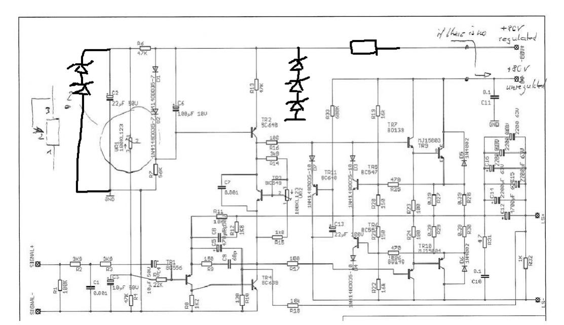

For my Project I Need a 80v regulated Supply. I have a double rail +80V/0V PSU.
I'm only a mechanical engineer and Need a prinicipal Sketch how it Looks like ...
See also here: http://www.diyaudio.com/forums/solid-state/214899-diy-project-nytech-cpa602-today-3.html#post3096379
Thanks for your help ...

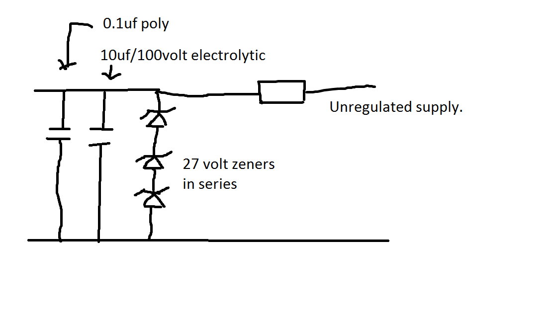

Looking at your other thread I'm assuming the 80 volts regulated is at very low current ?
If so a simple zener regulator is ideal (3 series connected 27 volts zeners) fed via a resistor. A small cap is placed across the three zeners to maintain a low impedance clean supply. The resistor value is calculated by knowing the voltage feeding the chain (which has to be higher than 80 volts) and the max current the regulator has to supply.

You can use an LM317 with GREAT CARE. The max In-Out voltage is only 40V.
The zener chain as suggested above will do the job in this case.
Like this. Resistor is calculated with ohms law to allow a few millamps to flow in the zeners.
eg, 100 volt unregulated. R=V/I so R=(100-81)/0.01 which is 1900 ohms. Use 1800 ohms as preferred value.
So that allows 10ma to flow in the zeners. The load (the amp) draws from that 10ma. If the load were 5ma then the zener current would reduce to 5ma with the above values. Always allow at least around 5 ma to flow in the zeners at all times.

The zener type shunt regulator takes some beating with its low output impedance. I think they will give the cleanest possible supply.

Hi Mooly,
thanks for your tips. My idea is, not to change the the schematic of the 602 in the first step. I want to setup a PSU with a regulated and an unregulated +80V supply.
I'll use 120VA Toroids with 58V / 0V. This will result in 83.5V ...... Each chanel will get one Toroid. The PSU-Board I will prepare is a dual rail design.
Even if it is a little bit small, there is enough place for some Zener and 2 small caps.
Have a look: http://www.diyaudio.com/forums/solid-state/214899-diy-project-nytech-cpa602-today.html#post3093309
What is your proposal for the rectifier diodes? The idea was to use good old 1N5404 ..... or better MUR XXX?

We'll try it with the original configuration and see what will happen ....
I'll post the schematic of the PSU later this night .....
Please see the updated schematic for the PSU with regulated and unregulated +80V Rail ....
Please give me your comments ....
Basically OK but the concern over headroom for the regulated supply remains.
The maths says that 58 volt AC will give 82 volts DC (and we haven't considered rectifier losses in that). In practice a 58 volt tranny may give nearer 60 or 65 volts when lightly loaded. What happens when heavily loaded ? It also should work reliably under all possible mains voltage tolerances.
A couple of options...
You could lower the regulated supply to say 75 volts or even a little lower. Although that would slightly lower the maximum output swing it would have little impact in practice.
Another option is to use a simple voltage doubler to generate a high voltage rail and then zener regulate that to 80 volts. Two caps and two diodes are the only extra parts.
The resistor feeding the LED may be to low. High brightness LED's only need a milliamp or less.
