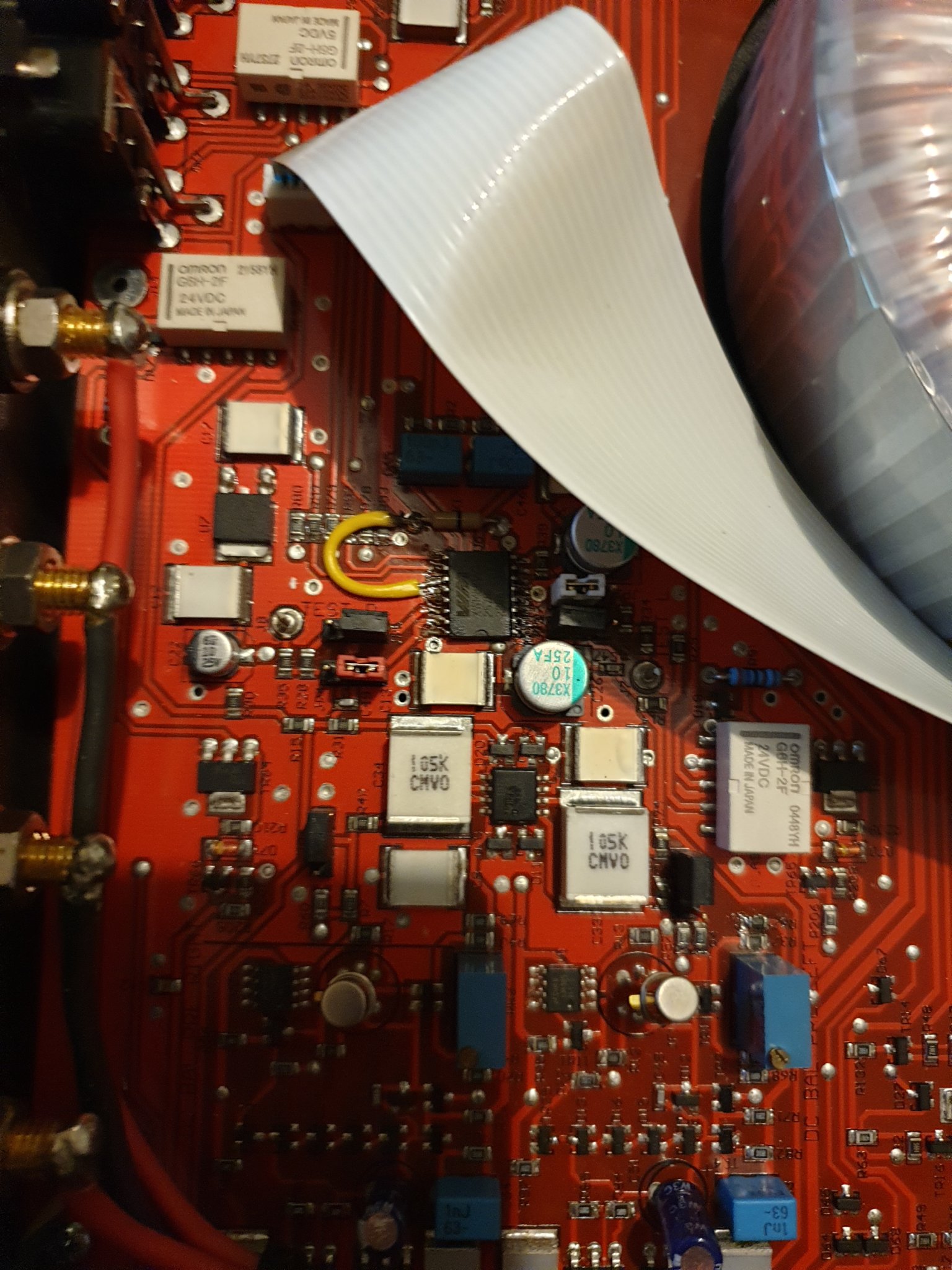

Hello everyone,
I replaced the XWM8816G. the amplitude works perfectly!
the outputs are symmetrical (I do not find the pb of gain).
unfortunately a pad was damaged...
so I made a bridge.
maybe the iron was too hot (375°c) or the tip too thick... it's sad.

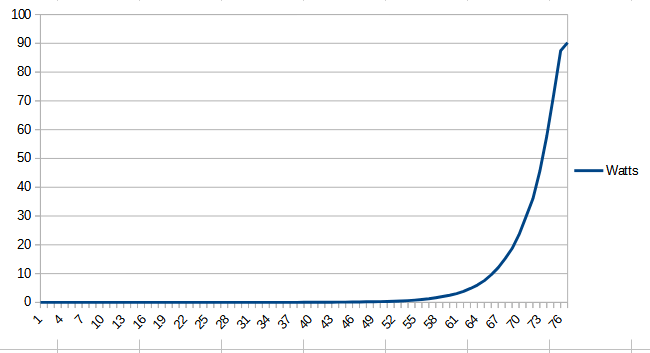

I'm coming back here after a few months. The amplifier works but I think it has a problem.
Maybe I'm wrong, but I think the preamplifier gain setting is no longer good. The power is available only very late.
There is 80 positions on the volume encoder. Each position allows an increment of 1dB.
With an 8 ohm load, the first output watt is obtained at 57 stops of the volume encoder
I plotted the curve of the output power as a function of the position of the encoder.

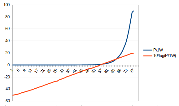

The detail of my calculation is as follows :
position 57 -> output = 8V peak to peak -> Ueff = 2.82V -> P = 1W -> dB = 10*log(1) = 0dB

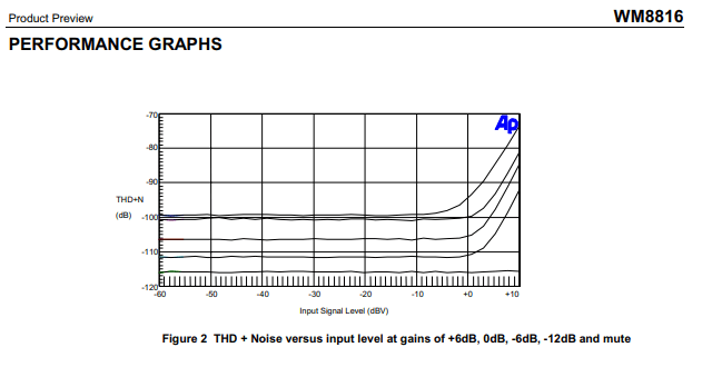

In the datasheet of the XWM8816G i I've found this.
